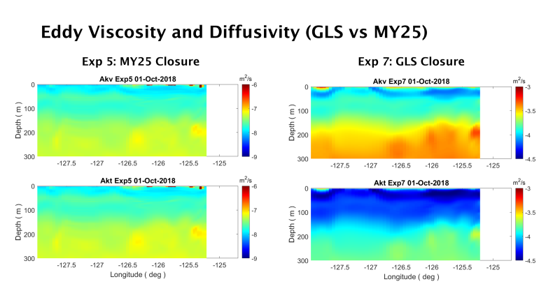

Here is a follow-up on Parker's questions. While inspecting the vertical eddy viscosity and diffusivity computed by turbulence closures in ROMS, I found that the results were different by several orders of magnitudes between GLS and Mellow-Yamada Level 2.5 in an idealized simulation of the circulation off the Washington Coast. I have attached a plot showing the comparison along a zonal transect at 47 deg N. Note Akv and Akt are plotted on log scales, so the range of the colorbar is 10^-9 to 10^-6 m^2/s for MY25 (left) and 10^-4.5 to 10^-3 m^2/s for GLS (right). It seems that one of the two closures must be problematic. I then came across this paper (Robertson and Dong, 2019, "An evaluation of the performance of vertical mixing parameterizations for tidal mixing in the Regional Ocean Modeling System (ROMS)"). The authors found that the eddy viscosity and diffusivity computed using GLS were so large that they suspected there was a coding error. I am curious to know if this issue with GLS_mixing has been solved in a more recent release of ROMS. Thanks!

Their Figure 1 shows vertical diffusivity ~ 1e-5. So that agrees with your figure 7 for GLS.
I am not an expert but i think MY25 showing AKV at 1e-8 is rather small.
That is less than the background value we use.
Maybe i am misunderstanding those plots?
In summary, I do not see / experience any issues with GLS.

Thanks for the detailed explanation, John. To answer your question about the small viscosity and diffusivity computed using MY25, there is no surface or tidal forcing in my idealized simulations. The dynamics are driven by the lateral boundary conditions constructed from daily averaged output of a global reanalysis product (GLORYS12V1). I think the lack of surface or tidal forcing may be the reason why the MY25 viscosity and diffusivity are quite small. Note that I have also set the background values (Akv_bak, Akt_bak) to zeros.
