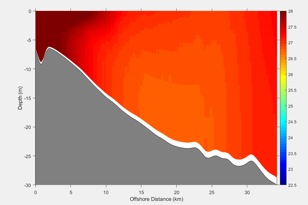

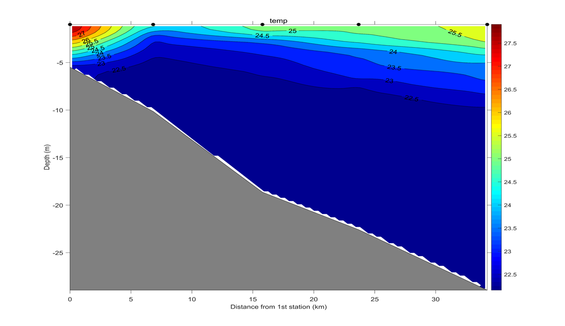

Hi.
I encountered high and abnormal bottom temperature results compared to observation data.
The surface temperature of the whole model domain is same like MODIS and HYCOM. But in my study domain, the estuary, its temperature is too high, especially at the bottom, this result is abnormal.
I've tried several advection and mixing (MY-25 and LMD) schemes, but the results didn't get any better.
And both temperature and salinity are given to the river forcing file in my model.
Thanks for your tips.
Fig 1. vertical temperature field in estuary, simulated
Fig 2. Same to Fig 1. except for observation.

Posts: 1222
Re: too high bottom temperature result in estuary
you need to look at how the temperature is evolving over time.
does it get warmer from the surface net fluxes and then mix downwards?
does it get warmer from the offshore boundary and then propagate in?
i see:
GET_3DFLD - potential temperature climatology, t = 45 15:45:04
(Rec=0000002, Index=2, File: ST_clm.nc)
(Tmin= 15.2188 Tmax= 350.0313)
(Min = 0.00000000E+00 Max = 2.66074829E+01)
GET_3DFLD - salinity climatology, t = 45 15:45:04
(Min = 3.27471674E+01 Max = 3.50000000E+01)
That Temp max look rather high (350)
and the Saltmax is large also.
#3 Unread post by wilkin »
Tmax is time.
The max value 26.6 is OK.
Consider your jerlov water type WTYPE. If it's 1 (clear ocean water) then in a shallow estuary a lot of sunlight reaches the seafloor and is trapped there because the bottom is effectively insulated. Use type 3 or 4 and absorption is more rapid keeping heating near surface.

WOW, all the tracer advection CPP options were eliminated two years ago! You are using a very old code, please update. Check the following :arrow: track ticket for details. ROMS is a living entity, still evolving and improving.

#6 Unread post by cheng_dada »
wilkin wrote: Mon Jun 13, 2022 3:58 pm Tmax is time.
Hi wilkin,
Thanks for your advice! There is a marked decline in temperature when I use type 5(Figure 1). But now there's a new problem, there has been a significant increase in temperatures in non-estuarine areas. Is there any tips to solve this problem?
Figure 1
Figure 1
Posts: 939
#7 Unread post by wilkin »
If you now have too-warm conditions at the surface where water is clearer (because heating is too surface intensified with wtype=5), then you can try a regionally varying water type. See https://www.myroms.org/projects/src/ticket/609. This must be static - not time varying.
Other users have had some success using salinity as a proxy for waters with increased absorption due to river sediment loads, or CDOM in terrestrial run-off, but that requires some hacking to the code. See the light absorption methodology in the fennel biology model for guidance if you want to go that route.
