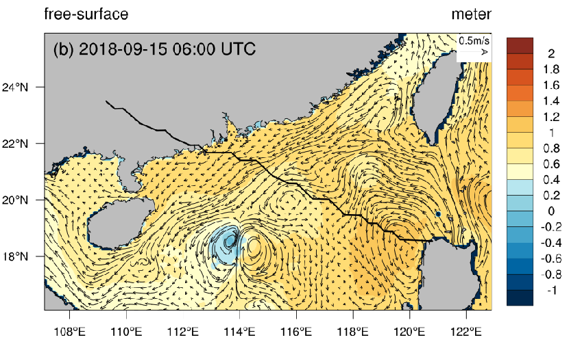

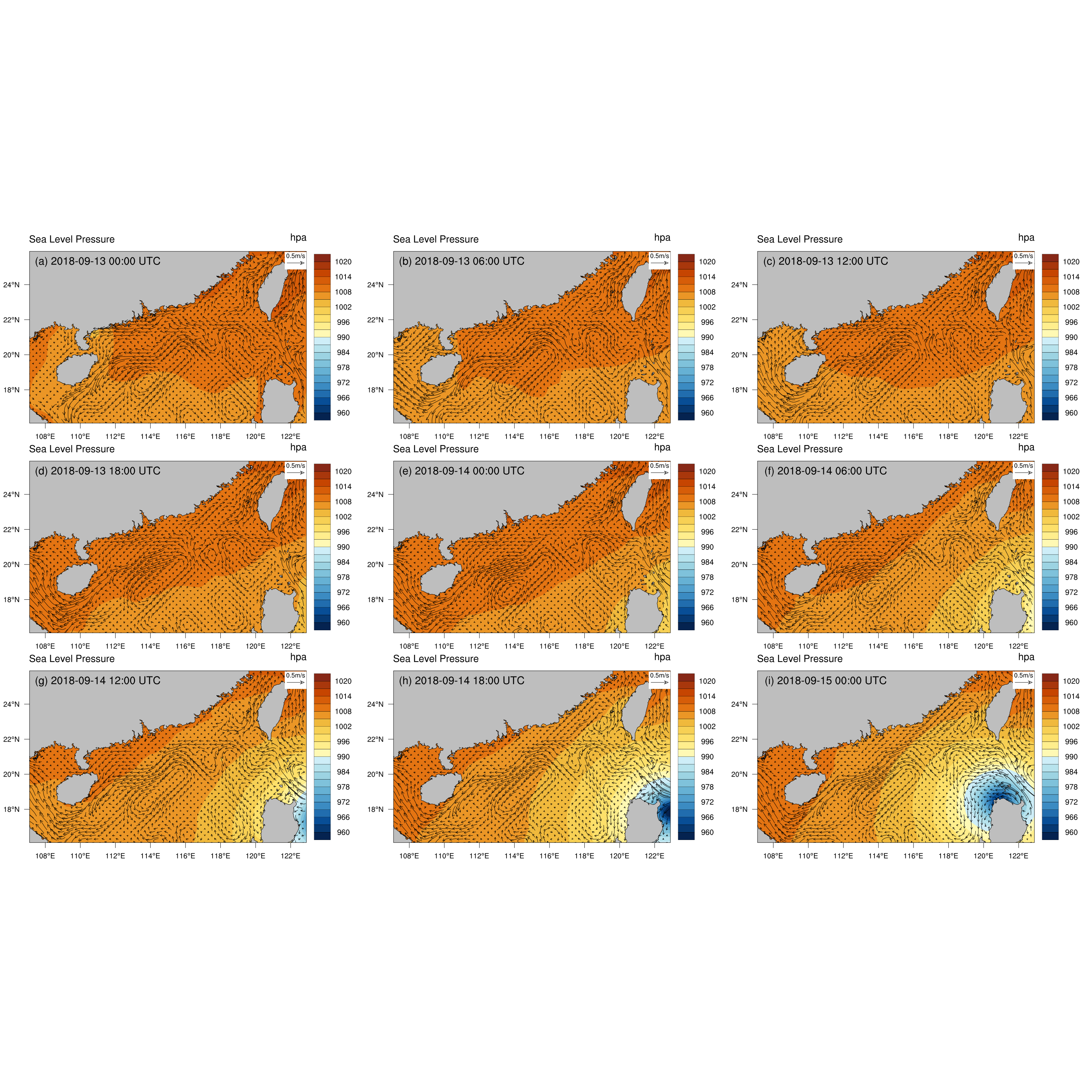

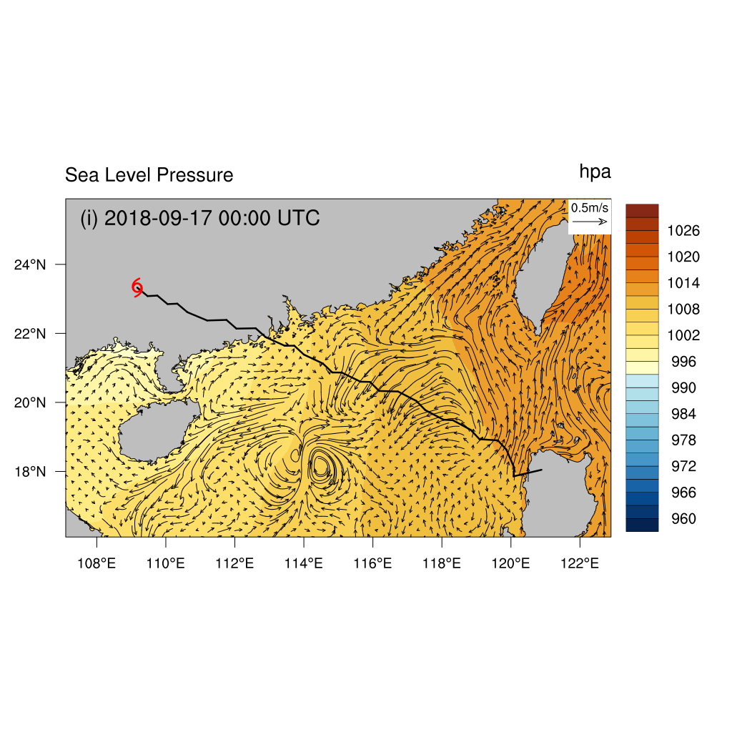

This is part of the flow field from day 15 to 17

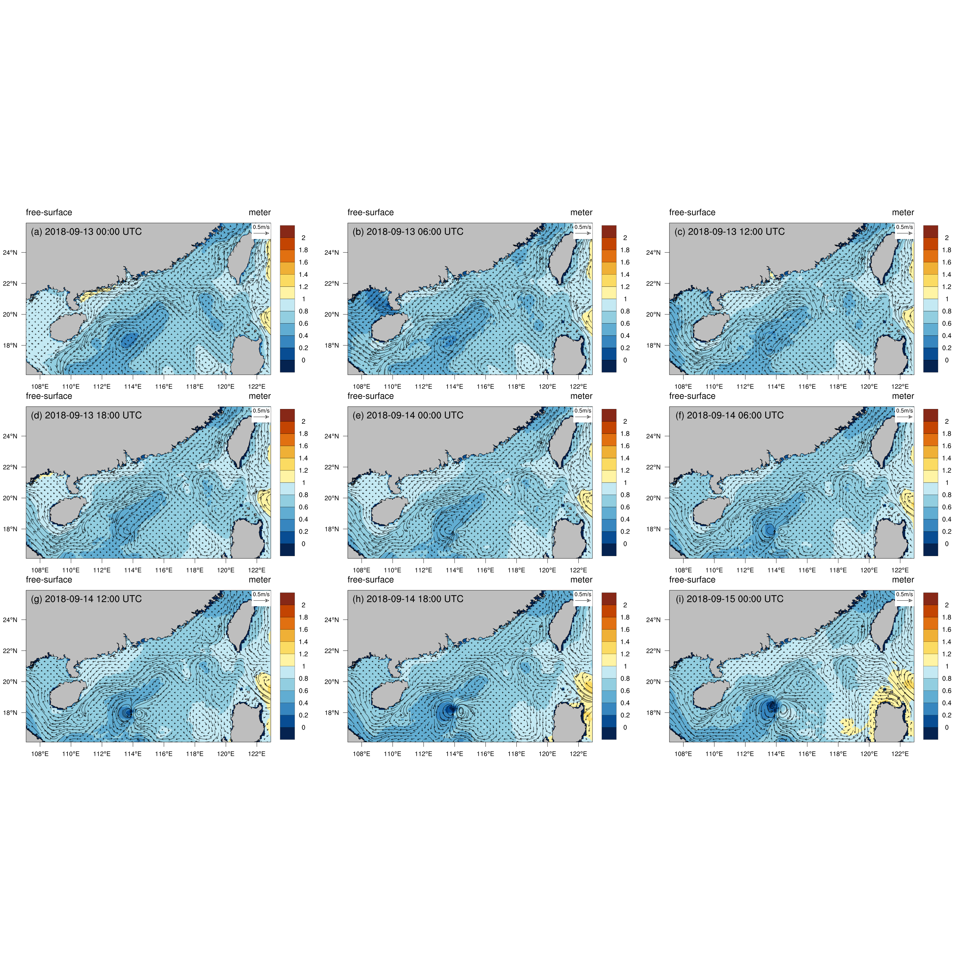

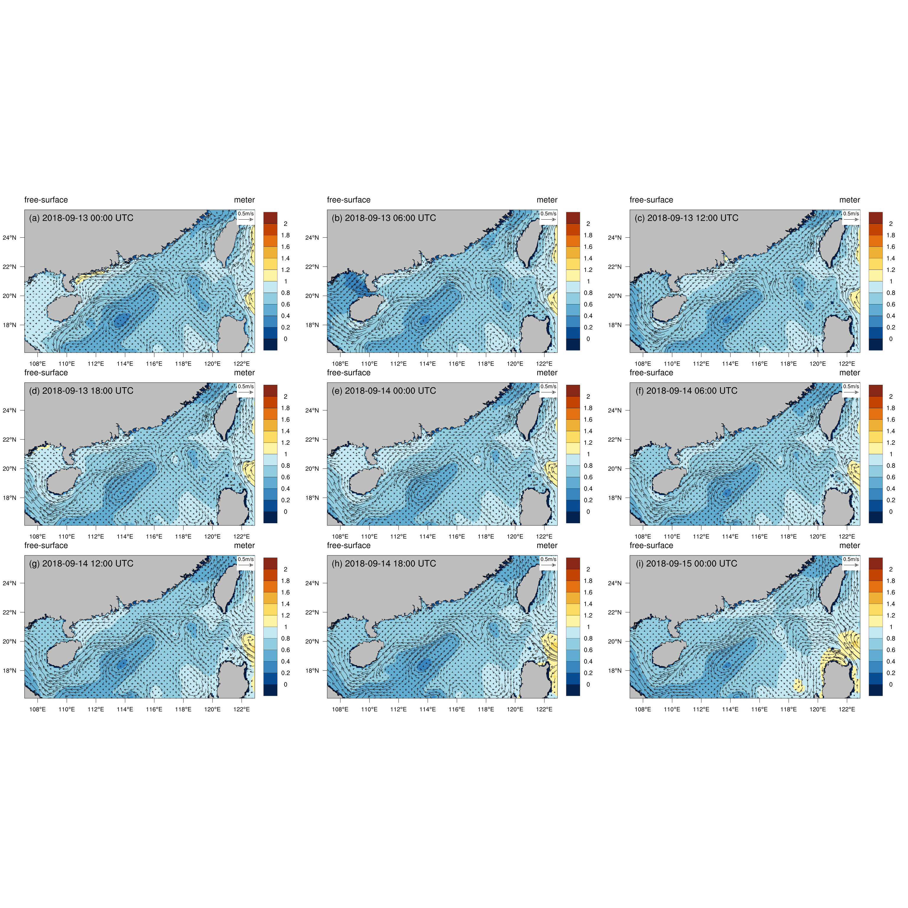

This is a simulation from 13 to 17, when the model collapses on the 14th, and the flow field is as follows
roms_mangkhut_2.in
(153.44 KiB) Downloaded 1685 times
Posts: 1222
Re: Questions about wrf-roms coupling
is this the nest or the parent grid?
if this is the nest, are the vortices advected into the nest from the parent?
what do the temp and salt fields look like? you are using radnudge on the south, so what are you nudging to?

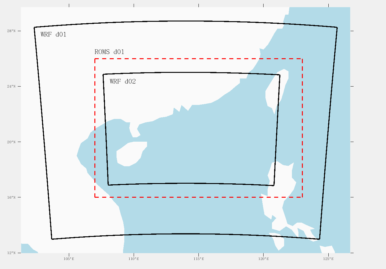

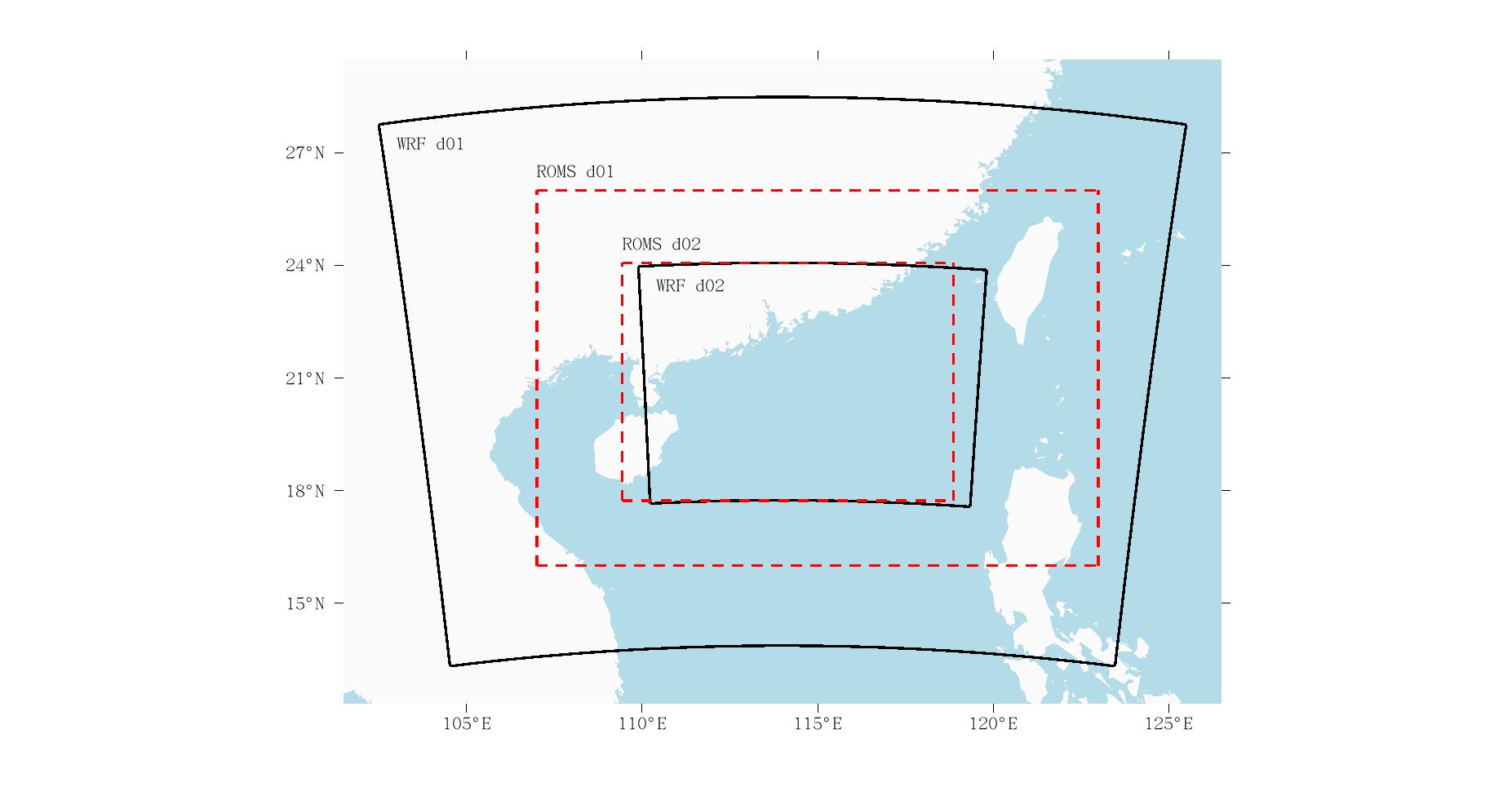

This is my grid situation, I noticed that the area where the vortex appears is at the junction of the grid, should I change the grid area?
Here are my temperature and salinity fields. Although there are some areas that are rather strange, I don't think they should be the cause of the vortex generation.

These grids are badly designed. I suggest that you run without the nested grids first. You always have to start SIMPLE! Then, you add complexity. Tropical storms are large, so the resolution of the coarser grids is sufficient. WFR would need surface temperature everywhere (land/ocean). If the ROMS grid doesn't provide the SST that WRF needs because of the incongruent grids, you must complement it with data. Nowadays, a third component is added: the DATA model is used to export melded (DATA and ROMS) SST to WRF! By the way, if the ocean and atmosphere grids are not congruent, the atmosphere grid has to be always larger than the ocean grid. Otherwise, you will be forcing the fine-resolution ocean grid with two different resolutions of winds, which may give a horizontal gradient and curl at that open boundary.

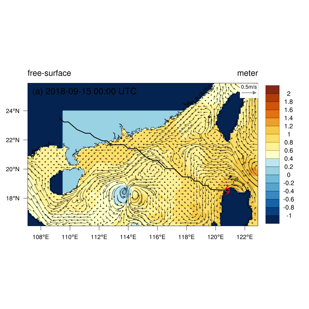

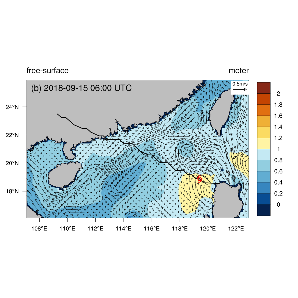

I have recently adjusted the subgrid of wrf to include the subgrid of roms. I also ran roms alone, without the wrf-roms coupling mode, and the results are still similar.
However, when I tried to draw the free surface (zeta), I found that the free surface on land was strange, the free surface height of the subgrid was smaller than the main grid, I don't know why this is the case, but when I looked at the two grib files, I found that I had set the minimum water depth to 5m and found nothing unusual.
I think this may be the reason for my abnormal flow rate, how can I solve this problem?
Posts: 1222
#7 Unread post by jcwarner »
i am not worried about the free surface, if that is all dry anyway. do you have wet dry on? did you set hmin = 5 in both the parent and child?
is this vortex created at the boundary and advected in?
can you do me a favor, i made a change to my version of nesting.F,
Are you using COAWST? if so please do an update and tell me if you get the answer. looks like you can just run roms.

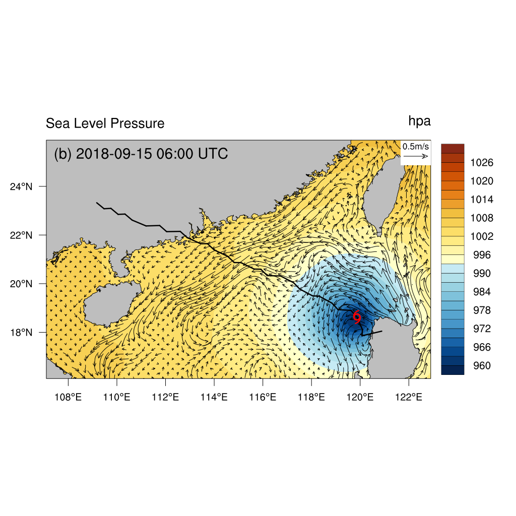

Hi, I recently re-uploaded your latest version of coawst from githut and it compiled and ran successfully.
There is no significant change in the result without changing the configuration of my previous roms, but I still get a strong vortex. What is wrong with this?

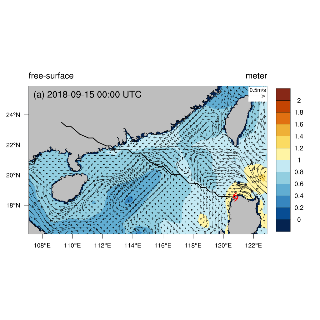

arango wrote: Fri May 27, 2022 2:01 am We recommended running without nesting, but still, you haven't reported that solution. Unfortunately, there is not much help that we can give you if the suggestions are not followed.
I'm sorry I didn't take note of your suggestion before, but I recently re-ran the coupled model without nesting and it made a big difference.
I have removed the nested grid from the roms and the range of the wrf model remains largely unchanged. The simulation period is still 13 September to 17 September. The results show that the strange vortex disappears when the roms nested grid is not used.
I guess it might be due to some problem with the boundary conditions of the generated subgrid? But I am using the method recommended in the coawst user manual. I'm wondering if you know what the cause is and I'm hoping you can give me some advice.
The simulation area and results are shown below.

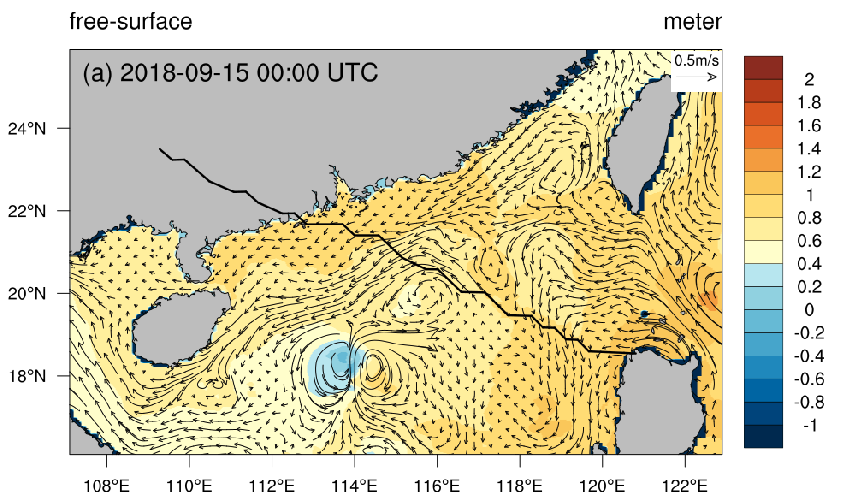

Yes, in the nested case, the vortices appear gradually over time and only on the southern boundary of the sub-grid and become progressively stronger over time. I have a ratio of 1:3 between the sub-grid and the main grid, which should match.
Below are flow field diagrams for the single-layer grid and the nested mode respectively. I think the error may be in the grid or the primary boundary file, I wonder if you could try this for me and I will attach my grid file.

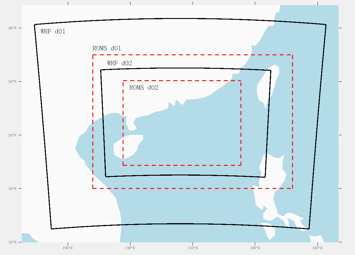

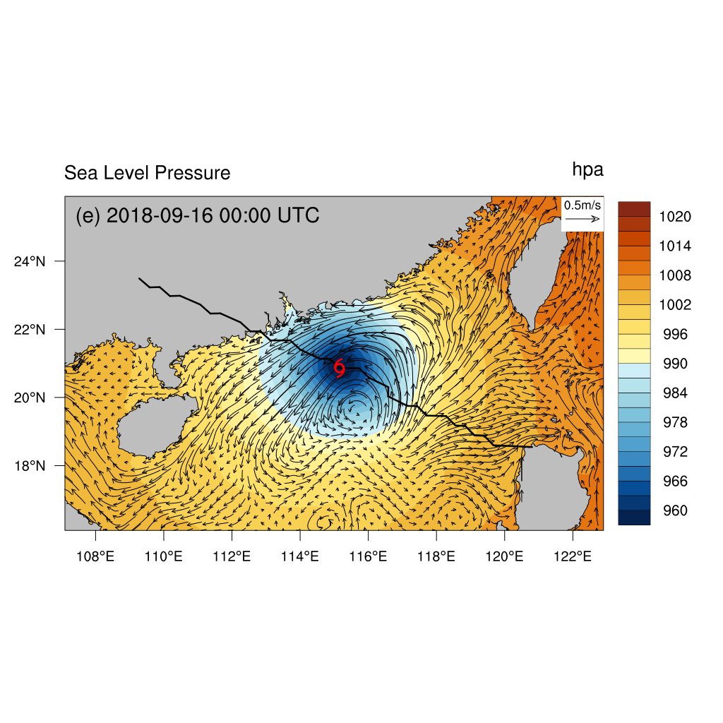

I mentioned before that your WRF nested grid is ill-conceived. It is inside of ROMS grid. It would be best to think about physics here and what the nesting is doing. You have a solid tropical storm covering the entire area, and there is a horizontal gradient of the wind due to coarse and fine resolution WRF grids. This gradient in the wind, in turn, creates a curl in the wind stress, and then you get vortices in the ocean around the boundaries of the WRF nested grids. It is oceanography 101!
The radius of deformation in the atmosphere is thousands of kilometers, so your coarse grid resolves the tropical cyclone very well. This kind of atmospheric nesting will be appropriate for a tornado, much lower scale, but they are mostly overland.

In response to Mr. arango's question, I have previously modified the roms and wrf child grids so that the wrf child grid area is larger than the roms child grid. The range is shown below.
I have nested the wrf model in the hope of verifying the accuracy of the simulated wind speed. I will then try to remove the nested model from wrf and simulate it again using a single layer grid. Hopefully the results will change.

Nested grids resolve smaller scale physics that may or may not be associated with your wind accuracy in the open ocean. For example, high-resolution winds are required next to mountainous coastal areas to resolve thermal fronts, convention, and other physics. In addition, small-scale phenomena like coastal sea breeze are affected by the resolution of the atmosphere, land, and vegetation models. At this latitude, the Rosby radius of deformation is between 80-100 km for the ocean and around 1000 km for synoptic scales (cyclones) in the atmosphere. I think that your coarse grids are resolving those scales. It is not a matter of accuracy but how well you can represent the atmosphere/ocean dynamics of interest in your discrete grids. A nested grid changes the solution because you add additional physics at smaller scales. You cannot put nested grids everywhere because you have such capability, The first thing that you need to ask is what kind of dynamics you want to study and make the decision on your discrete resolution. I don't know if there is some type of leakage from WRF nested grids, you need to plot and overlay the WRF solutions and compute quantities like vorticity. If you have a leakage, you need to ask the WRF community for advice. If you need smaller scale winds, decrease the resolution of the WRF coarse grid. I bet that it will be cheaper than having WRF nested grids.

ok i spent some time on this. I think the issue is a bathy mismatch between the child and the parent, especially near the boundary.
At the location of that vortex, the child grid has a bathymetric rise, but the parent grid did not see it. So i recommend that you use average child bathy to replace the parent (where the child is located). i did something quick, you may want to do some thing better, but this seemed to help a lot.
please let us know if this works for you.
this creates a new parent grid, copies the avg child bathy into the new parent grid, and then new contact file.

I have good news. Based on the master mesh file generated from the matlab file you provided, I created the initial boundary file. Afterwards I applied it to the coupled model of WRF-ROMS and the model can now be run successfully and the results are more than satisfactory! I have placed the results at the end.
As for yesterday's news, I originally used the uncoupled ROMS model and it ran with errors. But I have no problems with the coupled model today, so I think there may be a problem with the Forcing file for the uncoupled model and I will try running it again.
Your method is very useful, thank you very much!
