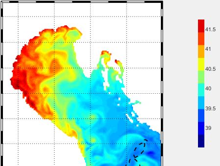

I run the model but I have faced a problem. I have 4 rivers and define monthly discharge with salinity=3 and Temperature=12.

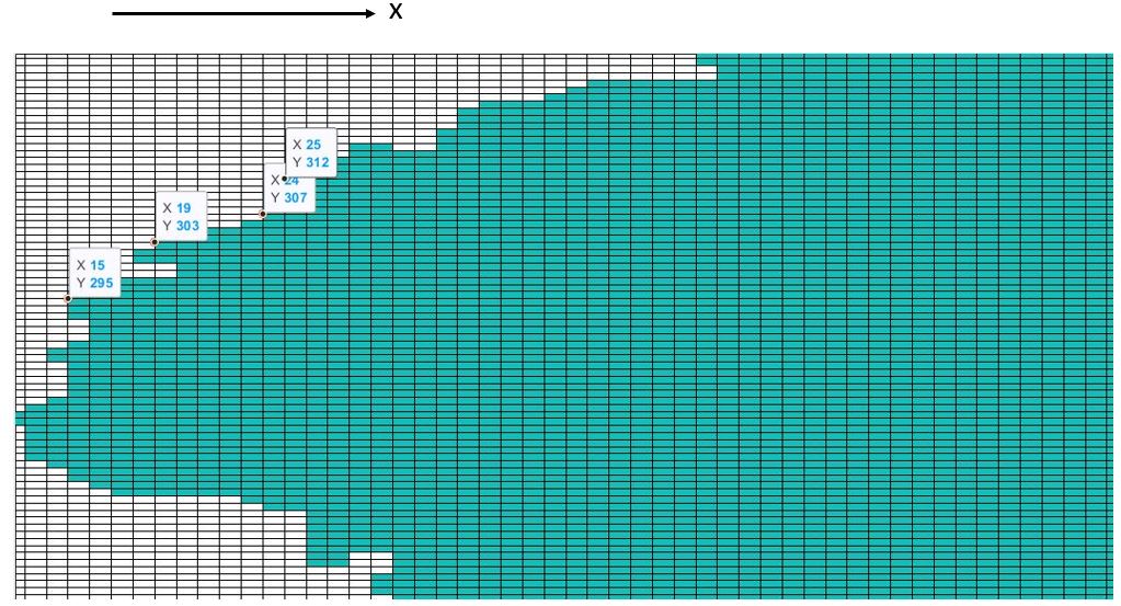

Here is the location of river points in my grid.
As my river comes from left to right, I define river transport as positive as mentioned here https://www.myroms.org/wiki/River_Runoff.
But after running, the model in the river runoff position shows more salinity compared to other points(top-left).
I cannot understand why?
The only thing that can be the wrong i,j? or transport?
please help me with your interesting comments

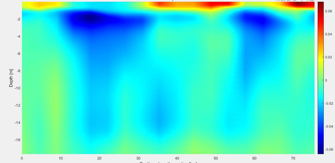

I have checked u velocity. It is here. I guess that the flow is towards the left.
The transport is positive so this can not be the problem.

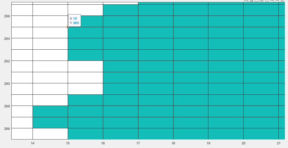

With regard to i,j, I consider i=15 and j=295 in my file(for example). is it right? the result is based on this approach!
now should i define i=16 and j=295 or i=14 and j=295?

https://www.myroms.org/wiki/River_Runof ... _Eposition
is a good description of the river locations.
it needs to be coming out of the land masked cell.

A long time ago Rich Signell wrote very useful Matlab function called "map_rivers.m" (I can see you are using Matlab).
If you can't find it in the ROMS matlab repo or somewhere on the net, I will try to dig it out.
Hope this example (you are showing on the figures) is not something you want to use seriously, you need to define proper river inputs/model forcing/ grid etc...(this is the Adriatic Sea and there are publications with many studies related to ROFI and whole circulation is veeeery sensitive to all that...)

The function roms_plot_river_source_locations.m in my roms_wilkin tools https://github.com/johnwilkin/roms_wilkin will plot the sources in Matlab with symbols to indicate the flow direction.

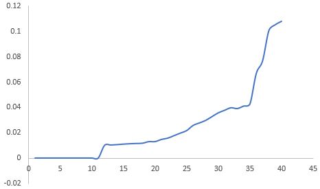

I try to define a profile thus I weigh in different layers. Here is it
I considered s_rho=1 to s_rho=40 is not right?
Do you mention that I should s_rho=0 to s_rho=40? It will be 41 layer?

Here s_rho is just an index for the vertical dimension. You say you have 40 vertical layers, i.e. you have N = 40 in ROMS. If you are working in Python then the index is from 0 to 39, if you are in Matlab the index is from 1 to 40.
That plot is an oddly varying profile for river_Vshape. You do understand what river_Vshape does, right? It partitions the inflow river_transport into the vertical cells. This doesn't have a huge impact on the solution because ocean dynamics quickly adjust the profile.
