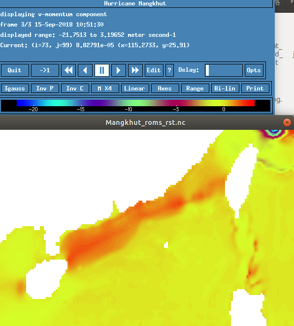

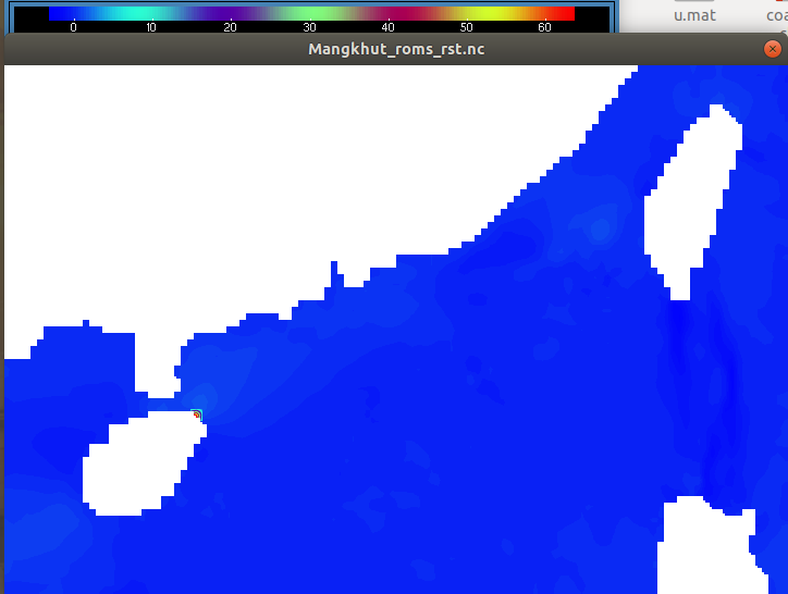

I was running roms and found that the model crashed at the fourth hour and prompted me with excessive speed at a certain point, I checked the rst file and found that there was indeed an exception, how do I fix this?
I have tried changing the model grid, the time step, but nothing has fixed the problem. Please can you help me.
Below is a screenshot of my logs file and rst results.

Posts: 1222
Re: How do I solve the simulation speed anomaly?
what is the bathy in that corner?
i see you have
5.0000E+00 theta_s S-coordinate surface control parameter.
4.0000E-01 theta_b S-coordinate bottom control parameter.
50.000 Tcline S-coordinate surface/bottom layer width (m) used
not sure what that looks like in the vertical, but it might be tight vertical spacing in the shallow locations.

I referred to other solutions to the problem and turned on the WET_DRY switch in the cpp and things got somewhat better.
But after I expanded the grid range, I ran it again and found some problems with the northern boundary.
Posts: 1222
#4 Unread post by jcwarner »
ok. if you min depth = 5 meters, and then wet/dry helped, i suggest you look at the zeta values to make sure the tides are ok. what is the tide range in this area?
for the next problem, that is probably a density issue. closely look at what is being put along that boundary for temp salt u v etc.
you need to dig into the output.
