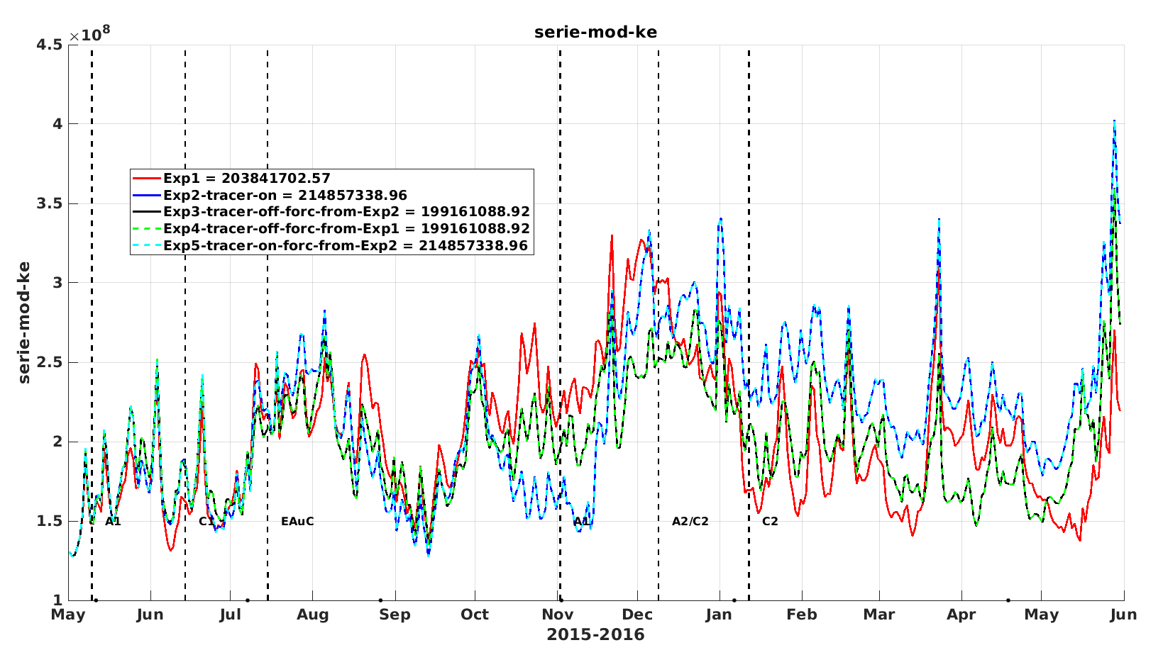

Hi all,
A free run (Exp1 - red line) was generated in Sep 2021. In March 2022, I ran Exp2 (blue line) turning on passive tracers (all needed cppdefs), and adding dye_01 to ini, bnd and river files. The experiments generated different results (fig attached - time series of total KE in cm^2/s^2).
I thought the modifications to ini, bnd and river files caused the difference. I turned off tracers and started/forced the model with same ini, bnd and river files from Exp2 (dye_01 included) and ran Exp3 (black line - under green line), which generated different results.
I ran Exp4 (green line) with tracers off (cppdefs) and ini, bnd and river files from Exp1 (without dye_01) and it reproduced Exp3 (cppdefs tracers off but river with bye_01). So, binarily different files (log below) generated the same results (they are similar at the end).
santanarc@maui02:~/small_grid/free_j_inert_20150501$ diff frc_rivers_northeast_shelf_fixed2.nc frc_rivers_northeast_shelf_fixed2_dye.nc
Binary files frc_rivers_northeast_shelf_fixed2.nc and frc_rivers_northeast_shelf_fixed2_dye.nc differ
Exp5 (cyan line) had the same configuration and same result as Exp2 (blue line). Even though, binary files differ (log below).
santanarc@maui02:~/small_grid$ diff free_j_inert_20150501/roms_avg_0100.nc free_j_inert3_20150501/roms_avg_0100.nc
Binary files free_j_inert_20150501/roms_avg_0100.nc and free_j_inert3_20150501/roms_avg_0100.nc differ
Am I doing something wrong, or could the different results be attributed to the libraries used or to the different flags used to compile ROMS?
We're using Intel(R) MPI Library for Linux* OS, Version 2019 Update 5 Build 20190806 (id: 7e5a4f84c) and ROMS/TOMS version 3.7.
Thanks,
Rafa

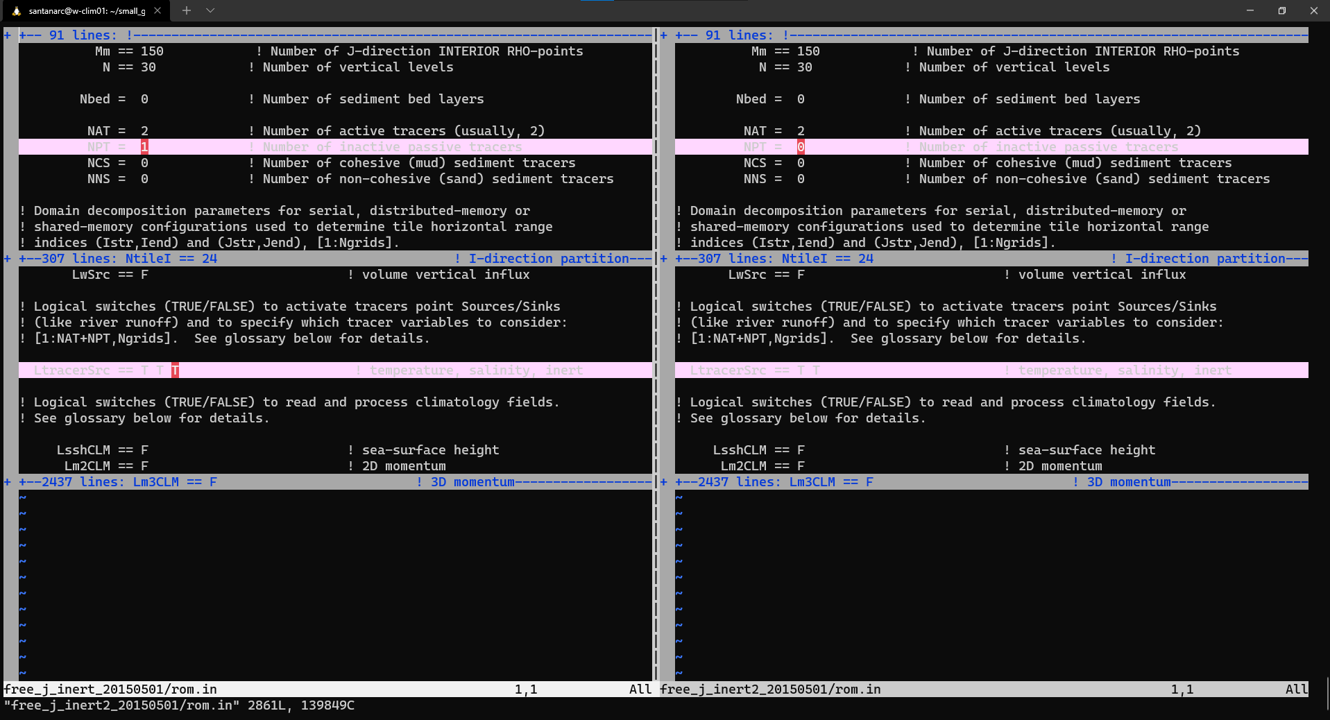

jcwarner
Posts: 1200
Joined: Wed Dec 31, 2003 6:16 pm
Location: USGS, USA
Re: ROMS not bit-reproducible: northern boundary?
#35 Unread post by jcwarner »
i had a little trouble following your logic, but it is not really clear what is causing the differences in the tke.
Can you look at fields of temp, u, v, AKv, etc to see if there is something noticeably different in the runs? like something happening along the open boundary. Are there rivers (with flow) the same in all runs? the passive tracer should not affect the tke, but the Qriver would.
Also, it could be the compiler flags, if you use ffast-math for example it will reduce the accuracy of the computations to gain faster computational speed.
-j

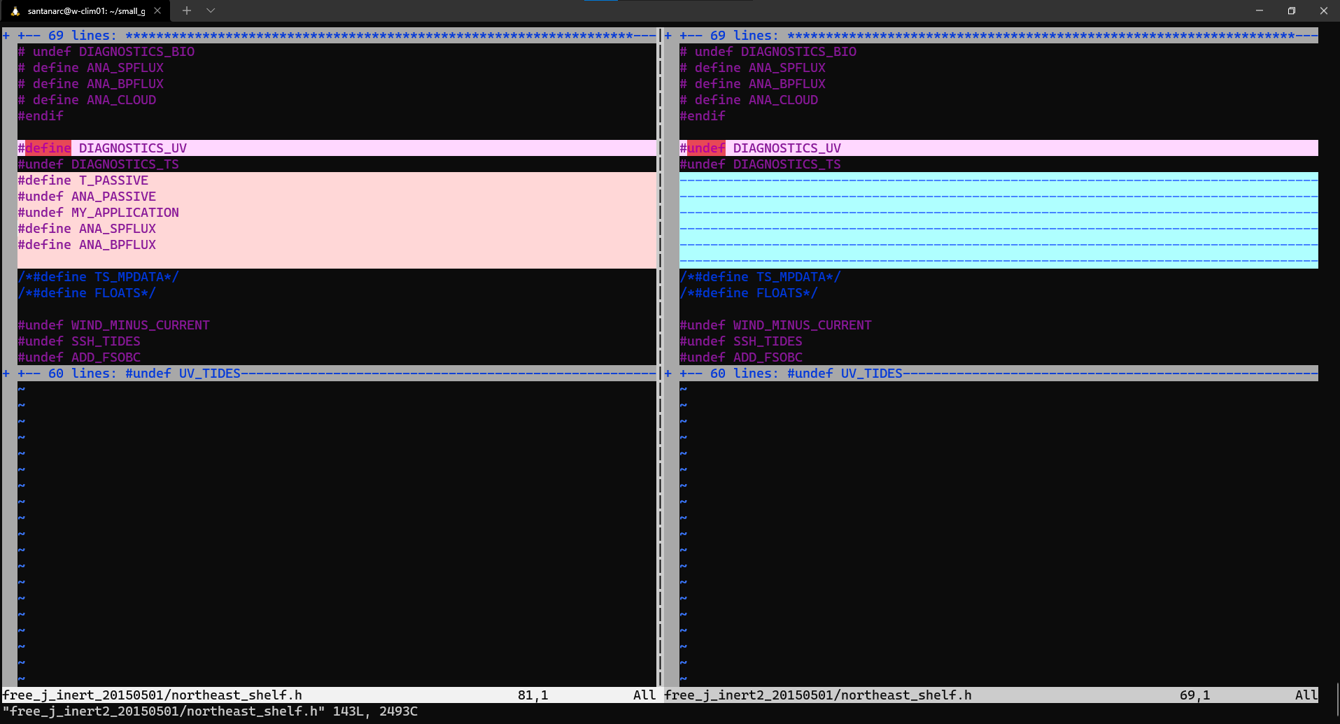

Rafael_Santana
Posts: 12
Joined: Wed Jun 04, 2014 1:45 pm
Location: UFBA and REMO
#36 Unread post by Rafael_Santana »
Thanks for your reply.
I looked at the fields of temp, u, v, ssh etc (not AKv yet) and the pattern is similar to what was seen in the TKE: 5 simulations with three slightly different results, and two being reproducible.
I didn't see strong differences at the boundaries, as well as near the rivers. River_transport is the same in all 103 points between the files. The river and bnd files are similar (copy) despite the addition of "dye_01" to them (matlab code below).
Exp2 (blue) and Exp3 (black) had the same ini and forcing files but had different results. I looked for differences in the .h flags and .in files in those experiments and the flags added were:
.h
#define DIAGNOSTICS_UV
#define T_PASSIVE
#define ANA_SPFLUX
#define ANA_BPFLUX
.in
NPT = 1
LtracerSrc == T T T ! temperature, salinity, inert
(screenshots of vimdiff attached)
% matlab code to add dye_01 to river file
path='/scale_wlg_nobackup/filesets/nobackup/niwa00020/santanarc/work/hikurangi/sim26/small_grid/free_j_inert_20150501/';
file_ini=[path,'frc_rivers_northeast_shelf_fixed2_dye.nc'];
r_temp=ncread(file_ini,'river_temp');
% creating dye with dimensions (time_fix, s_rho, river) ;
varname='river_dye_01';
nccreate(file_ini,varname,'Dimensions',{'river',size(r_temp,1),'s_rho',size(r_temp,2),'time_fix',1});
var_fin=r_temp.*0+1;
ncwrite(file_ini,varname,var_fin)
ncwriteatt(file_ini,varname,'time','time_fix');
I will keep looking for differences.
Thanks
