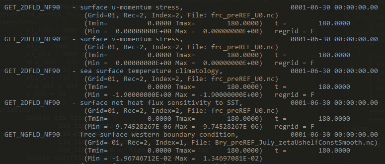

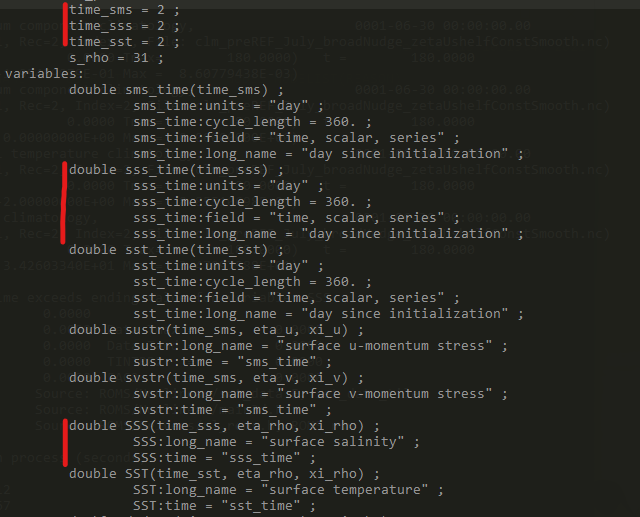

I have an issue that is similar to the one above. I am trying to run an idealized setup with daily time steps and a cycle of 360 days with ROMS 3.9. I have set TIMEREF=-1 and DSTART=1. For time-variable's metadata in the input-files I have assigned units 'day' and cycle_length=360.

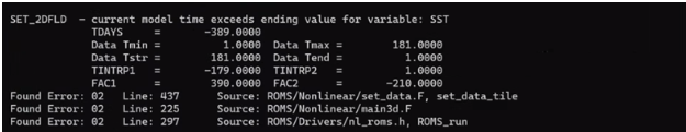

When trying to run the model I get the following error which is similar to the error above:
After reading documentation on how to assign metadata for time variables and how to state TIMEREF and DSTART (e.g. this note on an update from ROMS 3.6 to 3.7: https://www.myroms.org/projects/src/ticket/771) I am unsure of what metadata is required for my case, and also which settings that conflict with each other. I also find that the documentation is not consistent, e.g. regarding the units that should be used when TIME_REF=-1 (from roms.in: 'time-units since 0000-12-30 00:00:00', while from the link above: 'time-units since 0000-01-01 00:00:00').
I try to run with clm/bry/frc_time = [1, 181], which should be within the range of times of TIMEREF=-1 and cycle_legth=360.
I have tried also including the metadata calendar=360_day Calendar which did not help.
I did not have this issue with ROMS 3.6.
Any input would be highly appreciated!

#7 Unread post by wilkin »
Looks like your initial time is -389 days, which is not between 0 and 360.
It would probably make your time arithmetic easier to use DSTART = 0, and make the times in the forcing file [0, 180]. Make sure you spelled cycle_length correctly.

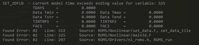

I followed your suggestion and tried to change DSTART to 0, and the times in the forcing files (Frc/Bry/Clm) to [0,180]. I also changed the single time step in the init-file to 0.
Unfortunately, this did not change much (although the negative times are gone). The error now reads:
Screenshot 2021-12-10 163915.png (32.51 KiB) Viewed 26797 times
I wonder why the error now appears for the SSS field and not the SST field as before and why all values are now 0 (I would expect e.g. Data Tmax to be 180). Further up in the run log where the forcing fields are read, the SSS field appears to be skipped: surface u- and v-momentum, sst, and dQdSST is read, but then the code continues to reading the boundary file:

The error says Tmin and Tmax are both zero. So, you have not associated the correct time coordinate variable with the SSS variable in the netcdf file. This is done by the "time" attribute for variable SSS, or if that is absent, it uses the entry for SSS in varinfo.dat.

These error messages are quite helpful if you read them closely:
If you inspect line 512 of set_data.F (last line of the code chunk below) you'll see it is the error condition triggered by a call to set_2dfld_tile to get surface salinity, which is code outside the block for #ifdef ANA_SSS
!  Set surface salinity for freshwater flux correction.
#    ifdef ANA_SSS
      CALL ana_sss (ng, tile, iNLM)
#    else
      CALL set_2dfld_tile (ng, tile, iNLM, idSSSc,                      &
     &                     LBi, UBi, LBj, UBj,                          &
     &                     FORCES(ng)%sssG,                             &
     &                     FORCES(ng)%sss,                              &
     &                     update)
      IF (FoundError(exit_flag, NoError, __LINE__, MyFile)) RETURN
This suggests you have not defined ANA_SSS.

I have, however, set the time attribute for SSS (in the same way as for SST), so I do not think this should explain the error. The screenshot below is the section from my forcing file that describes sss_time and SSS. Originally I had one time dimension and three time variables, but based on an example I tried to include three time dimensions. This did not result in any change.
Screenshot 2021-12-13 103345.png (99.15 KiB) Viewed 26626 times
Regarding ANA_SSS, I do not wish to use analytical SSS, which is why I have not defined ANA_SSS. Also, I do not define e.g. ANA_SST either, but still, SST is read from the frc_file while SSS is not. My colleague has tried to investigate the .F files where the error happens, but unfortunately, this did not give us new hints as to why the difference between how SST and SSS are read occurs.
