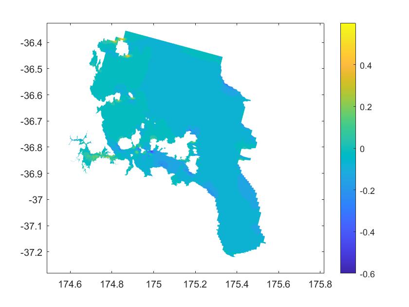

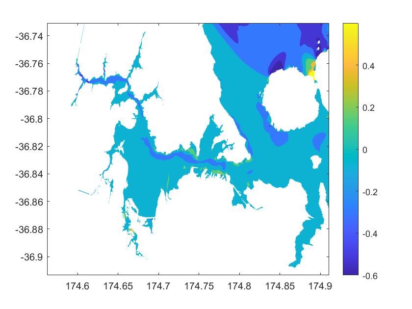

4. Snapshots of vbar (approx. east-west direction) velocity
Before the crash of the restarted model, the last snapshot in the history file is stored for the time step 288400 (40 minutes after restarting the model).
Figure1: the above figure shows vbar in the continuous model, at timestep 288,400. (see attachment figure1_vbar_continuous.jpg)
Figure2: the above figures shows vbar in the restarted model, at timestep 288,400 (see attachment, figure2_vbar_restarted.jpg)[/b]
The two models appear very different (see figure 1, figure 2 in the attachment), and some large velocity values (up to higher than 1m/s) are recorded in the restarted model in the area where the grid resolution is coarse (600 m in one or both direction).

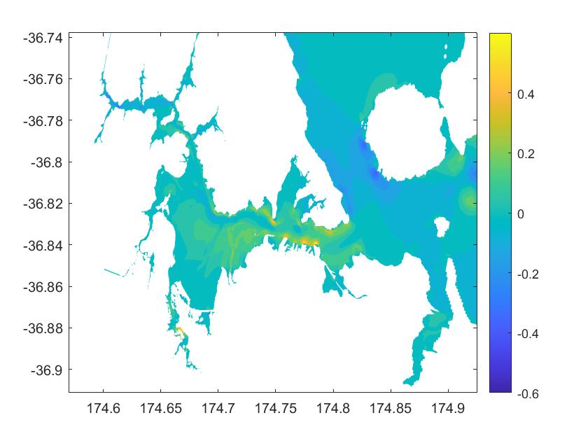

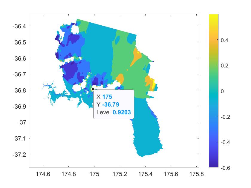

Below is a comparison in the area where the models have high horizontal resolution.
Figure3: the above figure shows vbar in the continuous model, at timestep 288,400; zoomed in to focus on the area with refined resolution; 25 meters in both horizontal directions. (see attachment figure3_vbar_continuous_25m_Res.jpg)
Figure4: the above figures shows vbar in the restarted model, at timestep 288,400; zoomed in to focus on the area with refined resolution; 25 meters in both horizontal directions. (see attachment, figure4_vbar_restarted_25m_Res.jpg)
In the area where the grid resolution is fine, 25-meter, the discrepancy is also very significant. Some topographic eddies are well resolved in the continuous model (figure 3; see attachment), while absent from the restarted one (figure 4).
The results simply look as if they come from two completely unrelated models. I'm somehow at my wit's end, and the old posts on the forum have not completely solved my problem. Any suggestions will be appreciated! Thanks!
