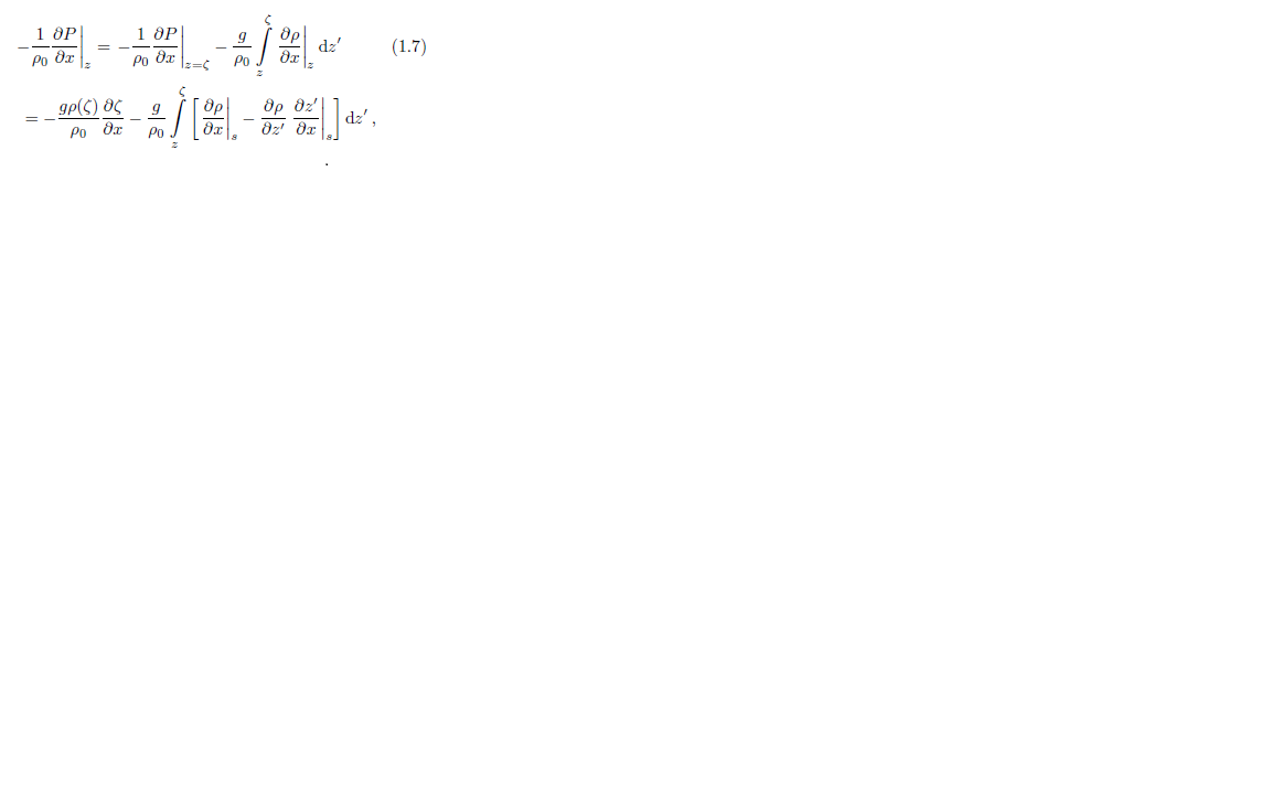

I think the reason for the 1000/rho0 scaling is from Sasha's paper:
A Method for Computing Horizontal Pressure-Gradient Force in an
Oceanic Model with a Non-Aligned Vertical Coordinate
equation 1.7 it has
1000.0_r8 * GRho * z_w =
1000.0_r8* g/rho0 * z_w
so this is g*z_w * 1000/rho0
and you want it to be
g*z_w
well, the difference is 1000/1025 = 0.97, as you said.
But it does not have the wrong units. The units are correct.
The 1000/rho0 is density over density and those units cancel.
equation 1.7 it has

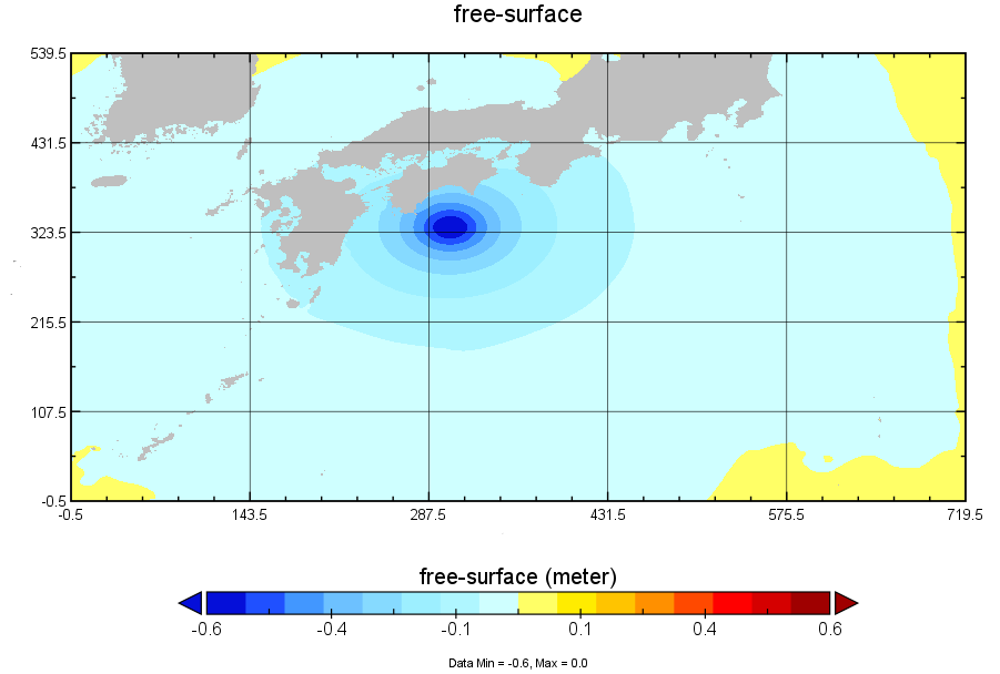

Dear arango
I try to run 2D mode in ROMS version 4.1.
In step2d_LF_AM3.h, we have:
The modified code is:
The same changes are made to rhs_vbar.
This case is storm surge caused by a typhoon. As a result, the original code shows the water level dropping at the center of the typhoon. On the other hands, the modified code shows the water level rising at the center of the typhoon due to inverted barometer effect.
I hope this helps.
Original code: Modified code:
! Compute pressure gradient terms.
I hope this helps.
- Posts: 1387
Re: Horizontal surface pressure gradient forcing in 2D and 3D
I don't have a shallow water (2D kernel) application to test this term. But, yes, a cyclone rotates counterclockwise around a center of low atmospheric pressure in the northern hemisphere. Consequently, the inverted barometer effect causes the water level to rise to form a dome around the low-pressure center. The opposite would happen over a cell of high air pressure causing the water level to drop.
Good catch, thank you
I agree that we will need a minus sign in the barotropic pressure gradient above. However, we didn't discover this bug because we rarely run the shallow water setup, much less with atmospheric air pressure forcing.
Checking on my notes, I did notice the plus sign when I was coding the TIDE_GENERATING_FORCES adjacent term in step2d for a similar shallow water setup. I was supposed to set a test case with air pressure forcing, but it was low on my long priority list. So, I forgot. Thus, your application is a good one to test the ATM_PRESS term. Thanks.
