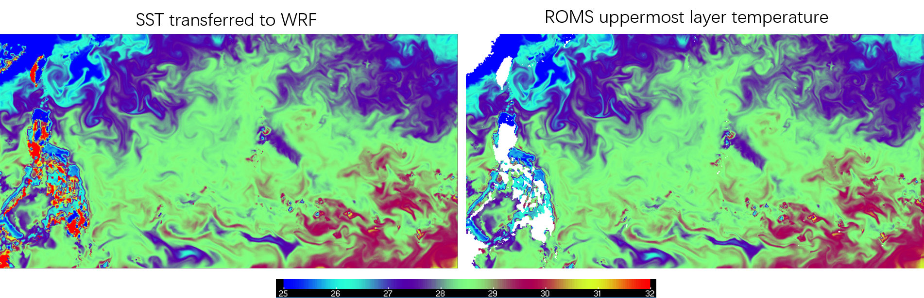

I have compared the results from the WRF-only simulation and the WRF-ROMS simulation, the results from the WRF-ROMS coupling model are inaccurate, the TC intensity is much weaker than the best-track data. By examining the model output, I found that the error came from the SST which forced the WRF model. When WRF is forced by the NCEP analysis SST in the WRF-only simulation, the result is acceptable. However, when WRF is forced by the SST transferred from ROMS in the WRF-ROMS simulation, the result is bad.
I compared the NCEP SST and the ROMS SST (figure1), it is denoted that the SST from the ROMS is about 2-3℃ colder than the NCEP SST, and a comparing with the OSTIA high resolution SST analysis data (http://podaac.jpl.nasa.gov/dataset/UKMO ... GLOB-OSTIA) showing that the ROMS SST is too cool indeed, making the TC intensity much weaker.

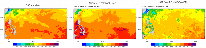

Then I compared the SST transferred to WRF (in the wrfout_d02 files) with the ROMS uppermost layer temperature (in the ocean_his.nc), they are entirely identical (figure2). My question is:
1. Does COAWST transfer the uppermost layer temperature of ROMS to WRF as the SST? I learned from the forum that the uppermost layer in the ROMS may be not the surface layer, it may be serveral meters under the surface, if the temperature of this layer is treated as SST, is it inaccurate because temperature of this layer may be several degrees cooler than the surface?
2. If I misunderstood it, and the SST transferred to WRF is treated in other way, is there any way to improve it? For the SST in my WRF-ROMS simulation is not accurate, I have tried turn on the QCORRECTION in the ROMS, but thing didn't goes better.
