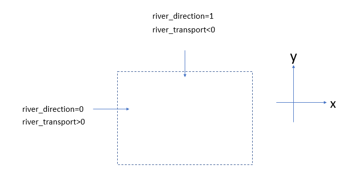

In this figure, I have illustrated how to define variables. Is it correct?
please help me with your interesting comments!

The explaination in wikiroms is confusing. And the issuse is that if you set the right river_Xposition and river_Eposition.
Maybe you can read #5 of this post viewtopic.php?t=2200
Update:
Wilkin reminded me that my answer is problematic. And here is his advice, which is really useful for me:
"See this diagram:
https://www.dropbox.com/s/qdlkafln4rcvn ... M.png?dl=0
(The shaded grid are rho-centered cells of the physical model domain. Points outside the shading are computational points used to complete the finite difference stencils for boundary conditions only).
In Matlab indexing (counting from 1 for all variables) if you want your river to flow into cell rho(3,4) this is actually ROMS index (2,3) because we count from (0,0).
If the flow enters the cell from from the left u-point (river_direction = 0) that is FORTRAN index (2,3). If you want it to enter from the right (river_direction = 0 and river_transport < 0) that is u-point (3,3).
I have a Matlab tool at https://github.com/johnwilkin/roms_wilkin called roms_plot_river_locations.m that will plot where your river file wants to place the inflows. It shows the sense of the direction. With LuvSrc, make sure all inflows fall on a land-sea boundary.
If you are working in Python all variable number from zero, so you still have to be careful because u-points number from (1,0) and v-points number from (0,1)."

Your interpretation of direction and transport is correct for LuvSrc. Are you sure the blowup is associated with the river source? The log file shows which grid point has the extreme values, and there should a 3rd record in the RST file capturing the state at blowup.

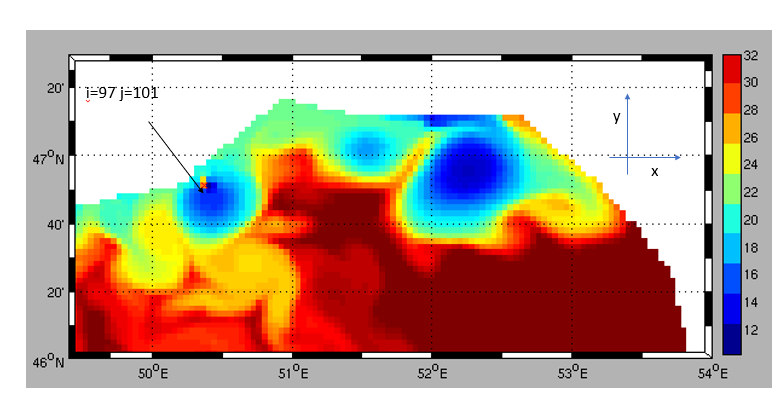

Thanks for your responses. I have repeated many times. Unfortunately, the model has faced blow up after 6 months. I have selected i=97 and j=101 for my model. The blow-up is (096,101,01). For this reason, I think that the runoff can lead to blow up.
This point has selected as for example i=96, the model does not any action to river runoff. Here is some information about this problem.

Did you provide river tracer values?

HI,
does your model blowup coincide with large freshwater flux from the river ? What are your salinity/ temperature values in the river forcing file ? It is possible that a large freshwater flux leads to problems with the tracer advection scheme due to strong horizontal gradients, this leads to uncrealistic temperature, salinity values and hence unrealistic density--> then blowup. If this is your problem you might want to split the river source into 2 or more sources.

I have selected tempearure=5 and salinity=1 PSU for the model. I think that your points can be true as the maximum freshwater is recorded in May which leads to blow-up. However, I have divided this freshwater into three cells too. The problem is not solved.

It looks like your river source is between 52E and 53E, far from the blow-up point. There is no particular reason to suspect the river is the direct cause.
You need to go through the usual debugging and testing steps...
Does the logile show you are perpetually close to CFL instability? If so, try decreasing DT.
Is the bathymetry near (97,101) particularly rough or steep? Maybe you need some local smoothing.
Is your choice of advection scheme and/or horizontal diffusion appropriate for this grid?
