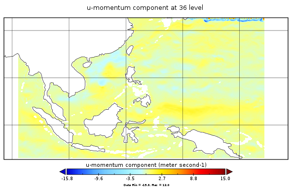

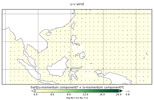

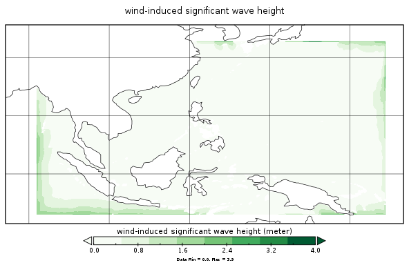

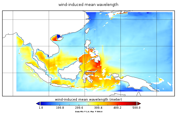

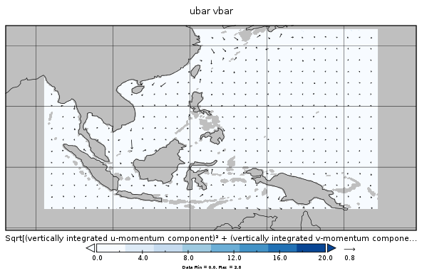

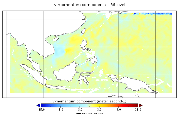

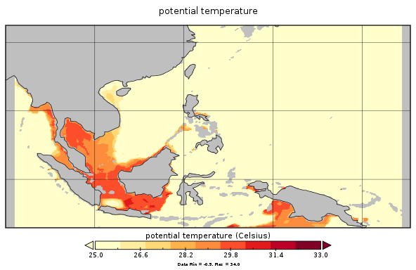

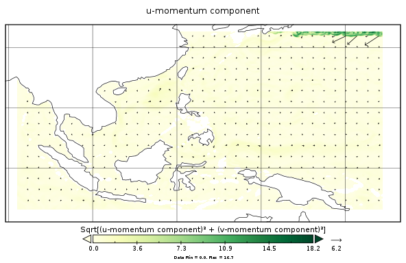

Re: ROMS blowing up problem
Hi Kate,
I have plotted some valuables in the last hst output file but I didn't see somethings went bad in my case or maybe with my limited knowledge about the ROMS model I didn't see that.
Can you kindly help me to find the solution for this blow-up error?
I have tried to use a shorter timestep but it still occurred.
Thank you very much!
How long before the final blow-up is this snapshot? You are running COAWST? I have no experience with modes of blowing up for anything but the ocean component.
For the ocean, it can go from fine to bad in the blink of an eye. A history snapshot some hours before the trouble can look great. I tend to look through the restart record it saves as it's blowing up. Did the velocity get large? Is it u or v or both? It is often just the one, at mid-depth. Looking at surface plots tells you nothing.
HI Kate,
Thank you very much for your reply.
My blow-up issue came up after more than 09 hours running as you can see here:
I also displayed u, v momentum component in all of my vertical levels, however I didn't find any abnormal value.
Can you kindly help me to find out the solution here?
I really appreciated your help.
Timing for main: time 2017-11-02_21:15:20 on domain 2: 1.68971 elapsed seconds
2230 2017-11-02 21:17:30.00 8.227072E-02 2.282634E+04 2.282642E+04 8.107080E+16
(216,070,02) 1.344279E-04 1.020814E-05 5.272707E-01 2.004695E+01
DIAG speed trouble 20.0469512008091
Found Error: 01 Line: 341 Source: ROMS/Nonlinear/main3d.F
Found Error: 01 Line: 331 Source: ROMS/Drivers/nl_ocean.h, ROMS_run
REASON: MaxSpeed = 2.0E+01
Timing for main: time 2017-11-02_21:15:40 on domain 2: 1.70914 elapsed seconds
WRT_RST - wrote re-start fields (Index=1,1) in record = 3
- v_in_ocean_rst.png (101.22 KiB) Viewed 56296 times
- u-v_in_ocean_rst.png (102.55 KiB) Viewed 56296 times
- u_in_ocean_rst.png (99.59 KiB) Viewed 56296 times
Those NE boundary conditions look ghastly. Something is going on there, I don't know what.
