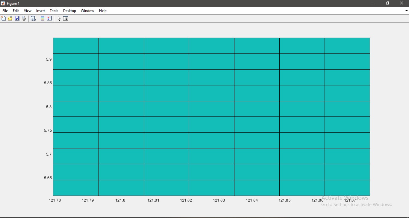

But when I trying to execute contact .m script using the coarse file phillipines_grd_1.nc and the finer file phillipines_grd_1_c.nc , I encountered the following error:
Gnames = {'phillipines_grd_1.nc', 'phillipines_grd_1_c.nc'};
>> Cname = 'phillipines_contact.nc';
>> [S,G] = contact(Gnames, Cname);
Unrecognized function or variable 'RFactors'.
Error in contact (line 311)
G(ng).refine_factor = RFactors(ng);
I am not sure what might be triggering this error. Is it due to the line Requested global attribute "history" not found in: phillipines_grd_1_c.nc which was shown while making finer grid ? I'm not sure as it is the first time I'm doing nesting of grids. Also is this https://www.myroms.org/wiki/Lake_Jersey ... Example_AC the correct way for going forward with my nested grids or is it just specifically tailored for Lake Jersey case ?

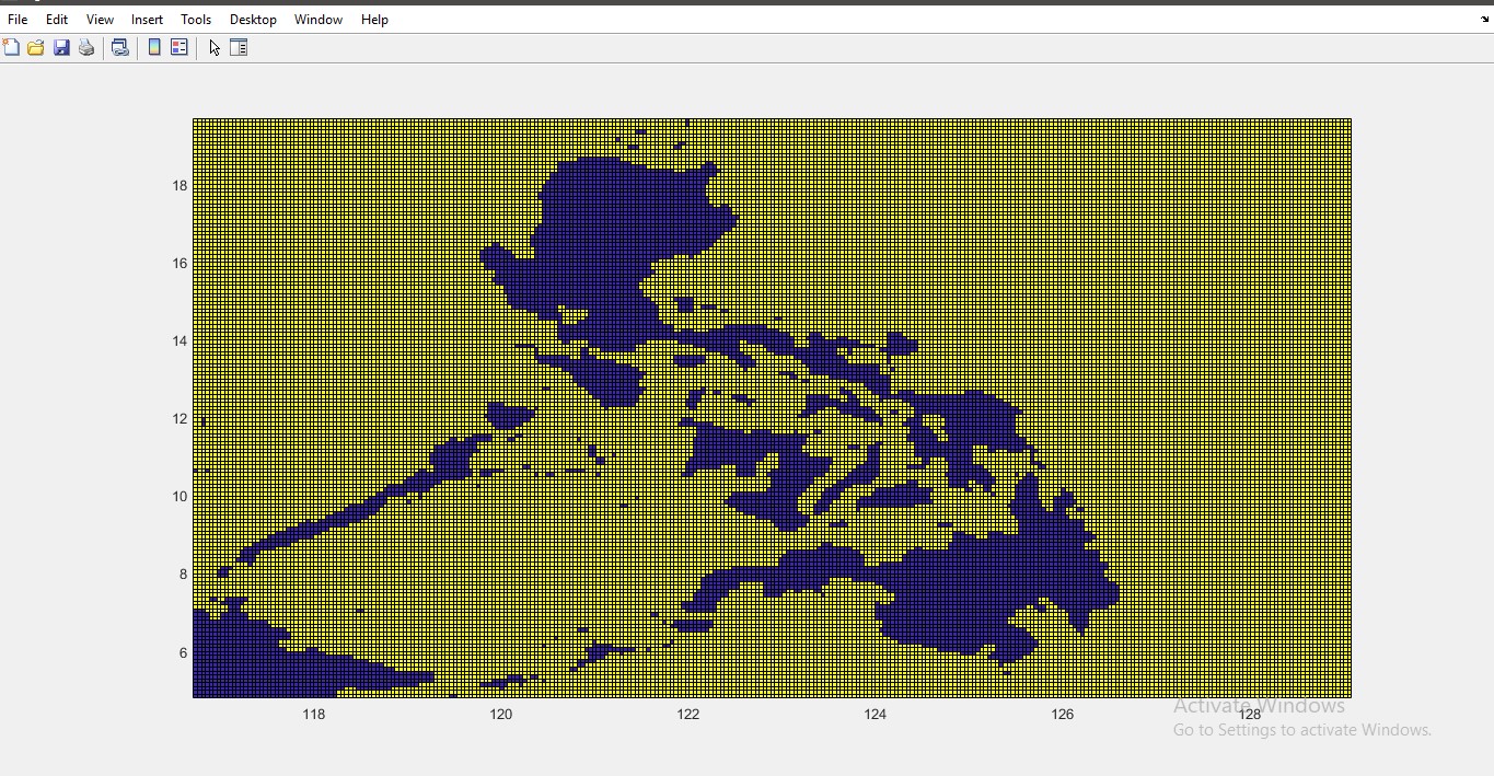

But when I try to view the grid in matlab it kind of distorts and doesn't look like the grid I wanted to make . Infact, all coastline, boundaries, mesh disappears. WHat might be the issue here ? I am unable to figure it out.
Any help in any kind is deeply appreciated.

coarse mesh
coarse mesh
fine mesh
fine mesh

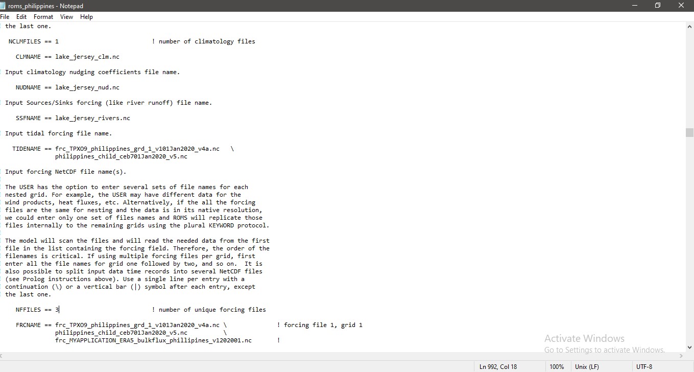

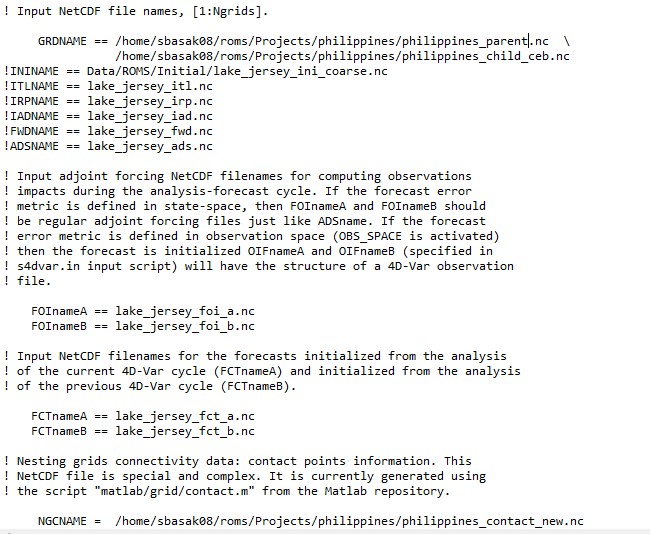

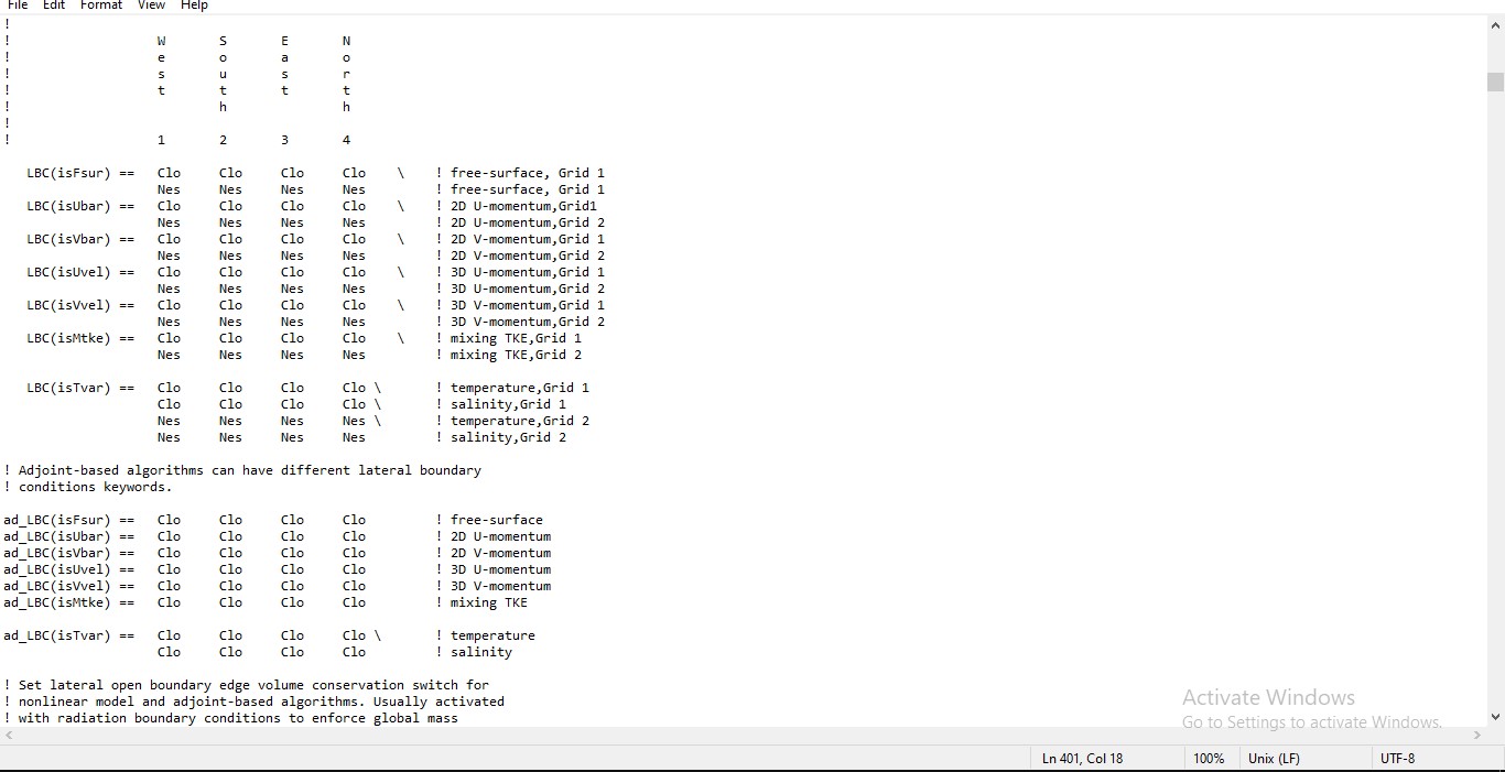

While trying to execute my ROMS model which has a nested grid in it, I get the following error:
sbasak08@DESKTOP-UOIVLQT:~/roms/Projects/philippines$ ./romsG <External/roms_philippines.in
Model Input Parameters: ROMS/TOMS version 3.9
Tuesday - June 1, 2021 - 10:36:31 AM
LOAD_LBC - incorrect continuation symbol in line:
Clo Clo Clo Clo \ ! salinity,Grid 1
number of nested grid values exceeded.
Found Error: 02 Line: 3407 Source: ROMS/Utility/read_phypar.F
Found Error: 02 Line: 191 Source: ROMS/Utility/inp_par.F
Found Error: 02 Line: 115 Source: ROMS/Drivers/nl_ocean.h, ROMS_initialize
Elapsed wall CPU time for each process (seconds):
Dynamic and Automatic memory (MB) usage for Grid 01: 298x148x15 tiling: 1x1

I am not sure what might be causing this "LOAD_LBC - incorrect continuation symbol in line: Clo Clo Clo Clo \ ! salinity, Grid number of nested grid values exceeded" error. I am using 1 child grid with 1 parent grid. According to https://www.myroms.org/wiki/Lake_Jersey ... Example_AB , where they've used 1 nested grid with a parent they too have used:
Ngrids = 2
NestLayers = 2
GridsInLayer = 1 1
LBC(isFsur) == Clo Clo Clo Clo \ ! free-surface, Grid 1
Nes Nes Nes Nes ! free-surface, Grid 2
LBC(isUbar) == Clo Clo Clo Clo \ ! 2D U-momentum, Grid 1
Nes Nes Nes Nes ! 2D U-momentum, Grid 2
LBC(isVbar) == Clo Clo Clo Clo \ ! 2D V-momentum, Grid 1
Nes Nes Nes Nes ! 2D V-momentum, Grid 2
LBC(isUvel) == Clo Clo Clo Clo \ ! 3D U-momentum, Grid 1
Nes Nes Nes Nes ! 3D U-momentum, Grid 2
LBC(isVvel) == Clo Clo Clo Clo \ ! 3D V-momentum, Grid 1
Nes Nes Nes Nes ! 3D V-momentum, Grid 2
LBC(isMtke) == Clo Clo Clo Clo \ ! mixing TKE, Grid 1
Nes Nes Nes Nes ! mixing TKE, Grid 2
LBC(isTvar) == Clo Clo Clo Clo \ ! temperature, Grid 1
Clo Clo Clo Clo \ ! salinity, Grid 1
Nes Nes Nes Nes \ ! temperature, Grid 2
Even I am using the same script structure as shown above.

So I tried to check my contact file because the error makes it very clear that something's wrong there but when I view it in MATLAB using the ncread command to see the variable Lm, I see that its Lm is a 2x1 matrix with values 298 147. I am not understanding why it's showing an inconsistent grid order error? Because my child grid is of resolution 149x95 and parent grid is 300 x 150, sp by that my Lm value should be 298 and 147 only in the contact file.
Am I naming the grids in incorrect order in my .in file? Because changing it didn't work. Or is it something else?

Posts: 936
Re: Problem faced during online nesting for ROMS using self created grid
#9 Unread post by wilkin »
You log file is reporting exactly the same inputs for the parent and child grids:
Resolution, Grid 01: 298x148x15, Parallel Threads: 1, Tiling: 1x1
60000 ntimes Number of timesteps for 3-D equations.
10.000 dt Timestep size (s) for 3-D equations.
and ...
Resolution, Grid 02: 298x148x15, Parallel Threads: 1, Tiling: 1x1
Physical Parameters, Grid: 02
While it is possible you've built a child grid with the same dimension, you certainly shouldn't have the same number of timesteps and dt for both grids.
I don't think you've understood how to configure roms.in for nesting.
If your grid refinement factor is, say, 3, then we would expect to see
180000 ntimes Number of timesteps for 3-D equations.
3.333333 dt Timestep size (s) for 3-D equations.
Having an irrational number for dt in the child such that dt(child) times refine factor is not EXACTLY equal to dt (parent) is not recommended. Make the parent dt an integer multiple of the child dt.

I can see that it's due to the tpxo9 forcing file that I used. I actually have 2 tpx09 forcing files, one corresponding to my parent grid 300 x 150 and one corresponding to my nested child grid 149 x 93. But I have two different TPXO9 files for one for each type of grid, then why is ROMS showing this error?
Do I need to have a forcing file that will have both my parent grid resolution and child grid resolution, but is that even a possible thing? Or is there some other reason behind it ?

Posts: 936
#11 Unread post by wilkin »
You can't have a tidal boundary condition file for the nested grid. It gets its boundary conditions from the parent.

#12 Unread post by neelbasak08 »
wilkin wrote: Tue Jun 01, 2021 6:30 pm You can't have a tidal boundary condition file for the nested grid. It gets its boundary conditions from the parent.
Thanks Mr Wilkin!
As you said that the nested grid should take its tidal forcing from the parent grid, I tried that now by removing the child grid's forcing file in both TIDENAME and FRCNAME variable and just kept the parent grid's forcing file there. But even now I am getting the same sort of error where it says it inconsistent xi_rho dimension 300 149

What might be the reason that ROMS is asking the xi_rho coordinate of my nested grid from the parent tidal forcing file?

Posts: 936
#13 Unread post by wilkin »
Are you reading the instructions - "GLOSSARY" - at the end of the roms.in template?
You see there that the tides go in one file - and apply only to the parent grid:
! TIDENAME Tidal constituents period, phase, elevation, and current data.
! This data is needed when SSH_TIDES, UV_TIDES, or both are
! activated to force tides at the open boundaries. Currently,
! in nested applications, the tidal forcing is used in the
! coarser/larger grid (ng=1). If AVERAGES_DETIDE is activated,
! several least-squares time-accumulated harmonic variables
! are written into this NetCDF file to facilitate restart for
! during long fitting simulations.
The surface forcing files are separate. Tides do not go in this list:
! NFFILES Number of unique forcing files per nested grid.
! FRCNAME Input forcing fields filename per nested grid.
! The USER has the option to enter several filenames for forcing fields
! and or split input data time records for each nested grid. For example,
! the USER may have different files for wind products, heat fluxes, etc.
! The model will scan the file list and will read the needed data from
