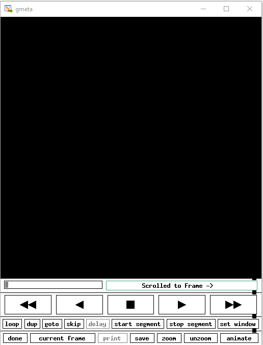

Hi Robertson,
Thank you for your explanation.
I've used the "module purge" command to clear all of my environment variables, then I loaded the netcdf, hdf5, NCAR_ROOT libaries with GNU compilers and recompiled this package. Finally, I could run it successfully.
[cloud@igplogin ROMS_output]$ ./csecG < csec.in
  Plottable Fields in Primary NetCDF File:
          ocean_hist1_00001.nc
 [ID= 59] bathymetry at RHO-points
 [ID= 66] Coriolis parameter at RHO-points
 [ID= 57] curvilinear coordinate metric in XI
 [ID= 58] curvilinear coordinate metric in ETA
 [ID= 56] angle between XI-axis and EAST
 [ID= 21] free-surface
 [ID= 13] vertically integrated u-momentum component
 [ID= 14] vertically integrated v-momentum component
 [ID=  1] u-momentum component
 [ID=  2] v-momentum component
 [ID= 19] vertical momentum component
 [ID= 20] S-coordinate vertical momentum component
 [ID= 23] potential temperature
 [ID= 24] salinity
 [ID= 41] vertical viscosity coefficient
 [ID= 68] surface u-momentum stress
 [ID= 69] surface v-momentum stress
 [ID= 76] bottom u-momentum stress
 [ID= 77] bottom v-momentum stress
  Available Times:
   57678.00
  Parameters:
      number of points (im,jm,km) =  390 286  1[img][/img]6
         basin dimensions (Lx,Ly) =   7202.094  5276.597
     temp          Rec = 00001 Min = -1.12582579E-01 Max =  3.46232872E+01
 GET_SCOOR: starting/ending points out of bounds
            in cross-section specification.
            Check (XSEC1,YSEC1) and (XSEC2,YSEC2).
Although the image is black which mean I have something wrong in my input. So, I will dig in this program.
Thank you very much for your help.
