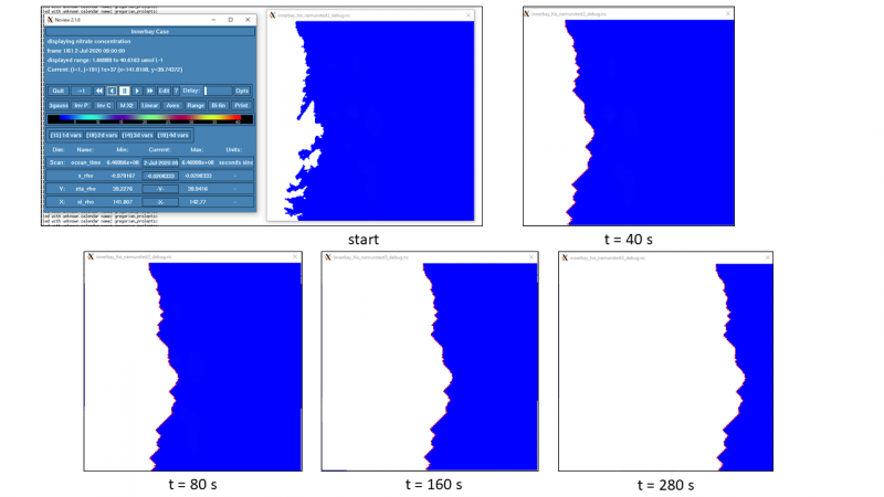

Thank you for your reply. I'm trying to investigate the varinfo.dat entries, but now have come across more issues, this time even with the river sources turned off. For my test run with NEMURO activated, the 11 biological tracer variables are written to the output netcdf file, but when I try to check their values using Ncview by clicking on a point within the modelling domain, I get an popop message saying 'All values are missing!'. However, when I check basic variables such as temperature, salinity, u, and v, all the values seem to have the expected output. I'm trying to find out what I could be doing wrong, and would appreciate any additional help from anyone who might be familiar with the general usage. For reference, I have attached my cppdefs.h and nemuro.in files.
nemuro.in
(46.31 KiB) Downloaded 1532 times

This is when you need to build up some debugging skills. You need to find out if the bio fields are sensible in the model, getting corrupted on output, or if they're just nuts everywhere. Feel free to add print statements at will.

Thank you for your comments. To observe the output, I focused on the first hour or so of the calculation and set the output of the history files to print out data every timestep. What I observed is that while temperature and salinity look fine, all of the NEMURO related parameters were either monotonically increasing or decreasing and 'flatlined' at some specific value, all within the first hour or so of simulation. And the trend was that this 'flatlining' occurred sooner closer to the coastline and a bit longer towards the open boundaries. To be sure it wasn't my open boundary values causing this, I also tried to close all boundaries related to the tracers in nemuro.in but got a similar result. So right now, it's really confusing for me. In some posts regarding ecosystem models, there would be a blowup or segmentation fault, and there would be information as to which files to look for specific errors in. But in this case, the model compiles and runs.
I guess as a follow up, I'd like to clarify more about the use of varinfo.dat. In the varinfo.dat file I'm using, I noticed that some of the nemuro related variables are defined twice or more, and there is a difference in the time units definition ('bio_time' in one definition, and then 'NO3_time' in another), and I'm wondering how this is handled within the model and if duplicates can lead to errors. What would be the best practice for this? Must I ensure that only one definition per variable exists? As always, I would greatly appreciate any help or advice.

lcbernardo wrote: Tue Jan 19, 2021 6:27 am Thank you for your comments. To observe the output, I focused on the first hour or so of the calculation and set the output of the history files to print out data every timestep. What I observed is that while temperature and salinity look fine, all of the NEMURO related parameters were either monotonically increasing or decreasing and 'flatlined' at some specific value, all within the first hour or so of simulation. And the trend was that this 'flatlining' occurred sooner closer to the coastline and a bit longer towards the open boundaries. To be sure it wasn't my open boundary values causing this, I also tried to close all boundaries related to the tracers in nemuro.in but got a similar result. So right now, it's really confusing for me. In some posts regarding ecosystem models, there would be a blowup or segmentation fault, and there would be information as to which files to look for specific errors in. But in this case, the model compiles and runs.
As an update to this part of my query, it turns out that the NEMURO parameters were not 'flatlining' to a specific numerical value but were actually becoming NaNs over time, if read out the variables in MATLAB. The biofields seem to be 'going nuts' over time (and over a very short time at that), and the trend is faster closer to the coast. If this is the case, which parts of the code might be good places to look at?

Do you have coastal river sources? Are you providing values of the BGC tracers on them? They can easy go unstable if you don't provide values for all incoming tracers. Look at the global NEWS product for nutrient values.

Thanks for replying Kate. My original intent was to add coastal river sources, but even with these turned off, the model output values for the BGC tracers seem to be going bad quickly. I tried both with a boundary conditions netcdf file (with values for all incoming tracers), and also with the open boundaries closed for the BGC tracers. In all cases, analytical values are used for the BGC tracer initial conditions. To more clearly indicated the trend, I have provided a set of snapshots after viewing the resulting NO3 values for the shallowest layer after specific time intervals:

I finally got to work on this issue after focusing on other stuff. I had been using COAWST, but I then tried using the latest version of Rutgers ROMS and with this change somehow the issue I previously had did not occur (NaNs suddenly appearing in the outputs). I guess this question is off topic, but it led me to wonder about how closely the ROMS included in COAWST operates compared with the original Rutgers ROMS which is the focus of this forum. I used to study wave and flow coupling, and hydrodynamics during typhoons, and for this I found COAWST quite helpful. But if I were to focus more on the ecosystem models such as NEMURO or Fennel, are there advantages to using Rutgers ROMS rather than COAWST?
