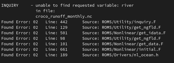

I have changed my river_runoff.nc based on your suggestion. Here is the new one. However, I have faced this error which is related to river variable. Although I have input river, the model cannot find this variable. Please note that my ROMs is a new version.

Re: Erorr when applying rivers
Here's what one of my rivers files looks like:
I have the tracers in a second file that doesn't depend on the year. Here, the variable "river" is a "dimension variable" and is just a list of integers, 1 through river. The discharge is in the river_transport variable.
There is a CDL template rivers file in the source code distribution at: Data/ROMS/CDL/frc_rivers.cdl
If you build your file like this it should work with the myroms.org code.
The fact that your file is named croco_runoff_monthly.nc makes me think you are using a different version of ROMS. If so, you should mention that in your post so that we aren't trying to solve version inconsistency issues for you.
Dear kate and wikin

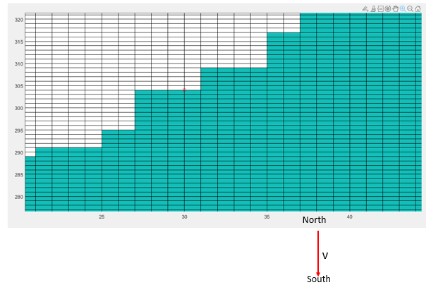

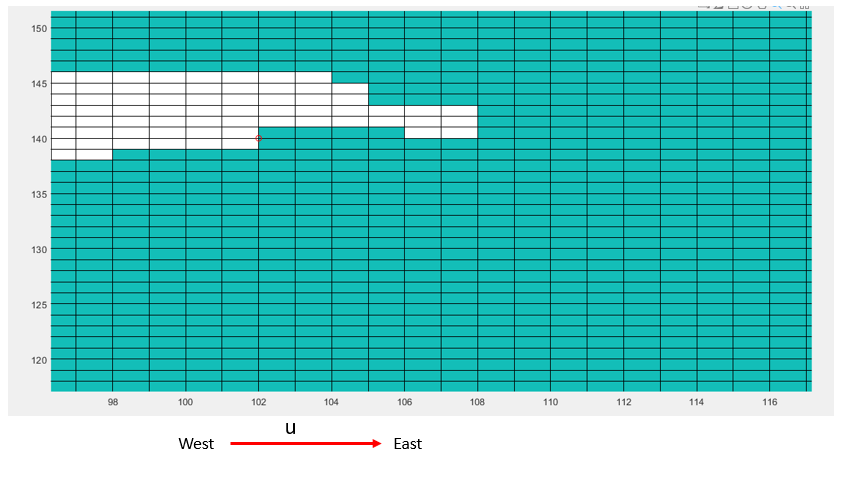

Thank you so much for your suggestions. ROMS is sensitive to order in arguments and it was my problem. Now my model accepts my river file. I use the new version of ROMS(Rutgers). Now my model runs with my river files when I try to run the river_plume1 test case. However, I have faced a new issue in the result. The river does not come to the domain. The model does not show any action to rivers in outputs. I have revied the forum and I guess that my problem can be because of the definition of source inland(i and j). I do not understand some points. Firstly, about river_direction, I do not understand exactly how to define values for this. In my domain, I have three rivers where one of which is north-south and the others are west to east. Secondly, x-position and Eta_position, here I plot my grid file and the locations of rivers. For my rivers what are the values of direction, x-position, and E_position? I have marked the point source in my grid when I applied the model.

Did you read this:
https://www.myroms.org/wiki/River_Runof ... _Eposition
When using option LuvSrc = T, river_Xposition and river_Eposition refer to the i,j index of the u-face or v-face the flow crosses - NOT the i,j index of the rho cell it flows into. The i,j values must follow ROMS Fortran numbering convention for the appropriate u-point or v-point on the ROMS staggered grid.
The ROMS FORTRAN numbering convention means rho points start from 0,0 in the "lower left corner", not from 1,1 (like Matlab would, e.g.).
