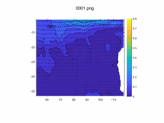

I find the velocity is too large near open boundary, but it don't blow up。I try to change .h file,but it does not work。What can I do for next step?

You haven't told us anything about your boundary conditions except which options you have. What is the frequency of providing new information and what is the source of it? I remember seeing a vast improvement when going from monthly climatology of just T and S to 5-daily SODA fields. The climatology is a collection of whatever measurements they have for a given season/location, not at all consistent with each other, while the SODA fields are internally consistent views of T, S and velocity, also SSH. Daily is better than monthly, if you can get it.

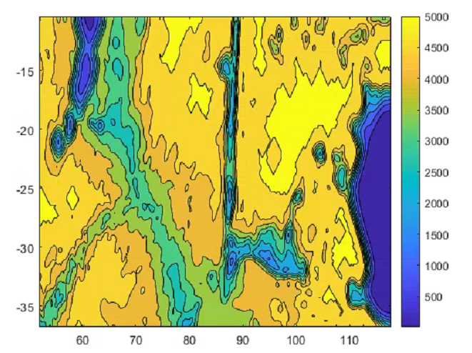

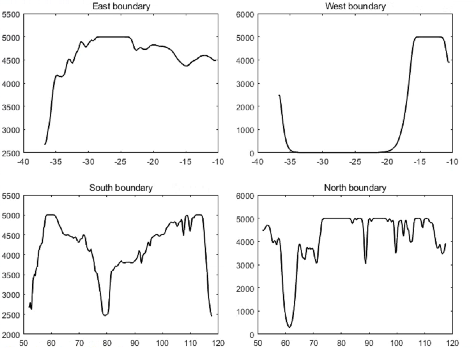

Could you show your bathymetry of both sides of the open boundary and your grid?

#6 Unread post by hezhi »
Those are my bathymetry.

#7 Unread post by hezhi »
These are bathymetry of open boundary.

To me it looks like the issue is at the northern boundary. You could try to either expand the grid to start further north at -5, or so, depending on the bathymetry. So that the bathymetry at the boundary is less steep. Or reduce the Eastern ( or is it really the Western?) boundary to 60 degrees instead of 50.
