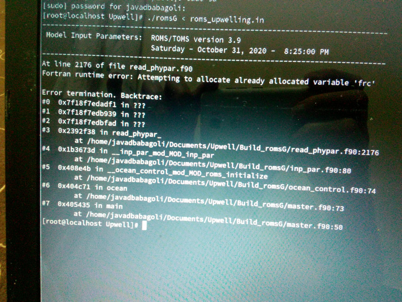

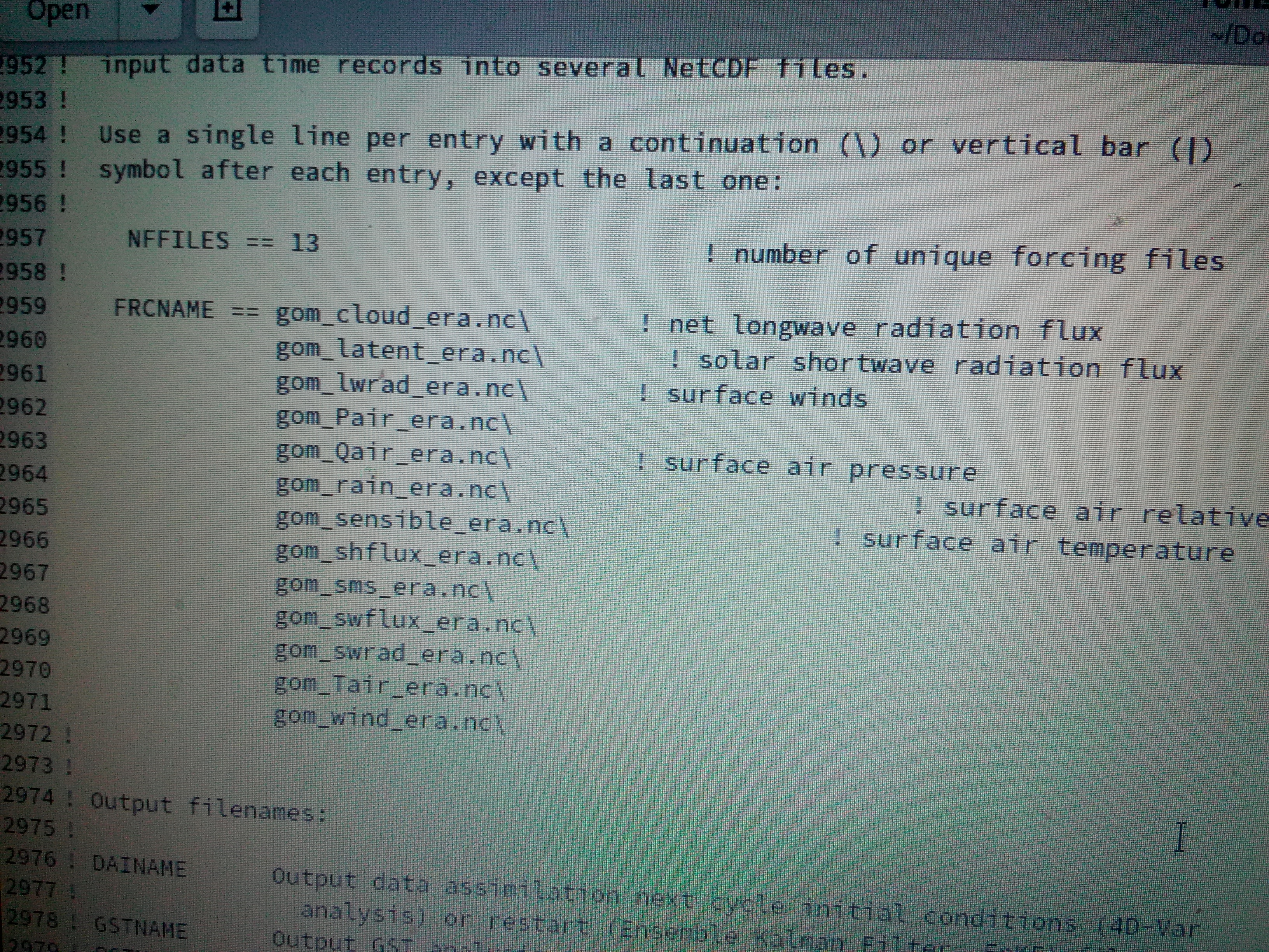

I have faced a FORTRAN runtime error in running time. Firstly, I made the grid for my region. The model run without any problem when applying my real grid. Then, I created my forcing file using d_ecmwf2roms script. I have defined 13 files in upwelling.in file and active smflux in upwelling.h. Here is snapshot of files. The model compile without any error; however, when I run, I have this error.

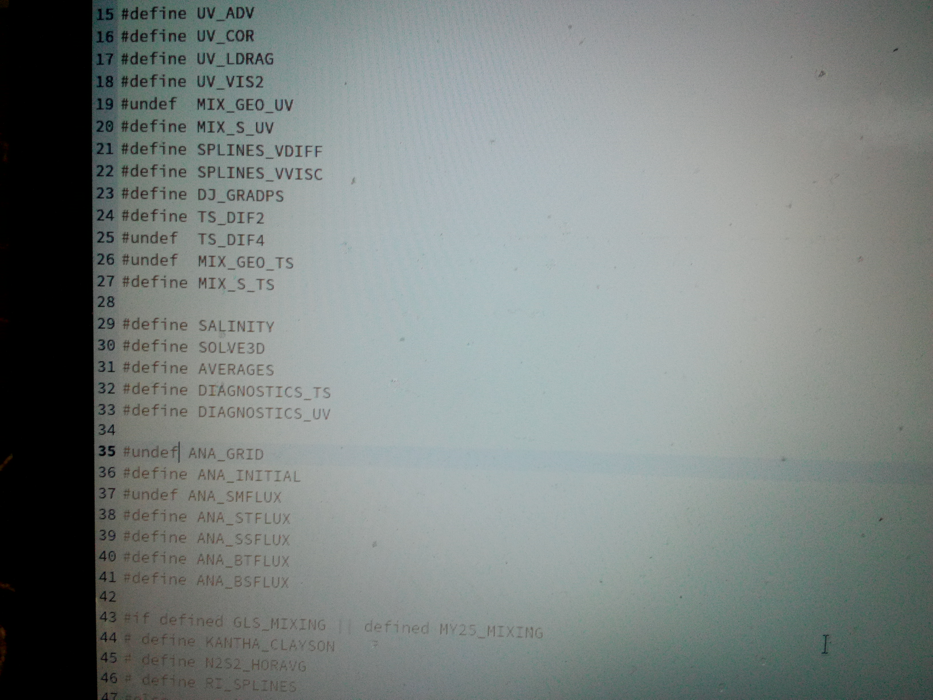

I see that you turned off ANA_SMFLUX. Did you turn on anything else to compensate? I use BULK_FLUXES with:
You probably don't need all that albedo stuff without sea ice.
# if defined BULK_FLUXES || defined CCSM_FLUXES
# define LONGWAVE_OUT
# undef DIURNAL_SRFLUX
# define SOLAR_SOURCE
# define EMINUSP
# undef ALBEDO_CLOUD
# define ALBEDO_CURVE /* for water */
# undef ICE_ALB_EC92 /* for ice */
# define ALBEDO_CSIM /* for ice */
# undef ALBEDO_FILE /* for both */
# undef ALBEDO_DIRDIFF
# define ICE_SHORTWAVE_R
# undef LONGWAVE

Maybe? I don't see BULK_FLUXES in your .h file, so without ANA_SMFLUX, the model will only read your sms_era file, not many of the rest of them.
There may be other errors in your roms.in file though. The line:
happens once in read_phypar.F, so I assume that's what's on line 2176 of your read_phypar.f90. It gets invoked when it reads the NFFILES line of roms.in. Do you have more than one such line? There needs to be one and only one such line.
allocate ( FRC(max_Ffiles,Ngrids) )

To be honest, I do not understand exactly how to turn on flag. Can you correct my upwelling.h? I try to use smflux. Now i should use my own grid named roms_grd.nc and forcing files. How active them in upwelling.h?
please help me
Yes there is one line.

check your ocean.in file make sure you dont have nffiles twice
NFFILES ==
NFFILES ==
the FRC array is allocated in read_phypar
CASE ('NFFILES')
so it seems to be doing that call twice.
NFFILES ==
NFFILES ==
CASE ('NFFILES')

From your .h file, I find you use ANA_SMFLUX, but you undefine ANA_SSFLUX and STFLUX.
Well, define ana_.. means you use anaytical functions in ROMS/fucntions to calculate this variable. However, it seems that you want to calculate them by Monin-Obukhov similarities method in bulk.F but not anaytical functions.
Maybe defining BULK_FLUXES and undefine ana_... like Kate shown above is better for your case.
