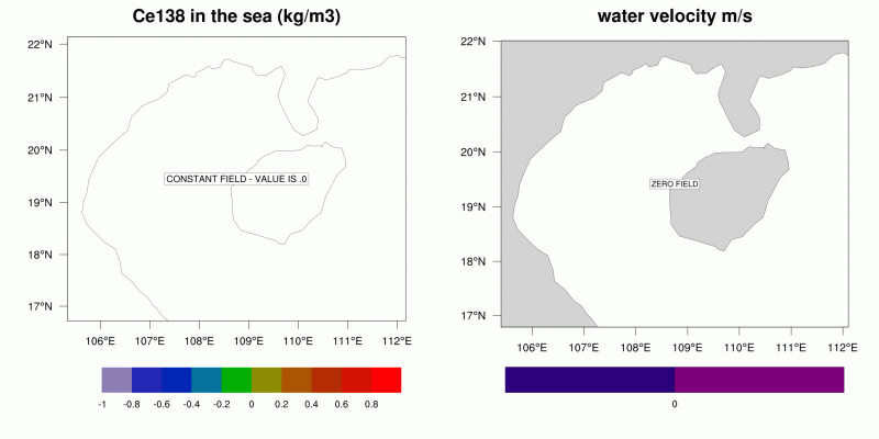

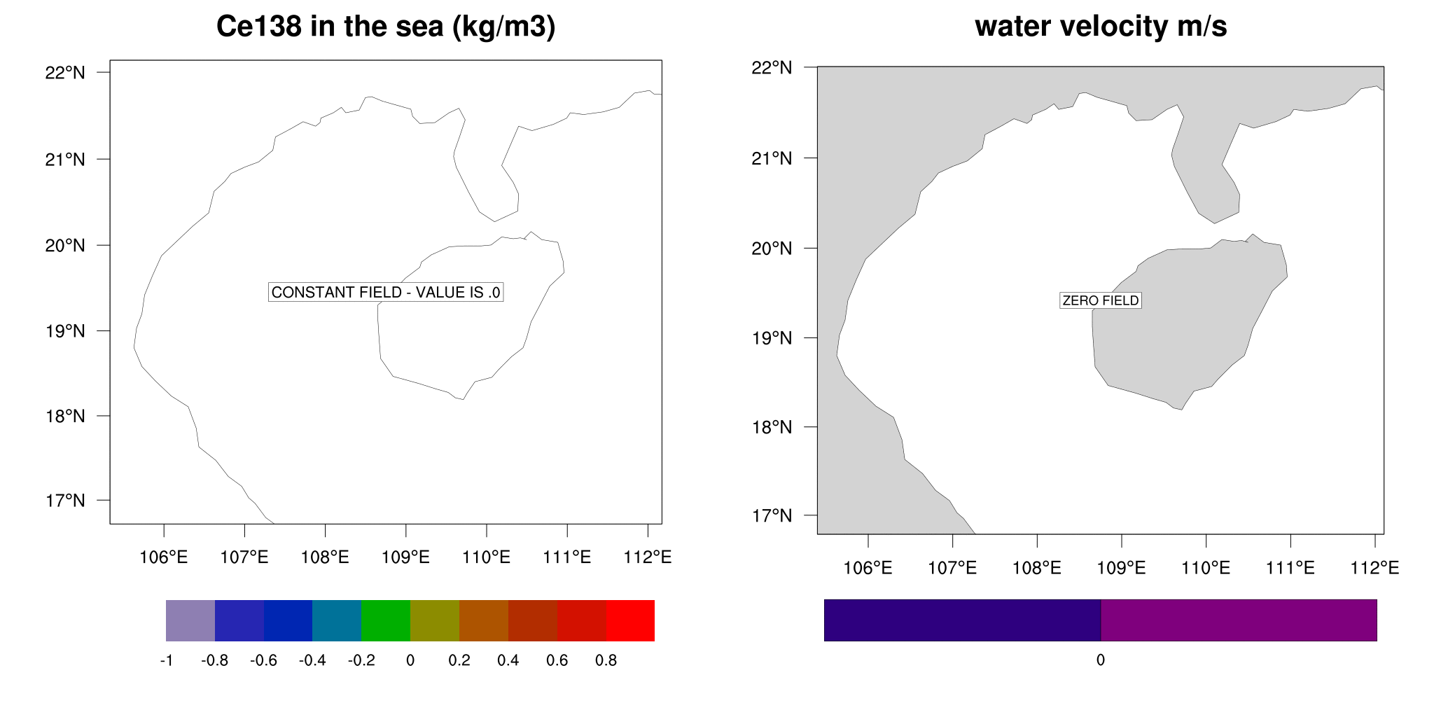

I have the thing done with interesting and nice .gif file results of concentration in minus, continuing find-out why.
