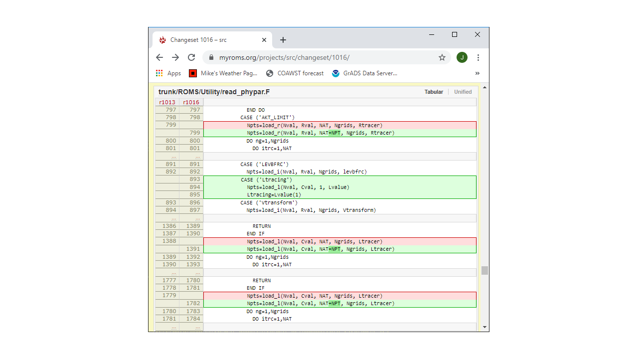

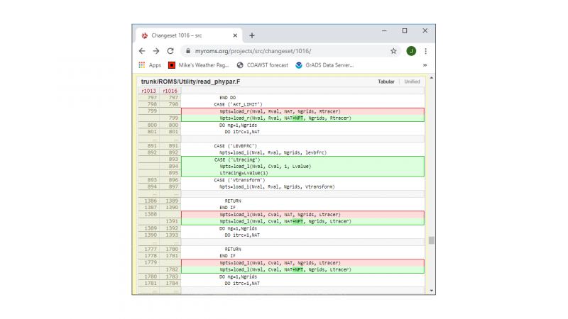

this just got added in the last src ticket 850. Think it could just be commented out for now:
CASE ('Ltracing')
Npts=load_l(Nval, Cval, 1, Lvalue)
! Ltracing=Lvalue(1) <---line 895

I actually removing that parameter in an update that I am releasing today. Remove the couple of ocurrences of Ltracing in read_phypar.F. I have several reseach repositories and sometimes unwanted features leaks into the trunk. Sorry about that.
