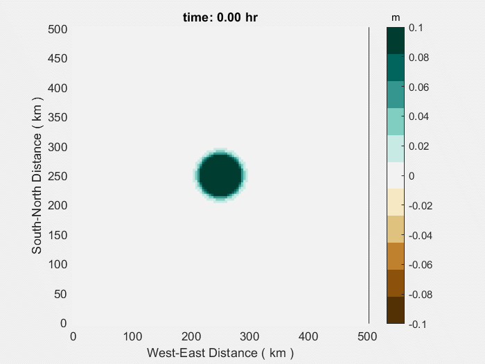

I have done some tests to investigate the performance of various open boundary conditions available in ROMS. The setup of my simulation is pretty simple, which starts with a Gaussian-shaped mound that collapses at t0, which generates outward-propagating surface waves. There is no stratification, and a constant Coriolis coefficient at 46-degree N is used. The goal of this test is to investigate the ability of an open boundary condition to let outward propagation of wave-like disturbances through the boundary with minimal reflection.
I have tested five different boundary conditions, which are: closed (clo), zero gradient (clo), zero gradient plus nudging layer (gra_nudclima), radiation (rad), and radiation plus nudging layer (rad_nudclima). In this idealized case, there is no external solution so the nudging layer simply forces the internal solution to approach zero towards the boundary. For the radiation condition, I turned on the 'radiation_2d' cpp flag so that the phase velocity has a tangential component.
For an ideal boundary that is 100% 'transparent' to the interior, one should expect to see zero reflection of those outward propagating waves. As you can see, among the five boundary conditions, closed and zero-gradient lead to full reflection. In comparison, the radiation boundary condition alone has much reduced reflection. Adding the nudging layer further absorbs the reflected waves and the radiation plus nudging condition generates the least amount of reflection.
In summary, the combination of radiation condition and nudging layers seems to work the best for letting perturbations through a boundary while minimizing the reflection. I am thus wondering if this is what is most commonly used when forcing a regional simulation with external climatology at open boundaries.

these look really cool! there has been a good bit of work on roms open BC's. i have not looked into the details in a while. here are some thoughts:
-if you go here:
https://www.myroms.org/wiki/Boundary_Conditions
you can get a good paper :
Marchesiello, P., J. C. McWilliams, A. F. Shchepetkin, 2001: Open boundary conditions for long-term integration of regional ocean models, Ocean Modelling, 3, 1-20. (PDF)
-how about doing test with no coriolis.
-if this is just ubar/vbar/zeta, what about Flather?
-what do you set for the 3D bc's? they might have an effect even for just a barotropic wave propagation.
- when the center of the mound reaches zero, it looks like it overshoots in the middle and create a pressure gradient back into the domain? will this draw a flow into the domain?

Because you don't have stratification, you are mostly testing the barotropic OBCs. You should try both the Chapman/Flather combo and the Sch option (described in a Mason et al., 2010 paper).
Flather is known to work pretty well for the barotropic mode. What's more challenging are the baroclinic signals.

Thanks a lot for both of your replies. My simulation is essentially barotropic but the setup is in 3D with the cpp flag 'SOLVE3D' on. I did that because the 2D mode did not work due to a bug in the source code, which has been fixed by the developer. I will try the other conditions that you recommended and see how it works. I will post the new results once they are ready.

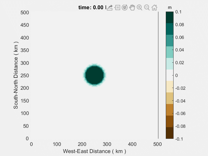

I have done a couple of more tests. As Kate said, the Chapman+Flather and Chapman+Shc combos both work better than the radiation boundary condition+nudging. I have attached the new animations that show almost zero reflection from the boundaries. My nest step to add stratification and do some 3D tests. So should I keep Chapman+Flather or Chapman+Shc for 2D variables and use radiation+nudging for 3D u,v, t, and s?

Yes, exactly.So should I keep Chapman+Flather or Chapman+Shc for 2D variables and use radiation+nudging for 3D u,v, t, and s?

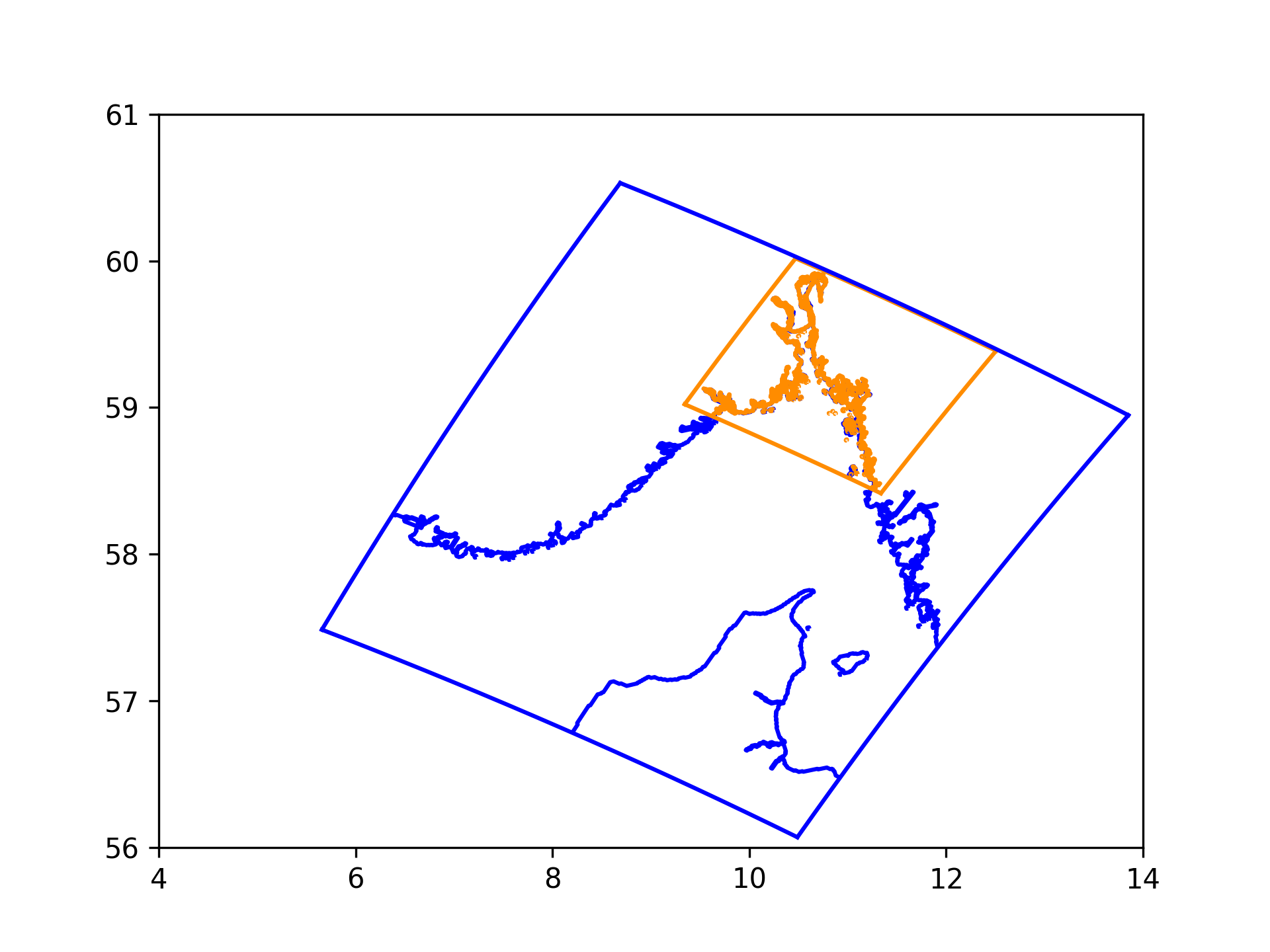

Here in Norway we have implemented the so called Flow Relaxation Scheme (FRS) in ROMS, which includes the possibility of one way nesting. As an OBC it works more or less like a sponge. We have also tested the Mason et al. (2010) method with some success. Likewise we have recently implemented the two way nesting advocated by Debreu and Blayo (OM, 58, 2008) into ROMS for an application covering the Skagerrak (North Sea) with a high resolution Oslofjord model embedded which appears to work well (see attached gif file showing salinity and png file showing the two model domains).
If of interest an overview of various OBCs including one-way and two-way nesting techniques may be found in my recent textbook (Chapter 7, Pages 159-182) referenced below.
