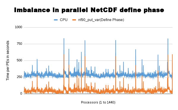

I have investigated the imbalance further within nf_fwrite2d.F and here are the results ---
Figure 1:
Figure 1:
Imbalance in parallel NetCDF define phase.png (29.74 KiB) Viewed 1967 times
Figure 1: Further Parallel writing Imbalance analysis
Observations and Conclusion:
1.The imbalance is flowing as below... -- The imbalance is found in nf90_put_var calls inside nf_fwrite2d.F function during define phase.
Total CPU time ==> Output time ==> Define file ==> Wrt_Info ==> nf_fwrite2d.F ==> nf90_put_var [Further result.] [Check Figure 1]

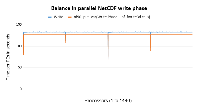

2. nf90_put_var inside nf_fwrite2d.F during define phase calls are imbalanced and taking significant time [Check Figure 1] whereas nf90_put_var inside nf_fwrite2d.F during write phase are balanced and taking insignificant time. [Figure not included as insignificant]
3. nf90_put_var inside nf_fwrite3d.F during write phase are balanced and taking significant time. [Check Figure 2]

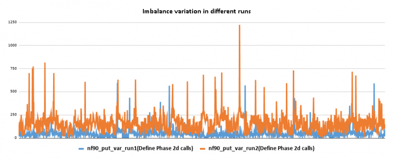

4. With different runs with exactly same setup, the imbalance pattern is changing. -- Overshoots are happening in different PEs. [Check Figure 3]
