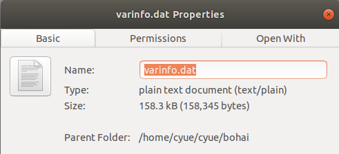

Thank you, Kate! I have replaced varinfo.dat with the one in your Apps repository. But another error happened:
 GET_GRID - unable to open grid NetCDF file: wtype_grid
 GET_GRID - unable to open grid NetCDF file: /home/cyue/cyue/bohai/data/bohai24.nc

Are you sure that the grid file is at /home/cyue/cyue/bohai/data? It looks like your username (cyue) is doubled in there.

Thank you, but I think the path is right. And I have modified the grid NC file already, last time the error is that it can't find 'xl' in the grid NC file, then I added it to the NC file.
