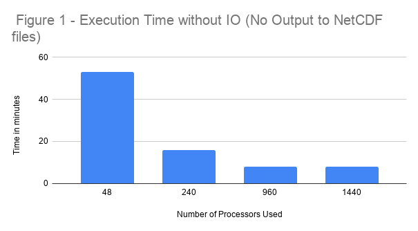

1. When I am not writing any netcdf output file , I observed the model is scaling upto 960 processors(PEs) only.Any reason for that?
(Strong Scaling Results -- Varing PEs with fixed problem size).
[Reference -- Figure 1]

- Figure 1 - Execution Time without IO (No Output to NetCDF files).png (11.07 KiB) Viewed 34041 times

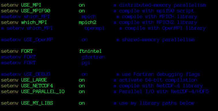

- Build.sh_setting.png (49.63 KiB) Viewed 34041 times

1. I think my results are consistent with your observations when IO is turned OFF in my case.(For my experiment, it is scaling to in between 1000 to 1400 PEs as in Figure 1).
But the scalabilty issue is coming in case the IO is turned ON.(Same model is scaling only upto 240 PEs.)

Re: Parallel IO not scaling over Serial IO for ROMS
Please find attachec the gbplum.h filerobertson wrote: Fri Dec 06, 2019 9:27 pm Please attach your gbplume.h file where your chosen CPP Definitions are set.
Please let me know if something need to be added as I am new to ROMS.
I think my PARALLEL_IO is not turned on properly although I have turned on USE_PARALLEL_IO in build script.
