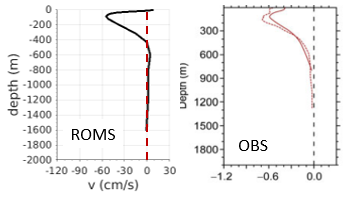

I have a problem on my vertical profile of velocity in almost all area in my model domain. The vertical profile of meridional velocity has a counter current below the thermocline layer. I can sure the initial condition of T and S is quietly good. In the initial simulation, the velocity profile is good enough. But longer the simulation, the counter current is developed. It is really different to the annual mean of observation data at the same area. I attached the example of figure below in my attachment.
I need some suggestion, anything might induce this counter current flow. Thank you so much.

I faced a similar issue in my application. The problem occurred only in the slope region where the bathymetry was steeper.
My suspicious at the time was that a strong Ekman layer was being formed, inducing a change in velocity direction. So I gradually reduced the bottom drag (if using UV_QDRAG, reduce RDRG2 parameter in ocean.in), in order to overcome this issue.
Another possibility is that your initial thermohaline gradients are being smoothed along the simulation due to excess of numerical diffusion. Maybe switching to a less diffusive tracer advection scheme, such as Akima 4th order (TS_A4HADVECTION, TS_A4VADVECTION) or the 3rd-order upstream split advection (TS_U3ADV_SPLIT along with UV_U3ADV_SPLIT) with a corresponding adjustment of explicit diffusion coefficients and time step, could help.

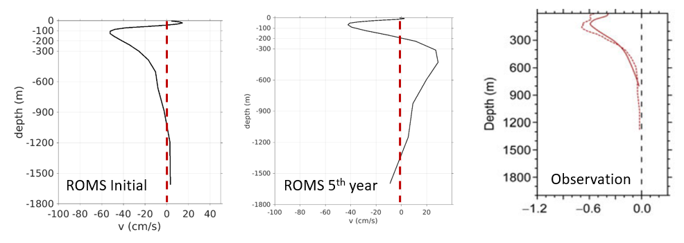

I used this CPP and somehow there is some improvement on the vertical structure of velocity. However, it still needs more improvement. I will try to reduce the bottom drag coefficient in future simulation.
I did try to use TS_A4HADVECTION, TS_A4VADVECTION with UV_ADV and UV_C4ADVECTION but it leads on blowing up within several months of simulations due to a discontinuity on Temperature and Salinity. Is it need a smaller timestep to use Akima horizontal and vertical advection? Or any other things should be considered?

I would try first to adjust horizontal diffusion. In my case, no time step reduction was necessary; an increase in nl_tnu2 did the job.I did try to use TS_A4HADVECTION, TS_A4VADVECTION with UV_ADV and UV_C4ADVECTION but it leads on blowing up within several months of simulations due to a discontinuity on Temperature and Salinity. Is it need a smaller timestep to use Akima horizontal and vertical advection? Or any other things should be considered?

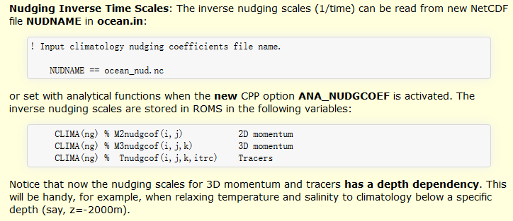

Dear Kate, I read this from https://www.myroms.org/projects/src/ticket/627. I want to ask:kate wrote:If you turn on climatology nudging, it will change the OBC time scales. If you don't want that, change the open boundary code to do what you want it to do - that's what I did in my branch.
1. How to set the depth dependency for nudging to climatology (as it said in the website)? Or we should create the nudg_coef by ourselves using Matlab?
2. If I want to relaxing the surface temperature and salinity to climatology data, how can I do it? I confused because the nudg_coef is based on the s-coordinate. And it's mean that the surface layer has a different depth for every single grid cell.
Re: how to improve vertical profile velocity
1. Probably easiest in Matlab or something with similar capabilities, something that knows the vertical coordinate system.
2. If you only want to nudge to surface T/S, there is separate code for that as part of the surface boundary condition. Check out for instance SCORRECTION and SRELAXATION, using Tnudg(isalt,ng) which does not vary in space.
