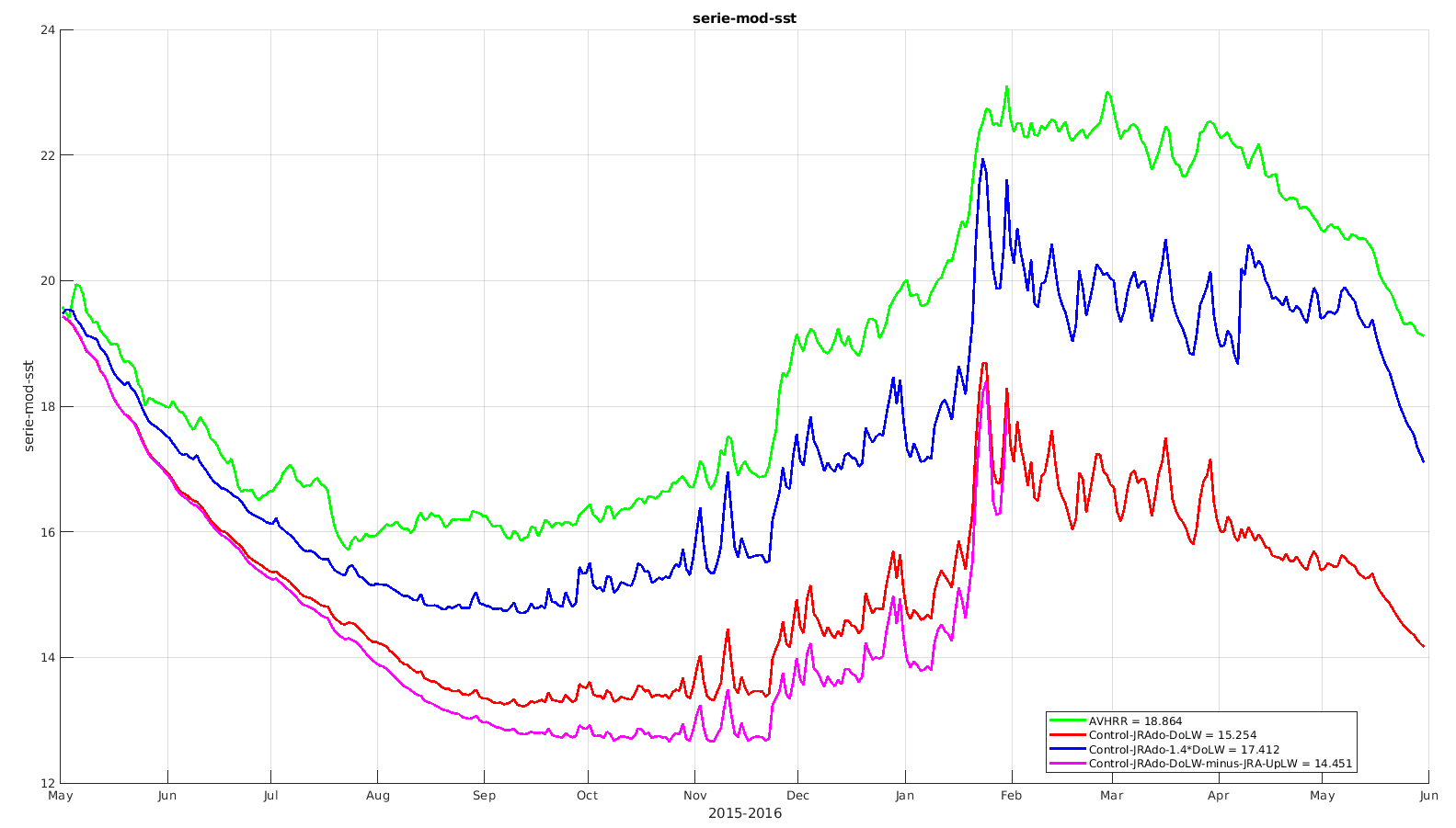

The dataset does not have upward shortwave and longwave fluxes. Therefore, I'm using the option LONGWAVE_OUT in ROMS. This simulation (red line in Figure 1) had colder temperatures than AVHRR SST in waters deeper than 200m (green line in Figure 1).

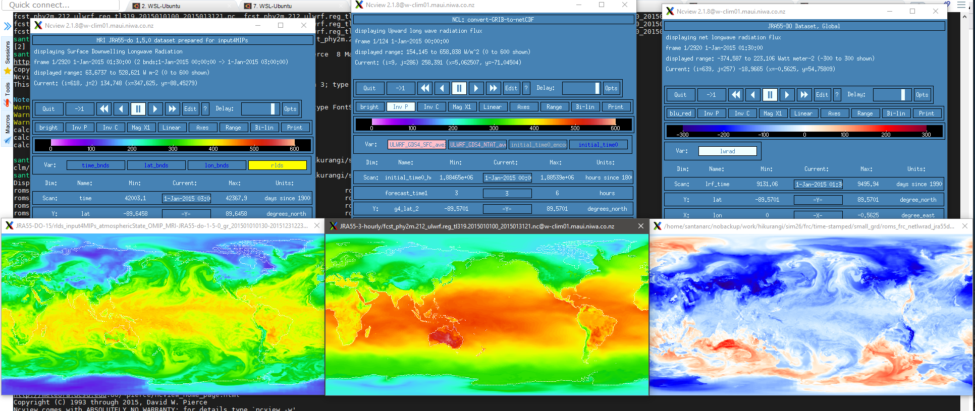

I tried running without the option LONGWAVE_OUT and computed net longwave radiation (red and blue shade in Figure 2) by subtracting upward longwave radiation (from JRA55) from downward longwave radiation (from JRA55do). The results showed even colder temperatures (blue line in Figure 1) (the model still running).
One of the corrections applied to downward longwave radiation in JRA55do was the multiplication by a factor of 1.1 around New Zealand (https://doi.org/10.1016/j.ocemod.2018.07.002). I applied a similar correction using a factor of 1.4 and ran an experiment defining LONGWAVE_OUT (pink line in Figure 1). Is the correction factor of 1.4 feasible? Or should I try different options in ROMS (cppdefs used below)?
