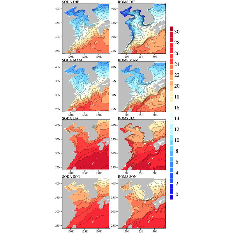

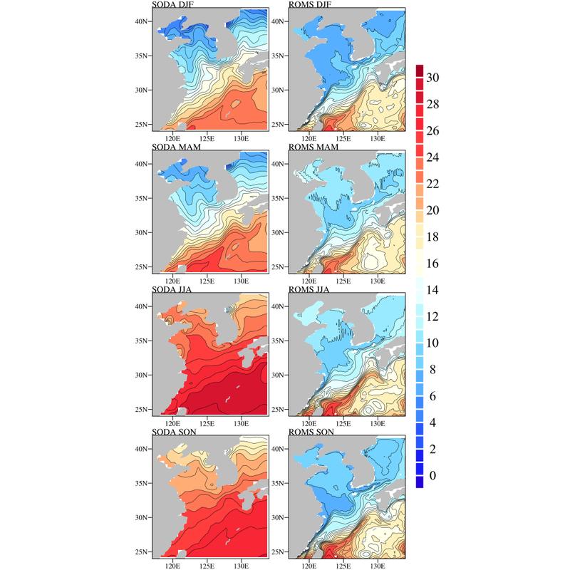

At first, I used Forcing Flux input files to simulate my model. Comparing with SODA Climatology, The temperature results are not so good(shown below).
Then be advised to using Bulk Flux input files, I open #define BULK_FLUXES in .h files. The result in the first month is close to SODA, but it gets worse in following months gradually(shown below).
Expect for #define BULK_FLUXES, what else cpps should I define?

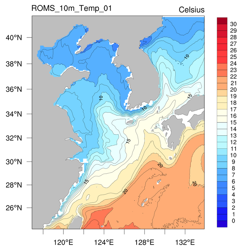

temperature seasonal distribution for bulk flux output
the first month result for bulk output
temperature seasonal distribution for forcing flux output
