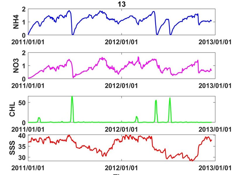

Result of 3 m as min depth

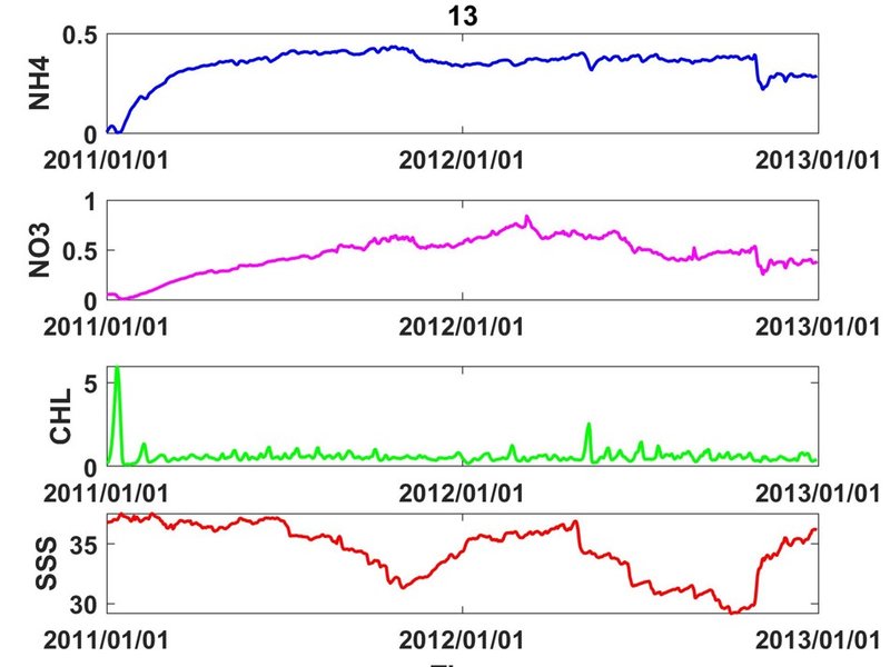

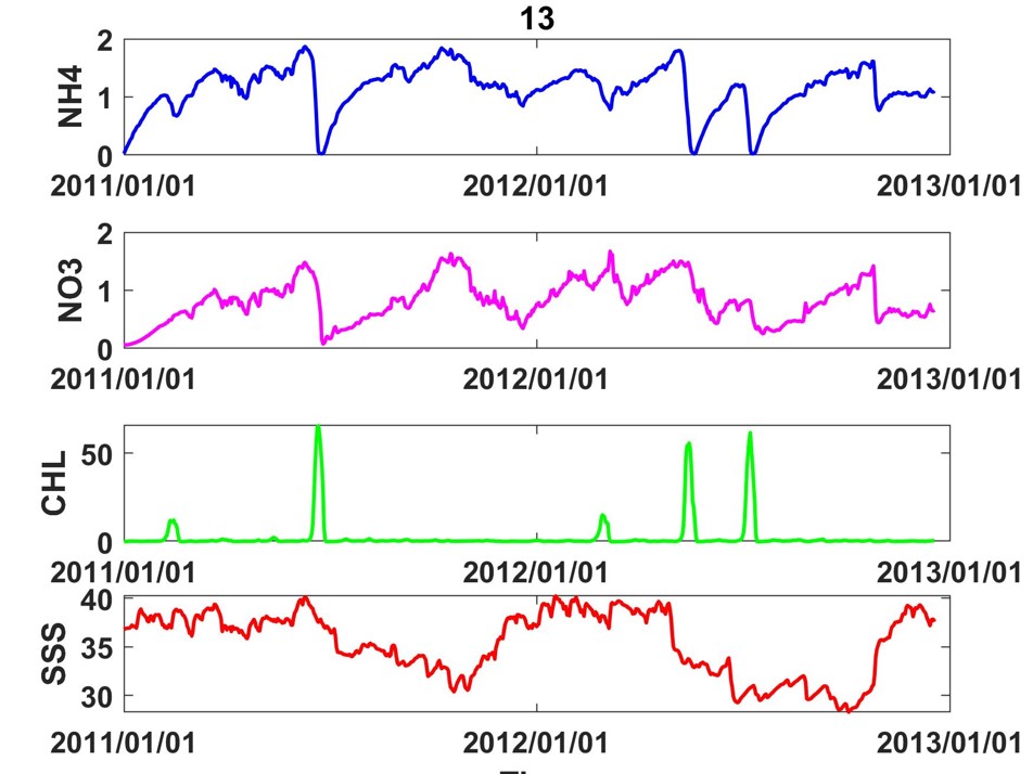

Result of 1.5 m as min depth

Re: Fennel model nutrients accumulate in lower minimum depth
#2 Unread post by kfennel »
Looks to me like the change in your grid file affected the circulation in your shallow bay with longer flushing time leading to more trapping of nutrients. Note that your salinity has changed as well.
