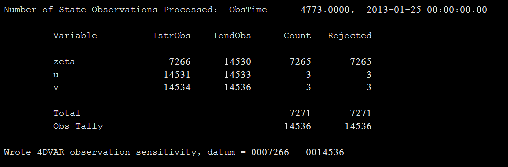

The obs number accepted in the model would change with the number of STD threshold when the BackGround Quality Control in terms of obs provenance in i4dvar.in, but all obs were rejected in I4DVAR_impact step:
Number of State Observations Processed: ObsTime = 4773.0000, 2013-01-25 00:00:00.00
Variable IstrObs IendObs Count Rejected
zeta 7266 14530 7265 7265
u 14531 14533 3 3
v 14534 14536 3 3
Total 7271 7271
Obs Tally 14536 14536
Wrote 4DVAR observation sensitivity, datum = 0007266 - 0014536
The BGQC is same with the assimilation and this situation doesn't change with the STD threshold.
