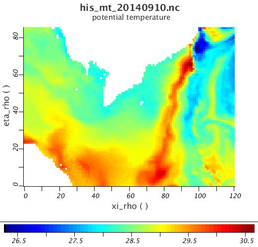

I run for real domain in East Sea of Vietnam with resolution of 9 km, 12 vertical layers.
+ Oceanic variables including temperature, salt, zeta, u and v getting from HYCOM.
+ All atmospheric variables including 'Uwind','Vwind','Pair','Tair','Qair','rain','swrad','lwrad','bhflux','bwflux','swflux'..are set 0 (no interaction with atmospheric)

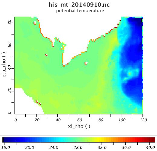

However, just after 0.5 hour of simulation, temperature significantly increase only near land areas (Fig.0.5 hour. jpg). It is quite weird.
(even, I ]provide real atmospheric variables after running from WRF, temperature still significantly increase only near land areas)
Could you give me any comments?
Temperature significantly near land areas
- 0_hour.JPG (42.66 KiB) Viewed 6972 times

a couple of things jump out here.
- first it is best to put temp scales the same so we can see the differences.
- second it seems a lot of cooling on east side, looks like a BC issue.
- for the temp spikes near land: how is wrf data interpolated to roms grid? we had issues with the coupling at first, but then realized that wrf heat and momentum fluxes on land can not be used to interpolate to the ocean. The wrf and roms land/sea masking is most likely different, so you have to use only wrf ocean points to interpolate to roms.
- when you have atm fluxes to 0, do you nudge to hycom data ? how is hycom data interpolated to roms grid?
-john
