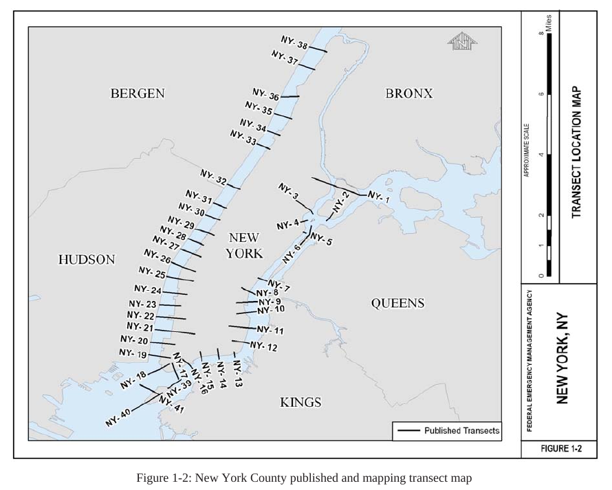

I should add that an example for the 1D transects can e.g. be found on page 25 in:
Federal Emergency Management Agency, 2013: Flood Insurance Study (preliminary). City of New York, New York.
https://hazards.fema.gov/femaportal/pre ... odId=16353
This publication should be in the public domain, so I might as well post the figure here.

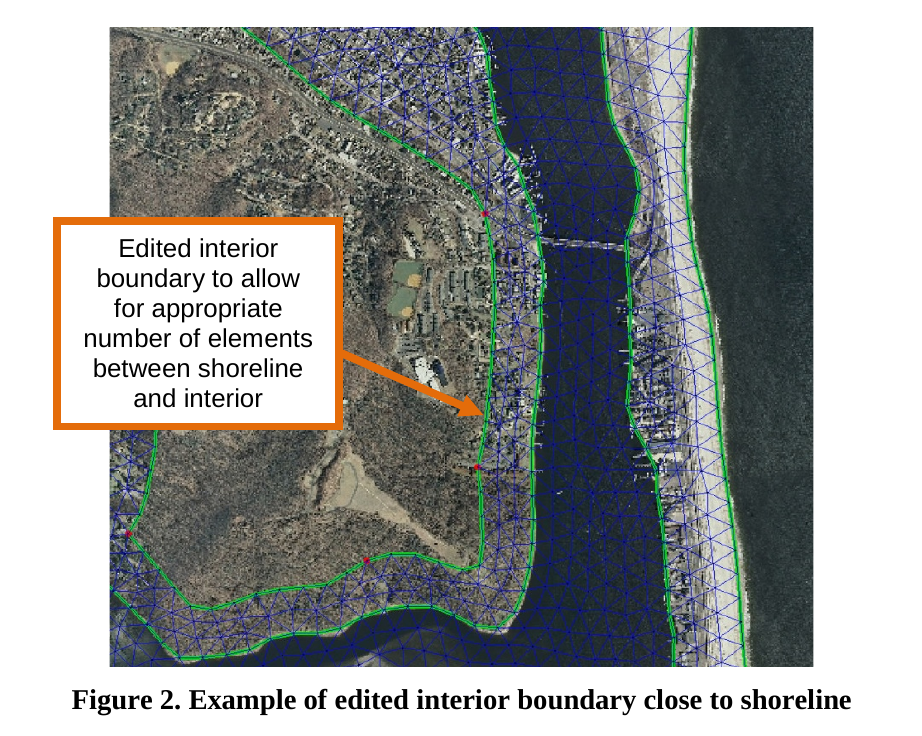

I'm also attaching a figure that shows the inland grid of ADCIRC for the intermediate step. This is from page 4 of:
Federal Emergency Management Agency: Region II Storm Surge Project - Mesh Development
https://data.femadata.com/NationalDisas ... opment.pdf
