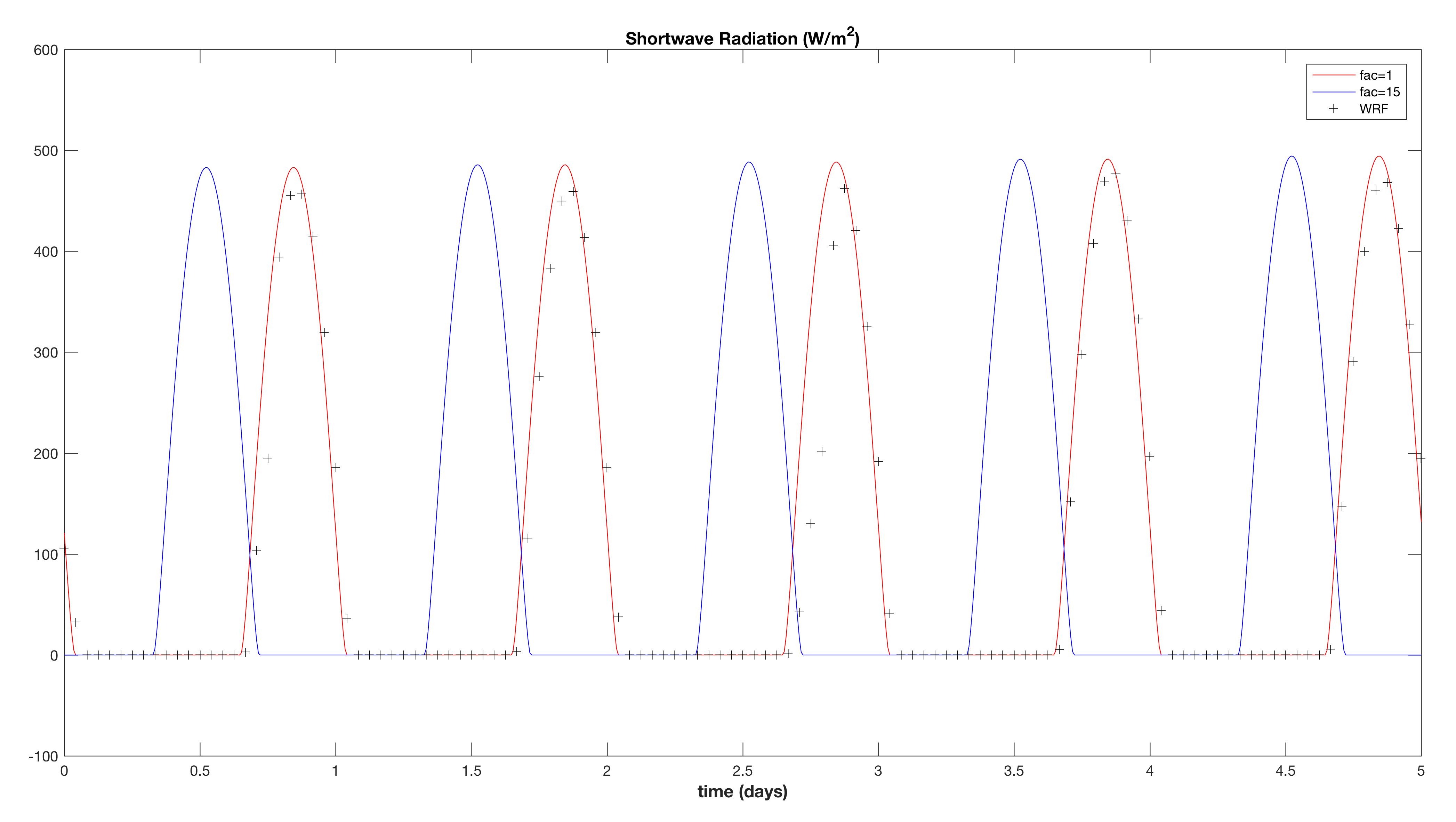

Finally, I have time to browse the literature, Googling, and write a Matlab script to check the issue mentioned above. Indeed, the 15.0 factor used to compute the zenith is incorrect :!: We need to have instead:
        zenith=cff1+cff2*COS(Hangle-lonr(i,j)*deg2rad)
In my Matlab script, I compared against a WRF-ROMS coupled solution for the US West Coast at a particular point in the grid:
Here, the X-axis is the time since initialization and it is in GMT time zone. We need to subtract 8 hours for local Pacific Standard Time (PST) to analyze the results. As you can see, the WRF-ROMS coupled solution values agree well with the red curve that computes zenith with updated above equation. I am now satisfied that I proved to myself that it is a bug.
Many thanks to all that brought this bug to my attention.
