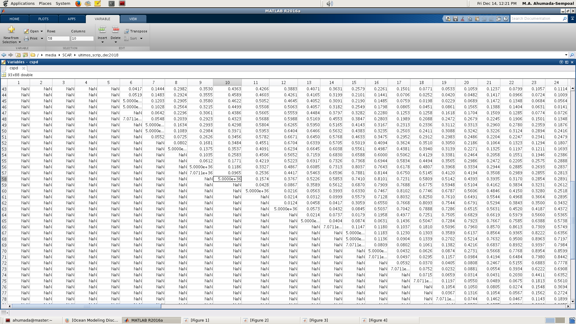

My model blown up at 55 days, apparently the cause is near the coast...
the history file has very high water speed values (example 5x10^36).
This is a part of the matrix, where you can appreciate the extreme velocity values near the coast
Does anyone have any suggestions, how to correct this?
Thanks in advance.

I don't have problem with zeta, rho, temp, salt, etc... but sustr, svstr, u and v have values of the order 5-7e+36. Is possible that this was a mask problem?
Is this would cause that the model blow-up? Taking into consideration the following:
"At the end of every time step, the values of many variables within the masked region are set to zero
by multiplying by the mask for either the u, v or ρ points"
I also attachment the logfile
out_hmin10_Nclose.txt
(24.18 MiB) Downloaded 561 times
Thanks in advance.

For the values of high stress and currents - if you ncview the his file, are those high coastal values there for a long time?
There aren't values of high stress and currents, the 5-7e+36 value is the FillValue.
