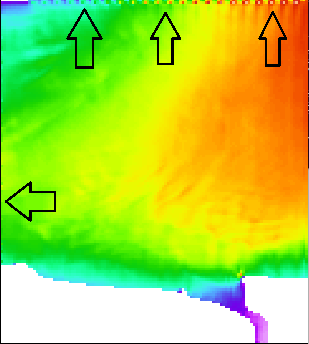

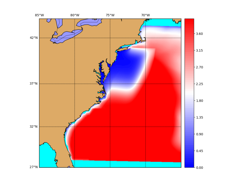

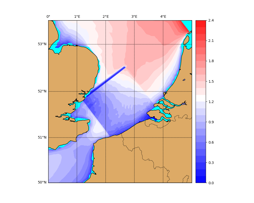

Dear ROMS users,
I run ROMS + SWAN in coupling using MCT library on two grids, one inside of another, in two way nesting.
I'm sure about the wave results on the coarse grid. However, the fine resolution grid does not behave on the way I expect it.
Here is a picture of the significant wave height on the coarse grid with superimposed resuls from the fine grid. I clearly see:
1) There is a masked area on the right boundary of the fine grid.
2) Also, the upper boundary seems to not function at all, even it is open
Could you tell please, from where does this error probably come from? Does it come from the wrong scrip interpolation? Or I defined something wrong in the swan.in ?
I tried to play with time steps, as well as several times checked grid dimensions in swan input files, verifying them with the Sandy test case, and still did not spot an error.

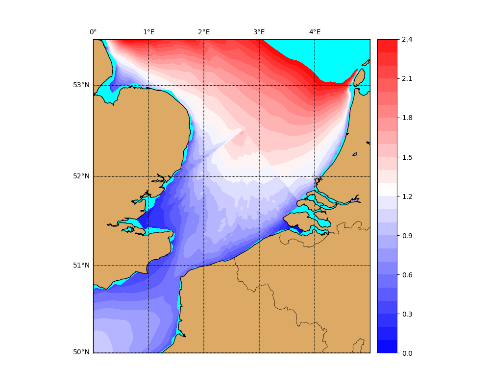

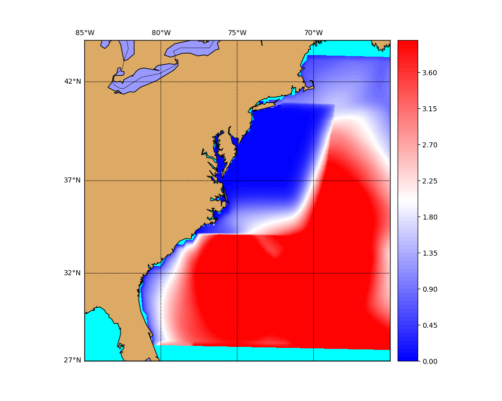

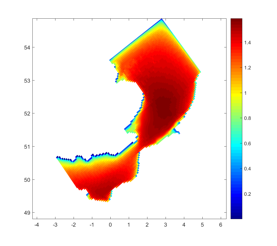

Dear John,
1) SWAN only (results after 5 days):
3) If I run the coupled system, after 4 days on the SWAN grids (.mat) the results look like this:
Probably due to ROMS results in netcdf look like this:
The blue straight line corresponds to the 'zero' area along the child grid boundary.
Colorbar = wave height in meters.
Evgeny Ivanov

#12 Unread post by Eugen »
Yes, sure
Coupled system: ROMS results
Coupled system: SWAN results
Swan only
Swan only

I've decided to make an experiment.
I've turned both grids of the Sandy test-case on 180 degrees. Then, I've created .grd and .bot files and have run SWAN (without coupling with ROMS). And then I've compared it with the run on the normal (non-reversed) grid.
I've switched off the winds on the child grid to show clearer the information transfer between both grids.
Here are the results.
Neither Northern, neither Southern boundary seems to function properly in the "reversed run".
I do remember that SWAN does not like angles, but the parent grid runs normally, so I had decided to forget about this issue.
By far my grid is turned on 120 degrees, so I would expect the same kind of problem.
I'll turn my grid to something in between 0 and 90 degrees and tell you the results.
Sandy: both grids are reversed on 180 degrees (SWAN only)
Sandy: normal run (SWAN only)

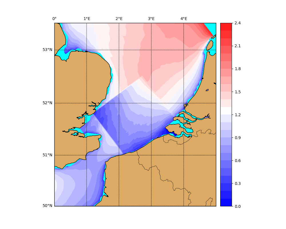

John,
The SWAN itself works fine now. But, coupled with ROMS, the nested grid gives a weird numerical error along the upper boundary.
It is not deadly anymore, but it is definitely a patch to be eliminated.
Could you guess please, why does it appear?

#21 Unread post by Eugen »
John,
Unfortunately, I didn't succeed to eliminate this error while playing with the ROMS time step, nor with the SWAN time step or with the coupling time step.
Could it be due to a mask mismatch? I made some significant changes in the mask inside of the domain (not in the contact point layer). But fields of any other variables, except of the wave ones, are perfectly fine and continuous. :?
Evgeny Ivanov
PostDoc,
MAST, University of Liege, Belgium
Posts: 1222
Re: ROMS + SWAN with nesting : error on the child grid
#22 Unread post by jcwarner »
can send to me the scrip file you used to create the scrip weights?
and are the grids the same size for the parent roms/swan and the child roms/swan?
you need to make sure you enter the swan grid sizes correctly.
