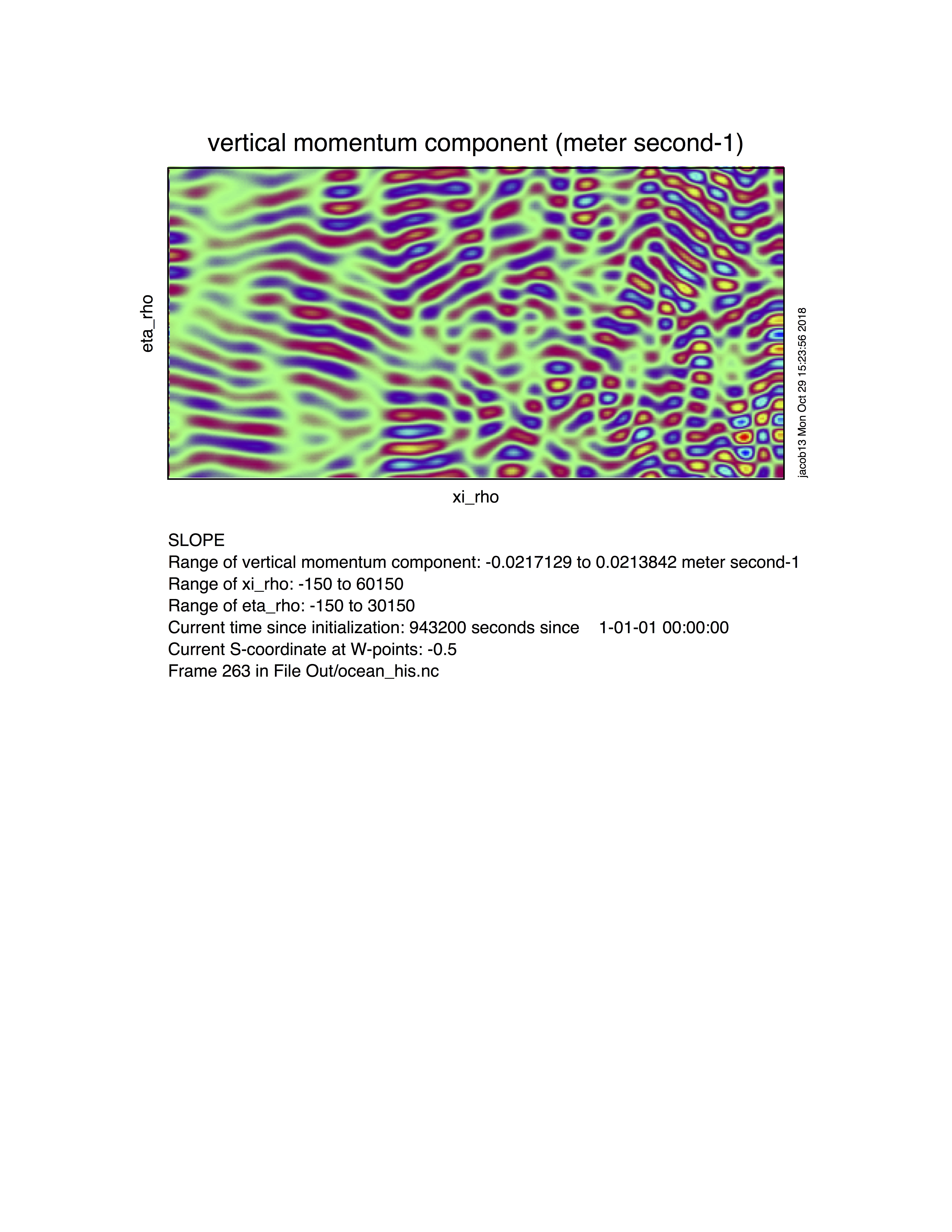

- vertPlanView.ps
- Plan view of vertical velocity at sigma=0.5 after approximately 10 days.
- (491.05 KiB) Downloaded 464 times

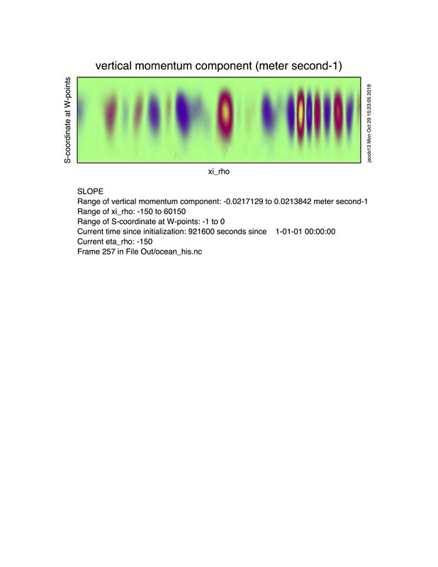

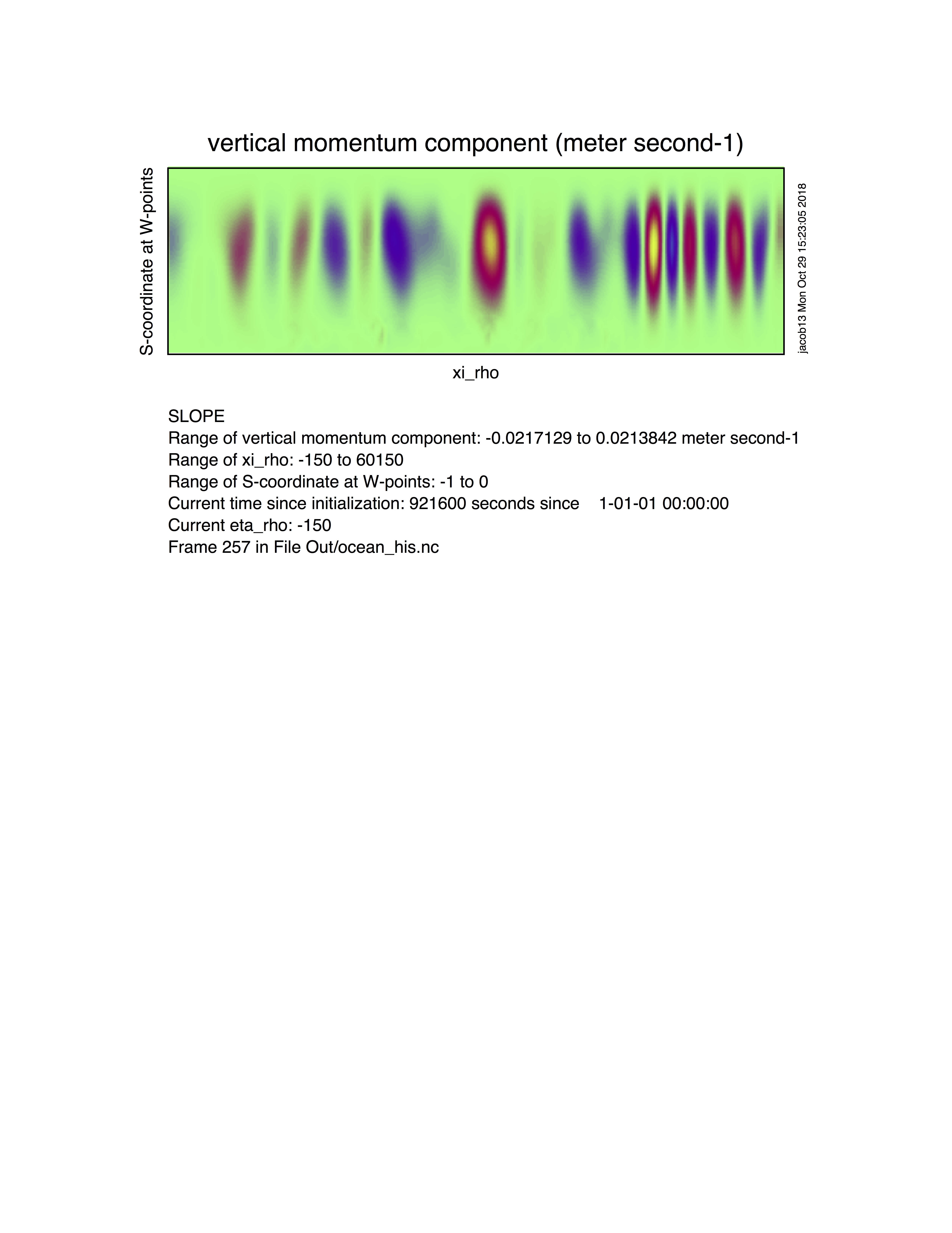

- verticalvelocity.ps
- Slice in the x-sigma plane of vertical velocity after approximately 10 days.
- (294.27 KiB) Downloaded 496 times

Sorry about the .ps files, attached here as jpegs. These are just quick plots from ncview, but it gives the general picture.
In terms of domain size it is 200 x 100 x 60 (NX, NY, NZ). The uniform vertical grid case I tried was NZ=250.
