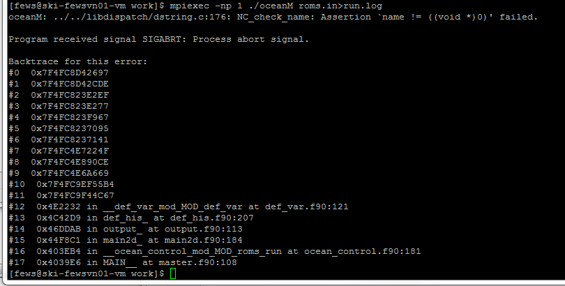

I have just tried re-running the model with the main trunk version of get_wetdry.f and with NRREC = 0. Unfortunately the model still crashes, I've attached the new run log and the errors which are printed to screen. Is there anything else I can try please?

So what is on line 207 of def_his.f90?
Re: Error reading wetdry mask at psi points
Does you varinfo.dat have the metadata for the psi points wet/dry mask? Line 270 of def_his.f90 will be pretty close to the step defining the mask, for which it needs the Vinfo data leaded fro varinfo.dat.
