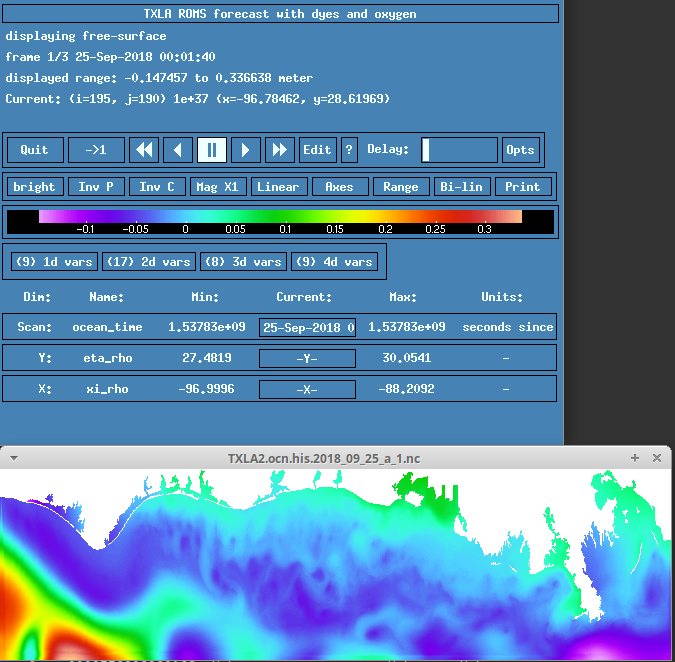

I added two ncview snapshots and see the 1st on includes initial fields (NHISSTR==0), and the other doesn't (NHISSTR==1). It seems to be working. It's a subtle thing and possibly nobody cares, but it is kind of important to me as I need to aggregate nowcast and hindcast with NCO/CDO and on THREDDS. And Python Xarray hates duplications...
-DJ
a snapshot with initial fields
a snapshot without initial fields
