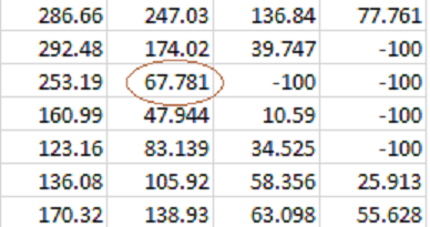

I'd like to post an update on this problem, after trying out some of the suggestions. First, after checking the log file, I found that the blowup occurs at a grid cell which is at the westernmost tip of an island, and at the surface level (NaN values appear). The depths in the immediate area are shown in the following figure, where the problem grid cell is indicated:
I have tried a bit of smoothing in this area, but the blowup still occurs, and at the same time step and location. I also tried the k-omega and gen settings for GLS, as well as switching on MIX_GEO_TS instead of MIX_S_TS, and the same problem occurs. However, when I set it up to use k-kl, the model is able to continue running. For reference, here are excerpts from the respective log files:

if the closure is making it unstable, then look at temp, salt, u, v, and AKv and AKt. perhaps the options of
#define LIMIT_VDIFF --> use to impose an upper limit on vertical diffusion **
#define LIMIT_VVISC --> use to impose an upper limit on vertical viscosity **
might help ???
Also, when the depth is -100, are you using wet/dry? are those cells land masked?
I see you have wet/dry on. that option was not really designed to function in a setting where the bathy goes from 60 to -100. it is more for a nearshore tidal setting. So if you are using wet/dry to just remove points that are -100 (above sea level) i would suggest you use land/sea masking instead and just make the -100 values to be 5 (or something) annd just mask them out.

Thank you for your reply Dr. Warner. I have wetting and drying turned on, but the cells with a -100 are part of the permanent land mask. Even so, will it be useful to still change the value to something like 5 or so? But anyway, I did try to turn off WET_DRY, but the model still blew up, and at a different point and sigma layer this time. And this point is not adjacent to a land cell, which makes me think that I could still do more to maybe smooth the bathymetric features. Might you have any suggestions on some tools to help facilitate this? So far, I have tried the Shapiro filter matlab script included in the ROMS matlab folder and even the QUICKIN module of the Delft3D modelling system, but I feel they are not working well since I still could mostly not get the recommended rx0 and rx1 whenever I run the model. Or if I do, it would be for a bathymetry smoothed in such a way that some of the real features are no longer recognizable.
Indeed, you show neighboring points with rx0 of almost 0.58, which is larger than I like to go. To go from 60 m to 250 m in that distance, you need another grid point in between to keep the r-values down.

Thanks for your thoughts on this Kate. I don't think I mentioned in on this post, but the grid cell size is 1.5 km on a side. But indeed, I guess I'll have to consider using more resolution. I've also come across your bathymetry tools on GitHub, which I would like to look into more, even if I'm not a Python user. Might be worth my while to learn the language.
