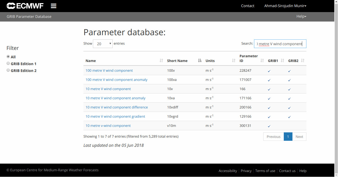

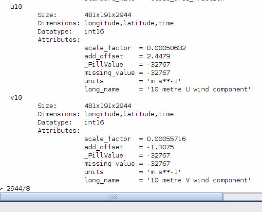

Hello,i am new with ROMS. Try to build model with wind component. I use tool d_ecmwf2roms.m
This script say to download v10u and v10v. but ECMWF does not have this type.
so i use 10v and 10u.
1. can i use wind components with both of this? do i have to change variable names?
2. i'm litle confuse about ROMS base date.
mybasedate = datenum(2000,1,1,0,0,0); at this line, do i have to change to 1900-01-01?

The variable names for the winds don't matter - just match what is in your varinfo.dat to the the names in the files.
The time origin doesn't matter either, as long as you are consistent among all your inputs and you don't ask ROMS to have a negative time. Starting in 2000 is fine for all recent years, but not fine if you start in say 1980.
