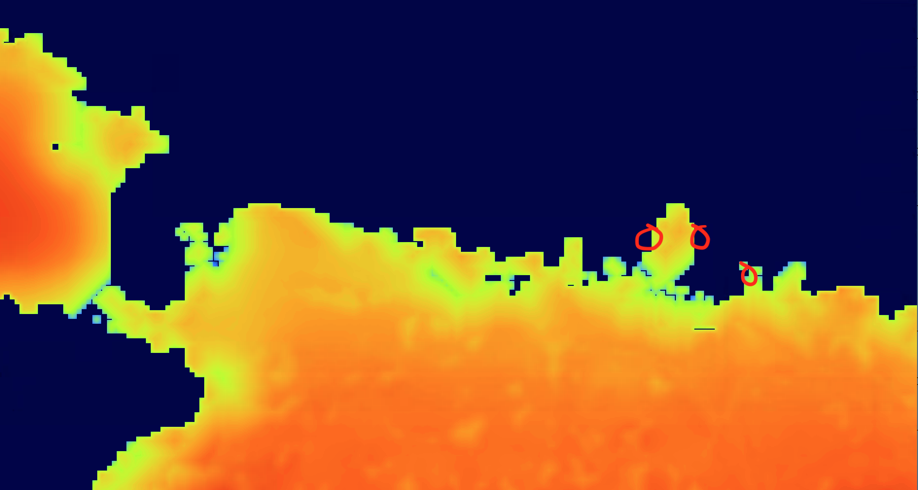

However, I am finding continued issues near the coast just before the simulation ends. What’s strange is that my model is consistently blowing up when the typhoon is weakening near the end of my simulation (a few hours after landfall). Furthermore, every time a blow-up occurs I look at the affected area, try to re-grid it (maybe fill in more of the land/reduce it, etc.), re-smooth (via LP Bath smoothing) and my re-run still blowups, now in a slightly different along the coast. For example, here are the locations of some of the affected areas thus far.

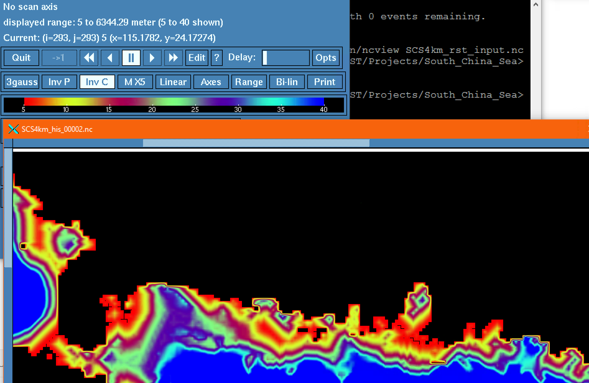

All these islands and channels are proving to be very challenging! For instance, check out the bathymetry (scale for the figure below is in meters)! I think the LP BATH smooth algorithm is actually struggling to produce something sensible here (with strange square block-type pyramids) but to my understanding I think it's about the only and very best smoothing option I out there!

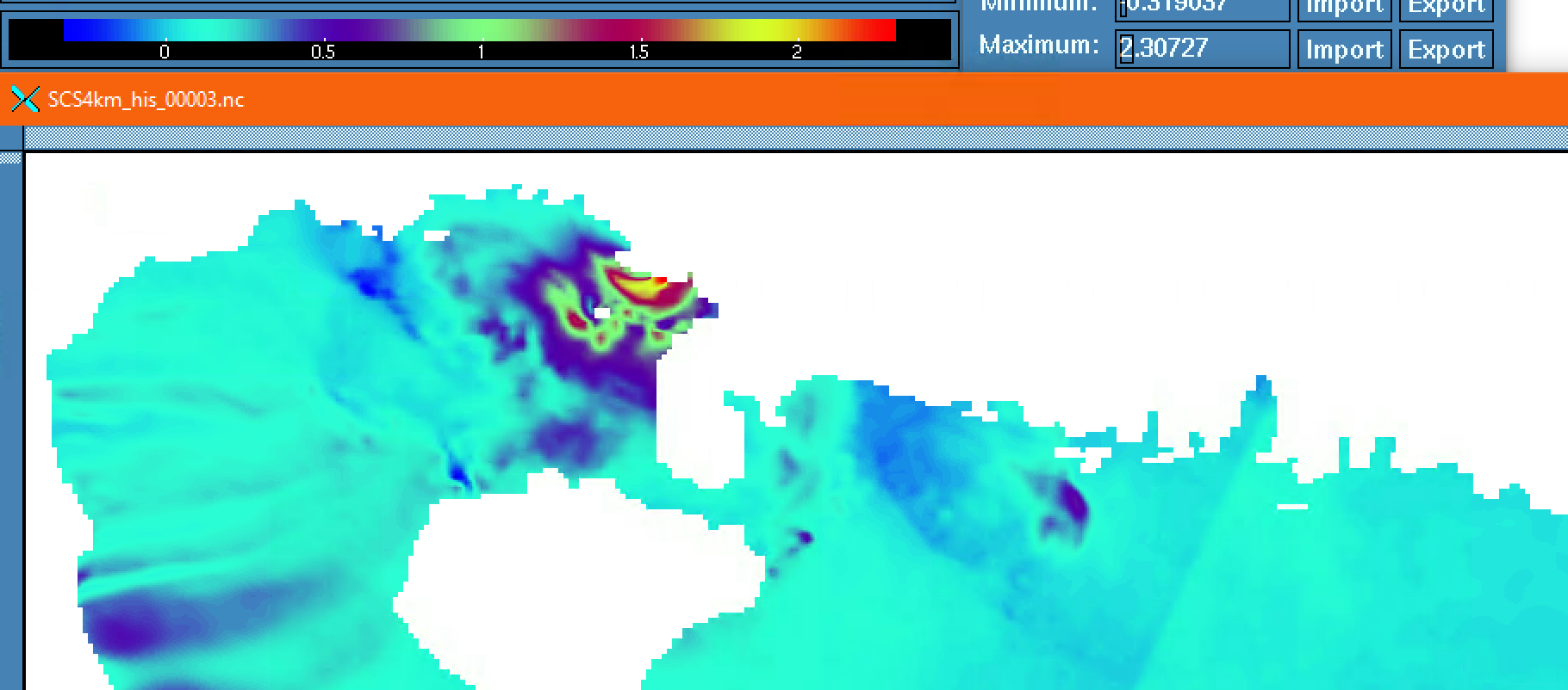

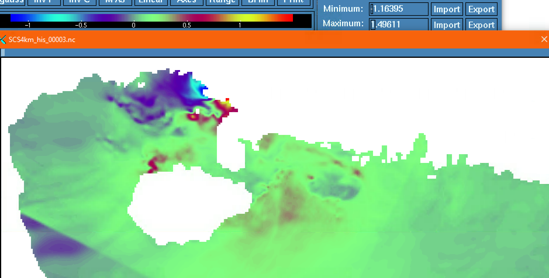

Here are the su/vstr fields about an hour before the simulation blows up and just when the typhoon makes landfall. I never noticed this but there seems to be somewhat the discontinuity between my outer and inner WRF domain (most notably for sustr in the affected delta). It's a small difference (0.08 N m^-2) but it's so shallow in the region maybe that's what's causing zeta and u/s fields to blow up.
I can't say I'm hugely experienced in WRF (this is my first venture into Typhoon modelling) but I think if I apply some expended damping on the boundary of the inner domain maybe I won't get such a continuity, and a smoother field might result in a more stable simulation for ROMS.
I must say I probably should have looked at this forcing to start with... but in any case thanks for the suggestion John!
