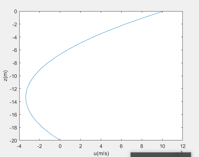

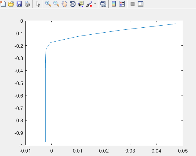

I set a closed boundary pool(50m*50m), △x=1m, △t=0.2s.
There is just one forcing condition, a constant Uwind = 8m/s.
But my result looks so strange. (I think it should be a smooth parabola)
Here is my result.png. It looks unnatural.
The x-coordinate is u(m/s) ,and the y-coordinate is s_rho. I just want to draw the relationship between the velocity of flow and the water depth under the condition
of a constant Uwind.
My constant wind-induced case seems strange

- zhangtianhao
- Posts: 50
- Joined: Fri May 11, 2018 5:36 pm
- Location: Beijing Normal University
Re: My constant wind-induced case seems strange
Init file : all values = 0
Forcing file : Uwind = 8m/s
Here is my in.file:

I think the result should be like this:
( I draw this picture by the analytical formula)
- pool2.png (15.21 KiB) Viewed 6401 times

THETA_S == 8.0d0 ! surface stretching parameter
THETA_B == 0.5d0 ! bottom stretching parameter
TCLINE == 20.0d0 ! critical depth (m)
use something like Gout=get_roms_grid('ocean_his.nc',tidx);
this will give you a field Gout.s_rho that you can avg to get the vertical locations of your grid. how did you get the 'z' values in your plot?
Ok, then i saw your bc's and it says everything is closed. Try to do a periodic in N-S or E-W.
