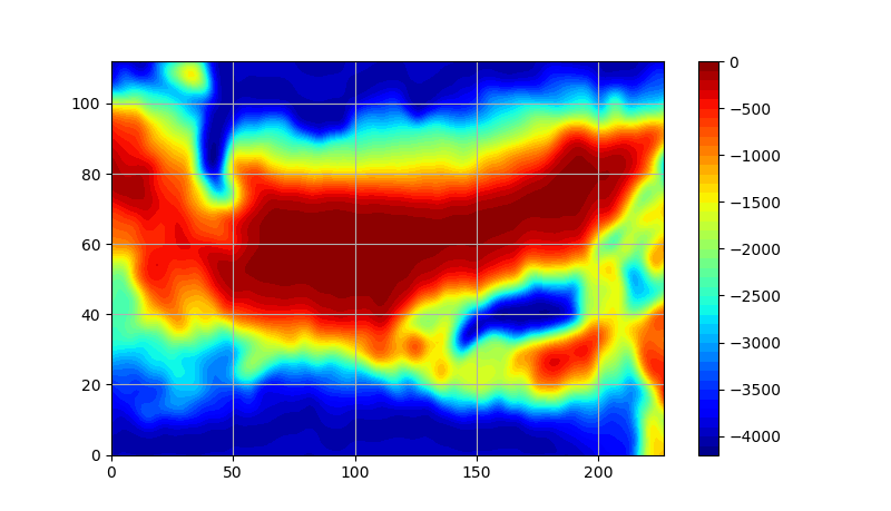

I am running an idealized simulation in ROMS using an uneven terrain grid that represents the VI-Puerto Rico bathymetry. I smoothed the bathymetry from the original ETOPO 1km version, such that rx0 = 0.16 and rx1 (Haney number) = 3.92. The bathymetry plot is shown below. (This simulation does not have any land-sea masking)
