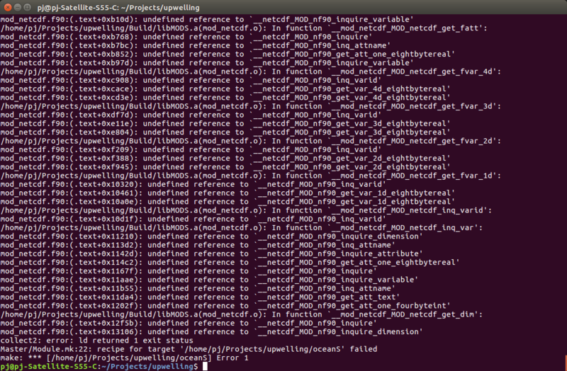

Hello, I am currently an undergraduate student trying to install the ROMS model for the first time. I would say I am a beginner when it comes to programming but have experience in Java and Python
So I have been trying to install it on my computer running Ubuntu 16.04 and keep having the following problem:
Master/Module.mk:22: recipe for target '/home/pj/Projects/upwelling/oceanS' failed
Looking through the forums, I saw people said to look at the first 2 bullets in FAQ for linking but im still having the same error no matter where I change the path in the build.bash file.
I have attached a screenshot of the terminal after it tries to run and log text file.
Sincerely,
Patrick

That's a netcdf-fortran issue. You need to install it along with just netcdf. You might need to change nc-config to nf-config in the Compilers file.
