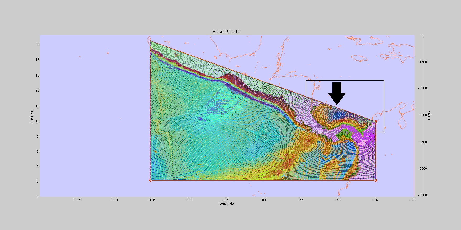

I'm working with SeaGrid, in my map I want to mask a part of the ocean, like it was a land mask. Already I'm doing it clicking on a each ocean cell where that I want do the mask, but I have many cells (because my resolution is 1/24°) and my masking will be very slow.
I wonder if exist an other method to do the mask in a specific area, if I don't want to click cell by cell?
Somebody know how? Thanks in advance.
I add my grid, and a select the part that i want to mask.
Mar.Mo.
Mar.Mo.
Re: Set a land mask on the sea in SeaGrid
Hmm, first, the model requires all angles to be right angles. From what I know of seagrid, your orthogonality errors could be substantial with that grid because you don't ask it to converge.
The matlab editmask has the capability of changing whole rectangles at a time.
I do this stuff outside matlab. Just figure out the patch I want to change and code it up. This is Python, but you can use your language of comfort (you have one, right???):

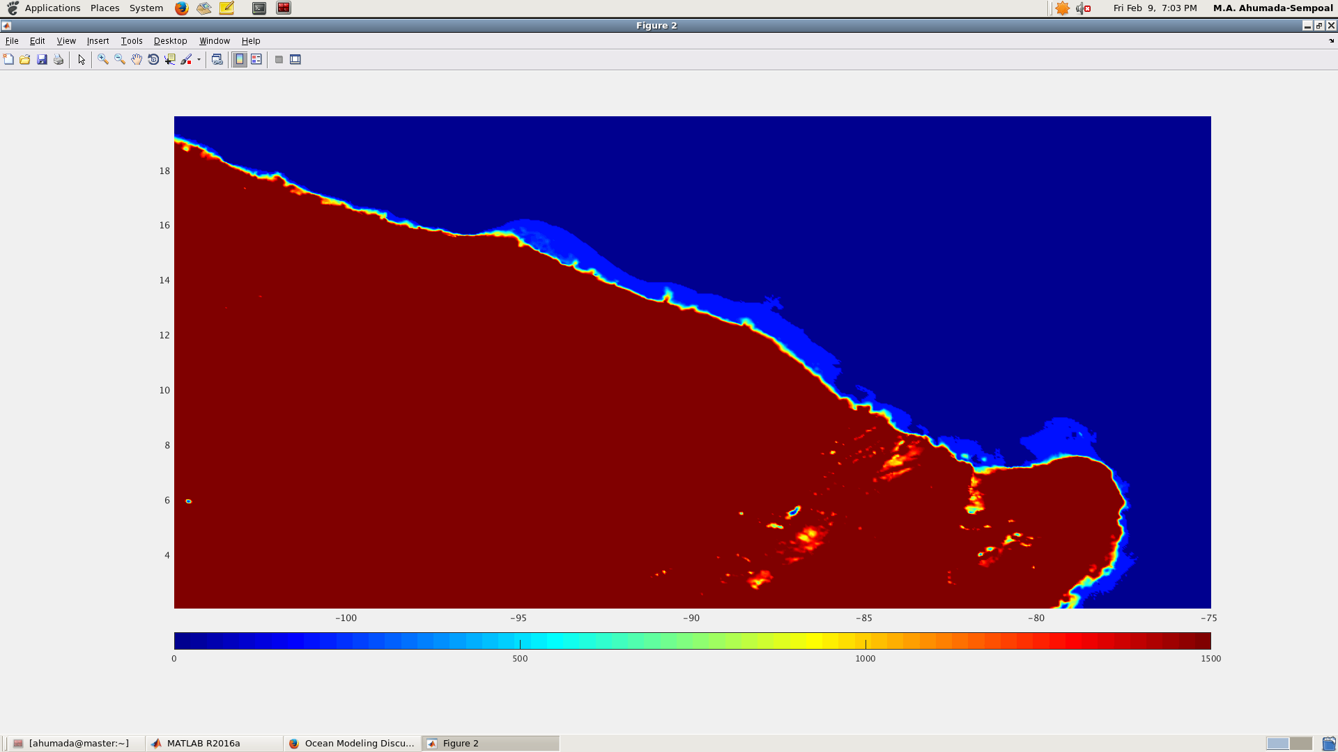

So many thanks for your help, I had not known that the model requires all angles to be right angles. I already corrected this, for the other hand I could mask the sea in matlab, based on your code. Thanks.
But I have a question, Do you know how can I save the netcdf file with the new variable (already edited)?
Thanks in advance.
Mar.Mo.
This is my code:
%% Load Netcdf file
ncfile ='/home/ahumada/roms-3.7/matlab/seagrid/GT4_roms_grd.nc'
nc=netcdf(ncfile)
ncdump(nc)
% extract variable
latr=nc{'lat_rho'}(:,:);
lonr=nc{'lon_rho'}(:,:);
mask_rho=nc{'mask_rho'}(:);
h=nc{'h'}(:,:);
%% mask
% nombre de la variable(renglon i:renglon n, columna i: columna n)= O
% cero es tierra
mask_rho(387:432,203:347) = 0
mask_rho(327:432,386:720) = 0
mask_rho(139:327,641:720) = 0
mask_rho(173:326,534:640) = 0
mask_rho(161:180,543:557) = 0
mask_rho(161:174,558:597) = 0
mask_rho(182:326,506:533) = 0
mask_rho(318:326,500:505) = 0
h=nc{'h'}(:,:);
h=h.*mask_rho;
figure(1)
pcolor(lonr, latr,h);
colormap('jet');
hold on
shading interp
c=colorbar('SouthOutside');

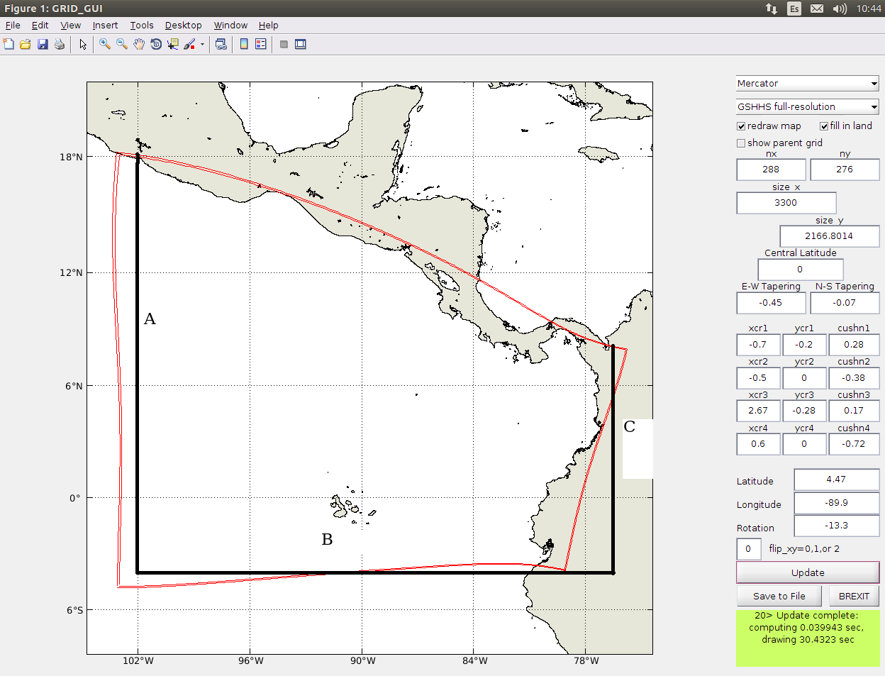

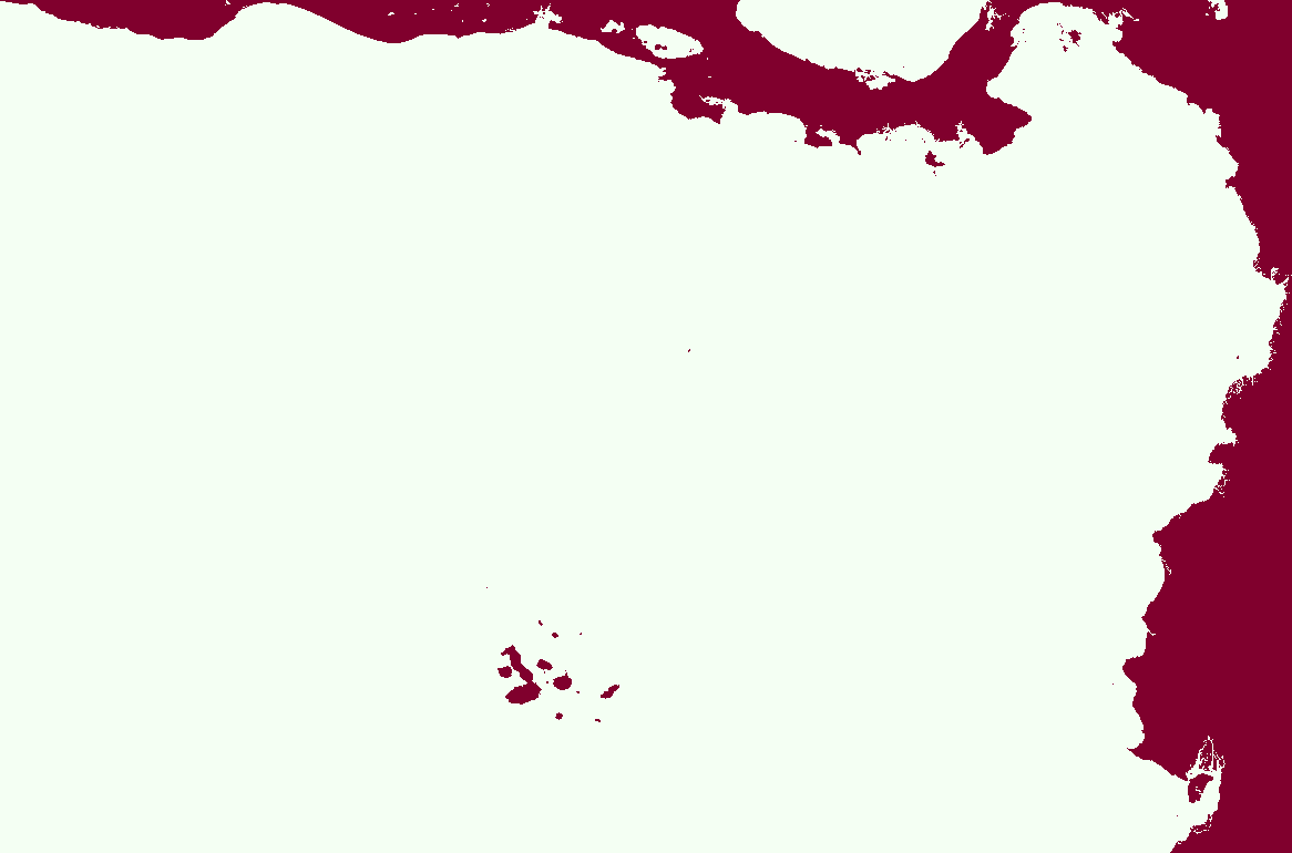

Is this the kind of grid you want to generate?
The procedure for generating ROMS land mask from USGS coastline data described here:
viewtopic.php?f=23&t=3878&p=14908
- This is ready-to-go version of the same mask post-processed by single_connect and commit_rmask.
- EastPac_curv_mask1.png (4.05 KiB) Viewed 75354 times
- This is "raw" mask generated by gshhs_to_roms_mask from USGS coastline data as seen in grid-index coordinates (basically by ncview)
- EastPac_curv_mask.png (5 KiB) Viewed 75354 times

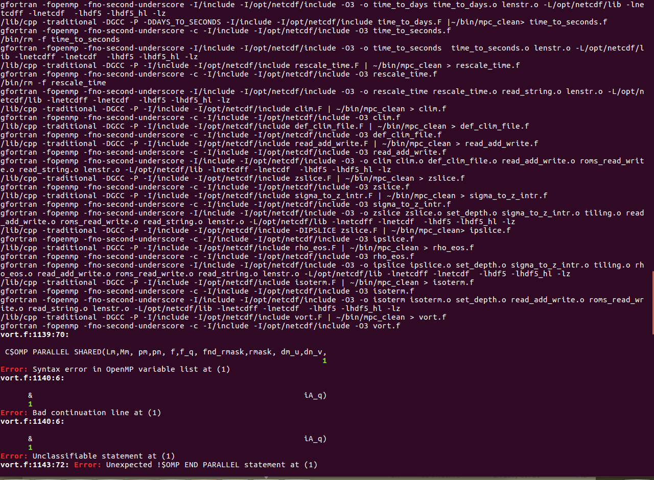

I followed your advice to do it with the new tools. But I had have some problems with the mpc compile.
I followed the README.compiling file, but when I compile mpc I get:

mpc.f:660:20:
elseif (str(m) == '_') then
1
Error: Unexpected junk after ELSE statement at (1)
mpc.f:670:23: Error: Syntax error in IF-expression at (1)
mpc.f:671:25: Error: Syntax error in IF-expression at (1)
mpc.f:672:20:
str(m )='D'
1
Error: Unclassifiable statement at (1)
mpc.f:673:20:
str(m+1)='0'
1
mpc.f:676:22:
str(i)=str(i+1)
1
mpc.f:678:24:
elseif (str(m+1) == 'e') then
1
mpc.f:679:20:
str(m)='D'
1
mpc.f:682:22:
str(i)=str(i+2)
1
mpc.f:685:19:
endif
1
Error: Expecting END DO statement at (1)
mpc.f:686:20:
elseif ( str(m) < 'A' .or. ( str(m) > 'Z'. and.
1
mpc.f:689:16:
do while(str(m-1) == ' ')
1
mpc.f:693:18:
str(i+2)=str(i)
1
mpc.f:695:16:
str(m)='_'
1
mpc.f:696:16:
str(m+1)='8'
1
mpc.f:698:17:
endif
1
Error: Expecting END PROGRAM statement at (1)
mpc.f:699:15:
endif
1
mpc.f:700:13:
endif
1
mpc.f:701:11:
enddo
1
mpc.f:706:17: Error: Syntax error in IF-expression at (1)
mpc.f:707:39:
scratch(i:i)=char(ichar(str(i))+case_fold)
1
Error: Syntax error in argument list at (1)
mpc.f:708:72: Error: Unexpected ELSE statement at (1)
mpc.f:709:12:
scratch(i:i)=str(i)
1
mpc.f:710:13:
endif
1
mpc.f:794:15: Error: Syntax error in IF-expression at (1)
mpc.f:796:10:
do while (str(i) == ' ' .and. i < length)
1
mpc.f:798:13:
enddo
1
mpc.f:799:17: Error: Syntax error in IF-expression at (1)
mpc.f:802:12:
1
mpc.f:804:15:
enddo
1
mpc.f:805:19: Error: Syntax error in IF-expression at (1)
mpc.f:807:14:
1
mpc.f:809:17:
enddo
1
mpc.f:811:21: Error: Syntax error in IF-expression at (1)
mpc.f:820:18:
str(i+j-1)=scratch(j:j)
1
mpc.f:823:17:
endif
1
mpc.f:824:15:
endif
1
mpc.f:825:13:
endif
1
mpc.f:826:11:
endif
1
mpc.f:842:37: Error: Expected a right parenthesis in expression at (1)
mpc.f:844:37: Error: Expected a right parenthesis in expression at (1)
mpc.f:855:19: Error: Syntax error in IF-expression at (1)
mpc.f:857:18:
elseif (str(k) == ',') then
1
mpc.f:859:18:
elseif (str(k) == '=') then
1
mpc.f:861:18:
elseif (str(k) == '/') then
1
mpc.f:863:18:
elseif (str(k) == '+' .or.
1
mpc.f:867:15:
endif
1
mpc.f:909:37: Error: Expected a right parenthesis in expression at (1)
mpc.f:911:38: Error: Expected a right parenthesis in expression at (1)
mpc.f:914:12:
str(i)=' '
1
mpc.f:916:10:
str(6)='&'
1
mpc.f:919:12:
str(i-m)=str(i)
1
mpc.f:922:37: Error: Expected a right parenthesis in expression at (1)
mpc.f:924:37: Error: Expected a right parenthesis in expression at (1)
make: *** [mpc] Error 1
Why do I get this error?
Thanks in advance for your help.
Mar.Mo.
mpc.f:335:18: Error: Syntax error in IF-expression at (1)
mpc.f:336:19: Error: Syntax error in IF-expression at (1)
mpc.f:337:20: Error: Syntax error in IF-expression at (1)
mpc.f:338:21: Error: Syntax error in IF-expression at (1)
mpc.f:339:22: Error: Syntax error in IF-expression at (1)
mpc.f:340:23: Error: Syntax error in IF-expression at (1)
mpc.f:343:19:
endif
1
mpc.f:344:18:
endif
1
mpc.f:345:17:
endif
1
mpc.f:346:16:
endif
1
mpc.f:347:15:
endif ! After this moment "i" is
1
mpc.f:348:14:
endif ! index of the last character
1
mpc.f:349:13:
endif ! of Fortran type declaration
1
mpc.f:350:12:
endif ! which may be either "real",
1
mpc.f:351:11:
endif ! "integer", or "character"..
1
mpc.f:355:10:
do while (j < length .and. str(j)==' ')
1
mpc.f:357:13:
enddo ! first non-blanc str
1
Error: Expecting END IF statement at (1)
mpc.f:374:17: Error: Syntax error in IF-expression at (1)
mpc.f:377:12:
do while( str(is) == ' ' .and. is < length)
1
mpc.f:379:15:
enddo
1
mpc.f:381:12:
do while( str(ie+1) /= ' ' .and. str(ie+1) /= ','
1
mpc.f:384:15:
enddo
1
mpc.f:386:19: Error: Syntax error in IF-expression at (1)
mpc.f:391:14:
bffr(k)=str(k+is-1)
1
mpc.f:397:16:
str(k+isft)=str(k) ! "isft", then move the rest
1
mpc.f:400:14:
str(i+1)='(' ! insertion, adjust the length
1
mpc.f:401:14:
str(i+2)='l' ! of the line accordingly,
1
mpc.f:402:14:
str(i+3)='e' ! then insert the new-style
1
mpc.f:403:14:
str(i+4)='n' ! size specification.
1
mpc.f:404:14:
str(i+5)='='
1
mpc.f:406:16:
str(i+k+5)=bffr(k)
1
mpc.f:408:14:
str(i+ie-is+7)=')'
1
mpc.f:416:16:
str(k+isft)=str(k)
1
mpc.f:420:14:
str(i+1)='('
1
mpc.f:421:14:
str(i+2)='k'
1
mpc.f:422:14:
str(i+3)='i'
1
mpc.f:423:14:
str(i+4)='n'
1
mpc.f:424:14:
str(i+5)='d'
1
mpc.f:425:14:
str(i+6)='='
1
mpc.f:427:16:
str(i+k+6)=bffr(k)
1
mpc.f:429:14:
str(i+ie-is+8)=')'
1
mpc.f:459:16:
elseif ( str(j) /= '(' .and. ( str(j) == ' ' .or.
1
mpc.f:490:16:
str(k+isft)=str(k) ! isft symbols to the right
1
mpc.f:493:16:
str(k)=' ' ! and increase length of
1
mpc.f:498:14:
str(i+1)='('
1
mpc.f:499:14:
str(i+2)='k'
1
mpc.f:500:14:
str(i+3)='i'
1
mpc.f:501:14:
str(i+4)='n'
1
mpc.f:502:14:
str(i+5)='d'
1
mpc.f:503:14:
str(i+6)='='
1
mpc.f:504:14:
str(i+7)=type
1
mpc.f:505:14:
str(i+8)=')'
1
mpc.f:507:13:
endif
1
mpc.f:508:11:
endif
1
mpc.f:613:17: Error: Syntax error in IF-expression at (1)
mpc.f:615:16:
elseif (str(i) == '.' .and. lswtch) then
1
mpc.f:618:13:
endif
1
mpc.f:626:19: Error: Syntax error in IF-expression at (1)
mpc.f:628:18:
elseif (str(m) /= ' ') then
1
mpc.f:630:15:
endif
1
mpc.f:633:30:
if ( lswtch .or. str(m) < 'A' .or. ! Cond.(3)
1
mpc.f:641:21: Error: Syntax error in IF-expression at (1)
mpc.f:643:20:
1
mpc.f:645:17:
endif
1
mpc.f:650:21: Error: Syntax error in IF-expression at (1)
mpc.f:653:16:
do while (str(i)==' ' .and. i<length)
1
mpc.f:655:19:
enddo
1
mpc.f:656:24: Error: Syntax error in IF-expression at (1)
mpc.f:660:20:
1
mpc.f:672:20:
str(m )='D'
1
mpc.f:673:20:
str(m+1)='0'
1
mpc.f:676:22:
str(i)=str(i+1)
1
mpc.f:678:24:
1
mpc.f:679:20:
str(m)='D'
1
mpc.f:682:22:
str(i)=str(i+2)
1
mpc.f:685:19:
endif
1
mpc.f:686:20:
1
mpc.f:689:16:
1
mpc.f:693:18:
str(i+2)=str(i)
1
mpc.f:695:16:
str(m)='_'
1
mpc.f:696:16:
str(m+1)='8'
1
mpc.f:698:17:
endif
1
mpc.f:699:15:
endif
1
mpc.f:700:13:
endif
1
mpc.f:701:11:
enddo
1
mpc.f:707:39:
1
mpc.f:709:12:
scratch(i:i)=str(i)
1
mpc.f:710:13:
endif
1
mpc.f:796:10:
1
mpc.f:798:13:
enddo
1
mpc.f:802:12:
1
mpc.f:804:15:
enddo
1
mpc.f:807:14:
1
mpc.f:809:17:
enddo
1

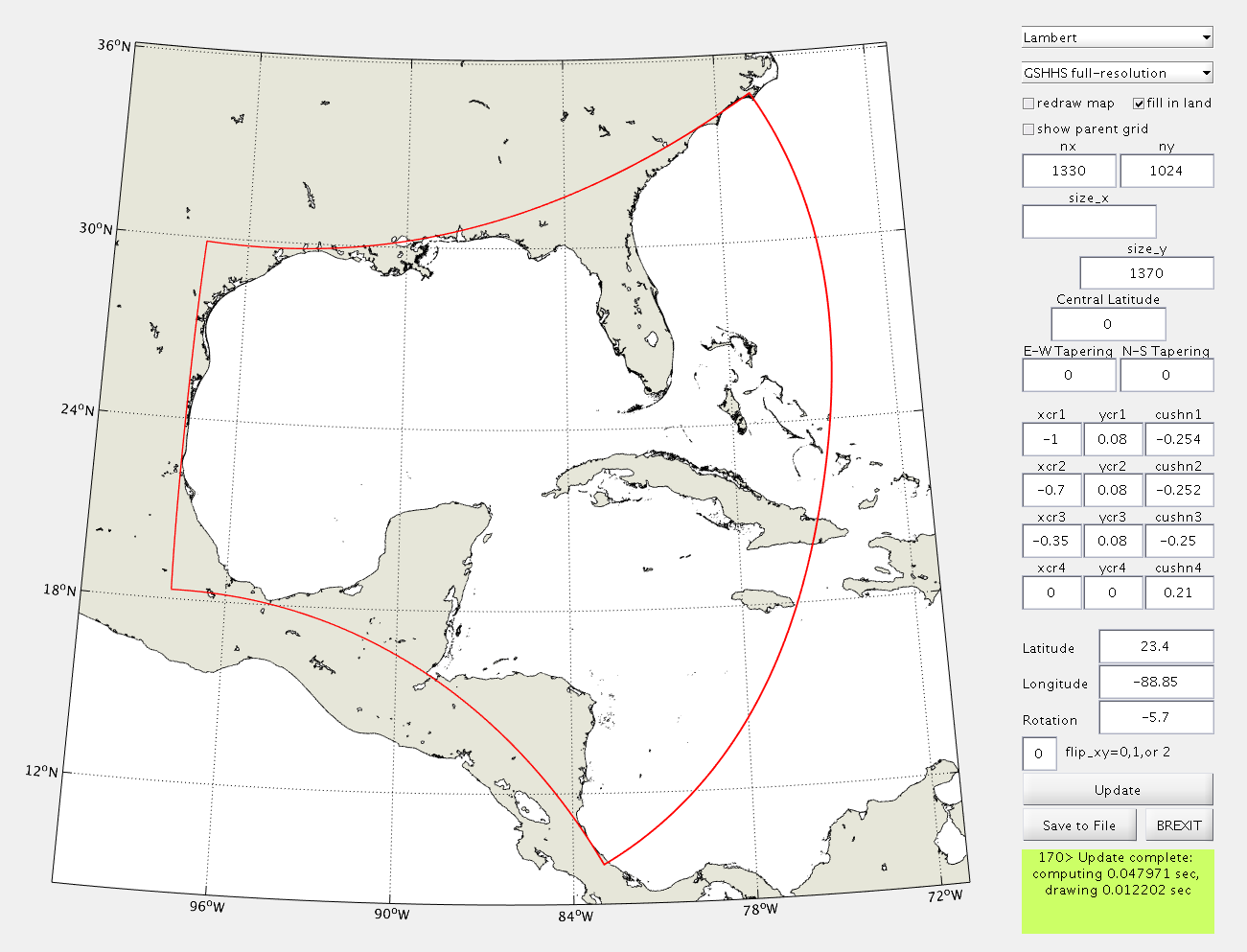

The reason why you have these compiling problems is a faulty version of mpc.F supplied
with the package at some point in the past. This was corrected, but it appears that the
old version came back because at some point the web page was restored from the backup
after disk failure and I did not realize that this happened. At this moment I do not
have access to the web server to replace tar file, so use file "tools.tar" attached to
this response.
Note that a Matlab grid generation tool which was used to make the grid in the previous
post is also available from the same web suite
http://people.atmos.ucla.edu/alex/ROMS/grid_gui.tar
although it is relatively new and lacks instructions - a README file is being written,
but not included into the package yet. It is basically a tool to create analytical
grid using staged conformal transformations. Setting all weird parameters to zero
cent_lat = EWtpr = NStpr = cushn1 = cushn2 = cushn3 = cushn4 = 0
reverts it to easy_grid type of tool: it creates a patch of Mercator grid transferred
to user-specified location and rotated by user-specified azimuth angle.
Optionally the initial rectangular patch on Mercator plane can be deformed into
a desired shape by two kind of transforms:
(i) "tapering" in either direction - rectangle turns into a sector of polar coordinates
with simultaneous exponential stretching along the radial direction (delta r is
proportional to r), and
(ii) "cushioning" - rectangle becomes convex in one direction, concave in the other
(or vice versa, depending whether parameter cushn is positive or negative).
This is actually transform into elliptic coordinates: imagine a family of confocal ellipses
and a family of hyperbolae with the same foci. It can be proven that ellipses and
hyperbolae intersect each other at right angle. This is the basis.
Parameter cushn controls the location of foci:
cushn=0 means that they are infinitely
far away - rectangle remains rectangle and nothing happens;
cushn > 0 makes them approach from infinity along x-axis - actually places the foci
on the horizontal line passing through point (xctr,yctr) and at equal distance from
the point, so the rectangle become concave in eastern and western side (they become
hyperbolae) and convex on northen and southern (they become cutoffs of ellipses).
Now exactly depends on (xctr,yctr).
cushn < 0 along y-axis -- similarly, but everything is rotated
90 degrees.
It is a bit tricky to control, but after some practice you can fit very weird shapes.
Couple tips:
1. The boundaries of the map are determined automatically based on current grid
configuration. Once the desired geographical region is captured unclick the "redraw map"
box on top -- this would speed up the drawing by a factor of 100 LITERALLY(!) because
map does not need to be redrawn every time when you hit "update" button.
2. Leaving one of the four boxes, nx, ny, size_x, size_y, blank makes the tool to calculate
the missing value from the condition of isotropy of the grid: dx = dy EVERYWHERE (same
as pm == pn EVERYWHERE). This is very useful. Of course, if size_x, size_y are both
specified, but one of nx,ny is not, then isotropy is not exact because of rounding
to the nearest integer; but is nx,ny are both specified, while one of size_x,size_y left
blank, then isotropy is perfect. THIS IS HOW I ALWAYS RECOMMEND to do it at the end:
at first specify both size_x,size_y, and leave nx blank, play with setting until
you like it, then see Matlab command window to figure nx (the tool always prints the
computed value), put nx into the box, but erase size_x or size_y -- the tool will
adjust its value to make the grid be perfectly isotropic.
3. UPDATE button draws the new contour on top of the old (alternating between red and
magenta colors). This is useful to visualize incremental change, so you can accept or
reverse it. Hitting UPDATE button second time without changing any of the parameters
makes single contour.
4. The contours are actually double lines exactly 1dx or 1dy apart from each other.
this is useful because one can use Matlab zoom facility to check how the edge of
the grid is placed relative to the coastline: ideally the coastline should be in
between the double lines - in this case there will be EXACTLY 1 row of mask points.
5. BREXIT means "Break and Exit" this button just quits the tool without doing anything
else, i.e., it does not trigger saving into the file.

Already with the new tools, I could compile mpc. But now when I type make, I get:
[ahumada@master tools]$ make
gfortran -fopenmp -fno-second-underscore -c -I/usr/local/lib -O3 def_clim_file.f
def_clim_file.f:538:40:
ierr=nf_create(trgfile, nf_netcdf4, nctarg)
1
Error: Symbol ‘nf_netcdf4’ at (1) has no IMPLICIT type
make: *** [def_clim_file.o] Error 1
I don't konow if is cause by my netcdf libreries or if is def_clim_file.f file problem.
How can I solve this problem?. Thanks in advance.
Best regards.
Scarlett
This one you should be able to overcome yourself. At first, my package comes with severalError: Symbol ‘nf_netcdf4’ at (1) has no IMPLICIT type
README.something files: just look through them. Among them is README.compiling which
tells what to do.
Then, it is quite obvious that your netcdf.inc file does not contain definitions for netCDF 4
functions, so you can either
(i) preferred way, install and use netCDF library with full netDF4/hdf5 capabilities, or
(ii) handicapped way (ok as a temporary fix): exclude all functionality from the package
which requires netCDF4 - basically keep trying to compile everything by "make", see which
ones do not compile with errors line this, and exclude them from INST_LIST in Makefile.
Some people find compiling netCDF 4 with hdf5 and zlib too tedious. In reality it takes
about 20 minutes, using mostly computer mouse for copy-pasting and almost without
ever touching keyboard. See README.compiling_sequence inside the attached
netcdf4_help.tar.

Dear Alexander:
I tried install this mask tool, but was necessary change some of my libraries and dependencies, and this could affect the dependencies that ROMS uses, I chose not install. For a time I decided work with the normal grid (without mask the Atlantic) but is demanding in time way.
So what I did was create a grid file with a mask in the Atlantic from which I created in seagrid. The input ROMS files were creating without problems. But ROMS do not work with this new grid.
Could you tell me why ROMS do not work with this new grid?
Some suggestion? What can I do?
So many thanks for your time and suggestion.
Scarlett Mar.Mo.

Hi Alexander F. Shchepetkin:
I try to use the UCLA grid, i downloaded tools.tar from http://people.atmos.ucla.edu/alex/ROMS/tools.tar
I installed all the prerequisites on my machine and followed the steps of the README.compiling file but in step "d" I write make in the terminal
there is an error.
vort.f
70:
C$OMP PARALLEL SHARED(Lm,Mm, pm,pn, f,f_q, fnd_rmask,rmask, dm_u,dn_v,
1
Error: Syntax error in OpenMP variable list at (1)
vort.f
6:
& iA_q)
1
Error: Bad continuation line at (1)
vort.f
6:
& iA_q)
1
vort.f
72: Error: Unexpected !$OMP END PARALLEL statement at (1)
Annex more information in error.zip
I hope you can help me, thank you.
Obviously this should be
i.e., change "& into "C$OMP&" in continuation line for OpenMP directive
in the original vort.F file.
...interestingly Intel Ifort compiler does not care.
C$OMP& iA_q)
call init_vort_thread(Lm,Mm, pm,pn, f,f_q, fnd_rmask,rmask,
& dm_u,dn_v, iA_q)
C$OMP END PARALLEL
Thank you so much, I have solved the problem. I think it's because I use Gfortran.

thanks you, I can compile correctly. Can you help me with a grid?
I want to make a grid with sides A, B, C completely right, similar to the attached image

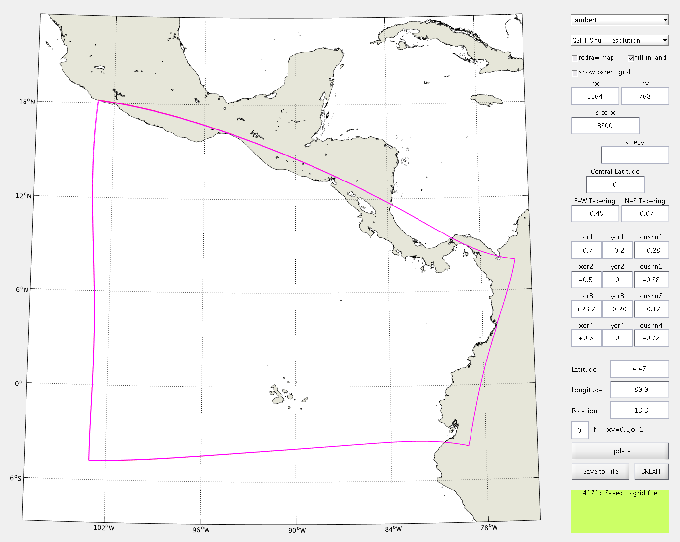

The answer in "no", all three of them, A,B,C, cannot be made straight at the same time.
This is the nature of conformal mapping: once A and C are straight, there is no way to fit a
curve which would go along the coast, and be perpendicular to A and C at the junction points.
B can me made straight easily. but in this case A and C will be curved.
A can be made straight, but then B and C be curved, and the remaining line on the top would
have to enter deeply into the land and get a lot of masking.
Making C straight? I see no point as it is inside the mask any way.
Besides, there is no wisdom even trying to the make side boundaries straight? Even if some
of them are straight, once you depart from the boundary go into the domain, the coordinate
lines are no longer straight any way.
It has to be recognized that this analytical curvilinear grid is optimal by the design in sense
tat it is:
(1) exactly othrogonal;
(2) perfectly isotropic, pm=pn at every grid cell (same as local dx=dy at every cell, despite
that fact that both dx, dy change from cell to cell;
(3) with some diligence has minimal possible non-uniformity of the resolution: the ratio
min(dx)/max(dx) kept as small as possible for a given situation of the particular shape
of the domain and coastline;

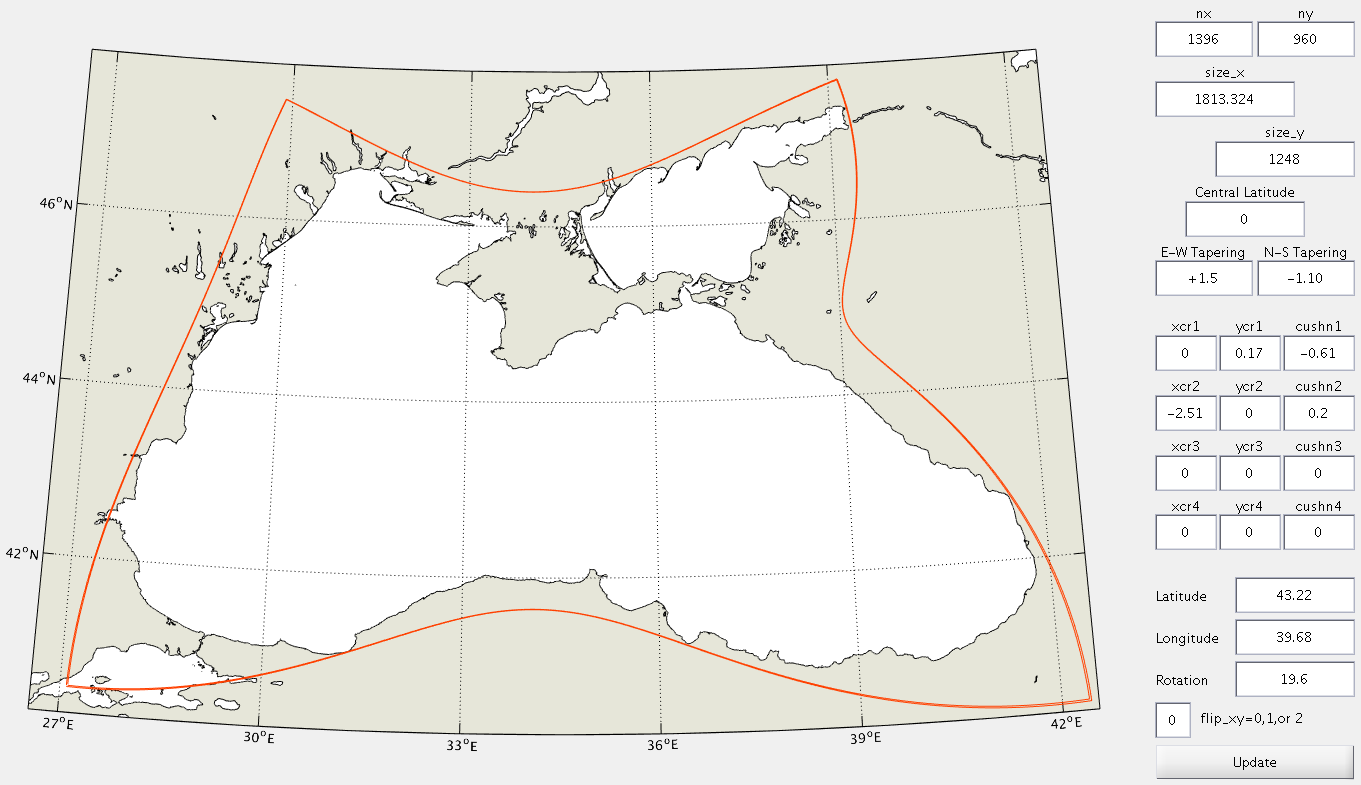

The fundamental flaw of seagrid, as well as the more recent package GridBuilder which
replaces it, is that they provide no means to enforce perpenducular junction of the side
boundaries. Both packages allow you to define points at the side and move them in and
out to achieve the desired shape, but the junction points end up be not perpendicular,
and it is basically left up to the user to make them as close to perpendicular as possible --
it is possible in theory, but is very hard to achieve in practice. This makes it very hard to
construct a satisfactory grid: everybody complains about corner problems.
This also leads to the very long-standing confusion in ROMS community (and in POM
community before) that one can fit curvilinear grid to virtually any shape -- as for the
contour yes, you can fit it, but if the corner is not exactly 90 degrees, once you start
filling up the grid points by solving Dirichet elliptic equation, the grid points tend to
either concentrate toward the corner (if >90 degrees) or, conversely, avoid it (< 90).
tat it is:

I did add a new grid format to GridBuilder for purely orthogonal grids last year at the request of John Wilkin, it is similar to the rectangular format but it remains orthogonal (to working precision) under expansion, rotation and translation. In orthogonal mode you can't use control points to generate exotic curvilinear grids (for that you have to use the Free mode which replicates the orignal SeaGrid functionality) but it does still allow telescoping with sliders.shchepet wrote:The answer in "no", all three of them, A,B,C, cannot be made straight at the same time.
