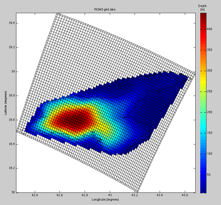

What about lakes? I try to generate grid for lake and it gives following results (see attached image). I also faced some problems defining X,Y and resol parameter. I know the size of the lake (122 km, 81 km) and i set the resol parameter as 1000 m. So in this case i expect that grid must be cover whole lake but it is not. I plot the image using parameter as X = 700000; Y = 500000; and resol = 10000;.
Best,
--ufuk
grid plot
grid plot
Picture 1.png (64.38 KiB) Viewed 65112 times

Hi ufuk,
I am not sure I understand your problem...
For what I understood, you estimated X Y and resol and when you plug your estimated values in Easygrid, the resulting grid-plot did not look as you expected... it was too small or not quite covering the whole lake. Did I get it right?
If so... you may have to iteratively change (one variable at the time) X, Y, lat, lon, resol and/or rotangle... plot in between to see the effect of each change you made. I know it is a rather primitive way of adjusting a grid, but in ~10 minutes you should be finished. Not elegant, but it works.
Diego
