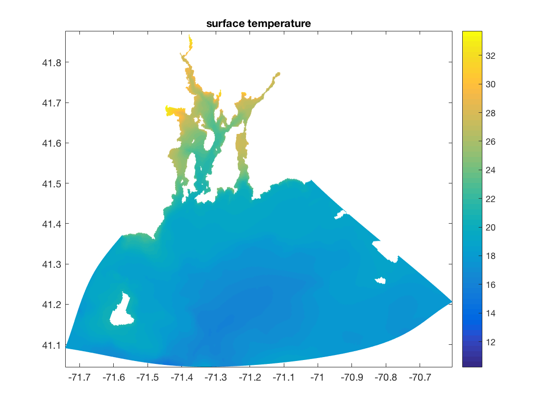

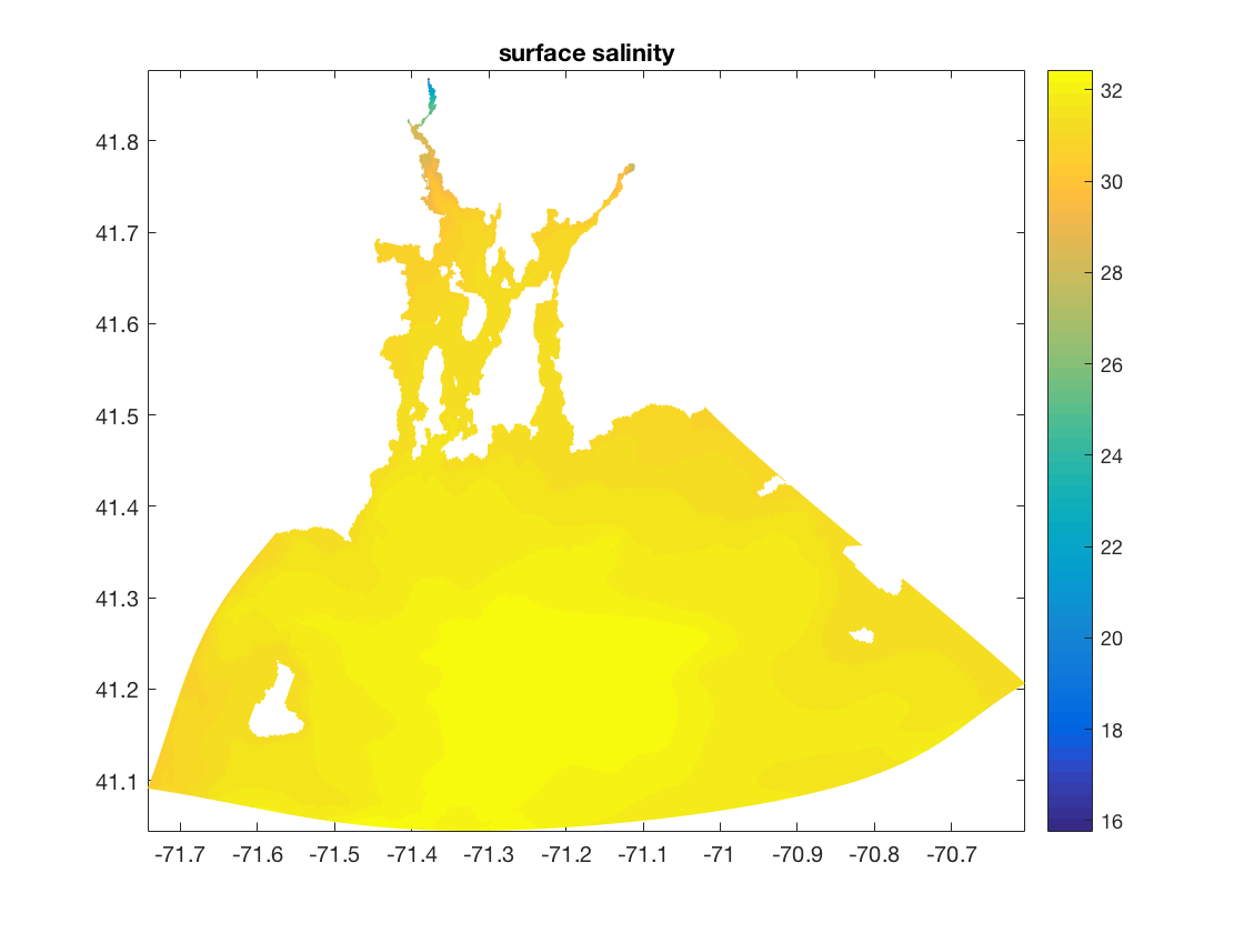

I am trying to run a case with coupled ROMS and swan (COAWST) to do sediment transport. Before I add sediment part I did a case purely by running coupled ROMS and SWAN with the same input files, which runs well. But when I modified initial file by adding sediment part with matlab_script named 'create_roms_init.m' which is provided as a part of COAWST tools. The model blows up at initial time due to NAN for Potential Energy and Net volume:
 STEP   Day HH:MM:SS  KINETIC_ENRG   POTEN_ENRG    TOTAL_ENRG    NET_VOLUME
       0   250 00:00:00           NaN           NaN           NaN           NaN
          (000,000,00)  0.000000E+00  0.000000E+00  0.000000E+00           NaN
But I did check the temperature and salinity which is reasonable. I totally don't know why it happened. I attached the ocean.in file, header file, output file.
Due to the big initial file, I uploaded on google drive which is open to everyone, here is the link:https://drive.google.com/file/d/1Zf-h3_ ... sp=sharing
If any friend has suggestions I would be very appreciate it.

initial surface temperature
initial surface salinity

Looks like one of your input has NaN values somewhere. ROMS doesn't allow this even on masked cells. See here: viewtopic.php?f=14&t=4454&view=next
