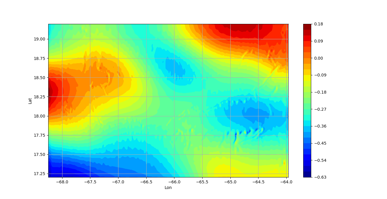

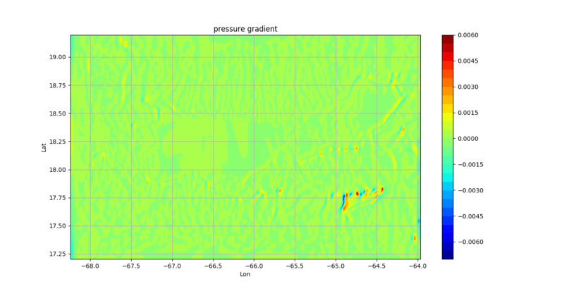

Previously, I posted a couple of discussion threads on 'unrealistic' velocities forming along the bathymetry on my domain. As a follow-up - I did some more analysis, and found out that the unrealistic velocities are forming due to spurious patterns in the pressure gradient, evolving along the spatially varying bathymetry. Below, are a few plots showing the problem.
Pressure gradient at the 1st time step
Notice the small-scale patterns forming. This is happening along the varying bathymetry. (plot below)

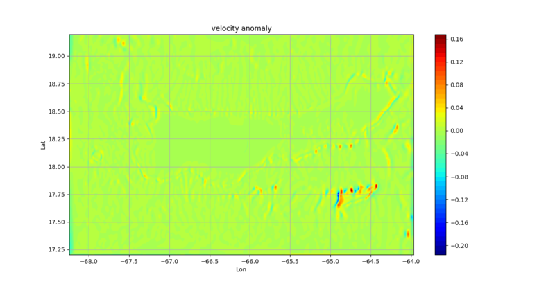

Velocity difference between 1st and 2nd timesteps
The anomalies in the velocity, match with the pressure gradient.
