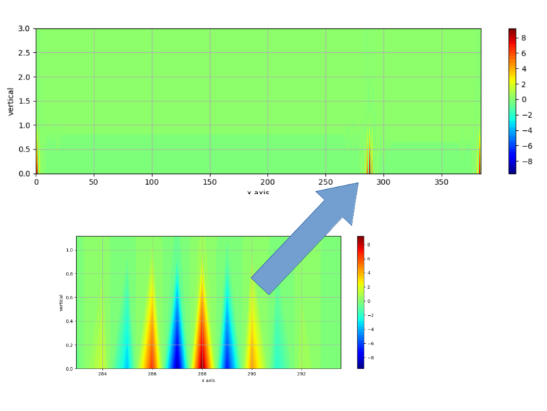

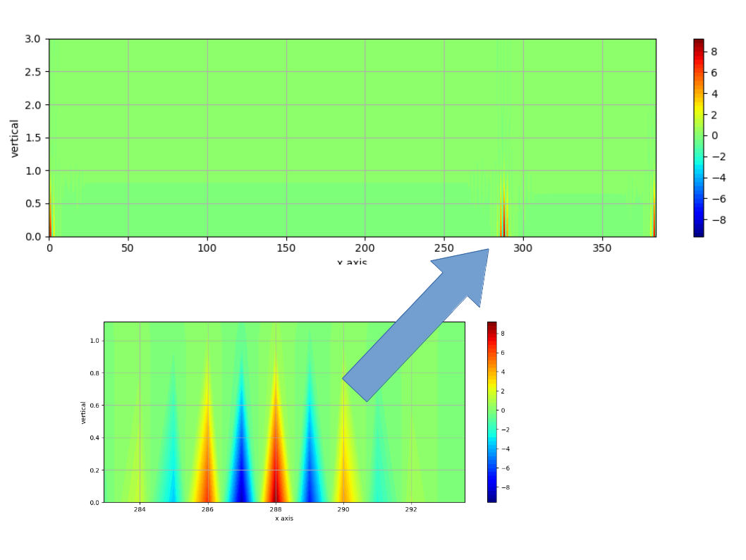

After a few time steps, very large unrealistic velocities are forming near the boundaries at the bottom, as shown in plot below:
The regions where the unrealistic values are happening, are marked and zoomed. There is a wave-like pattern in these disturbances, occurring along the adjacent grid points.
Below, is a vertical transect plot.
As you can see, these disturbances are forming near the bottom only.

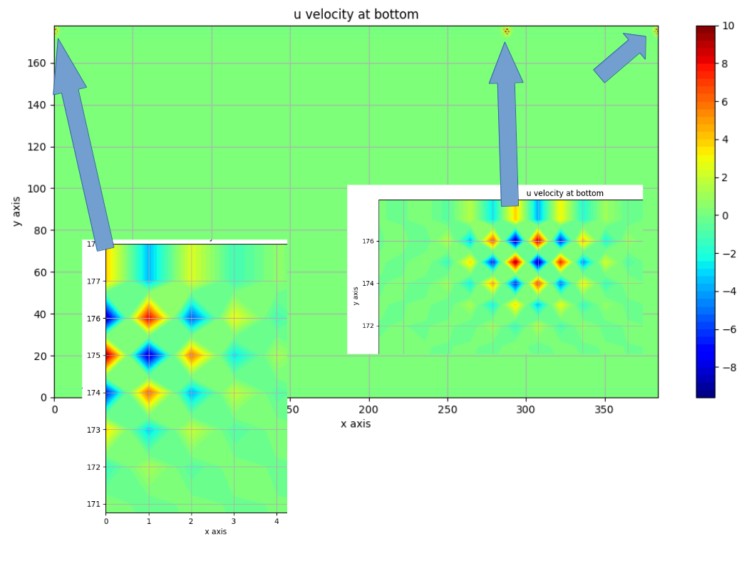

This is a plot of the u velocity along the longitude, at the bottom.
These zig-zag patterns are forming next to the boundary.
With shorter time steps, the simulation is running a bit further, but eventually blowing up again.
