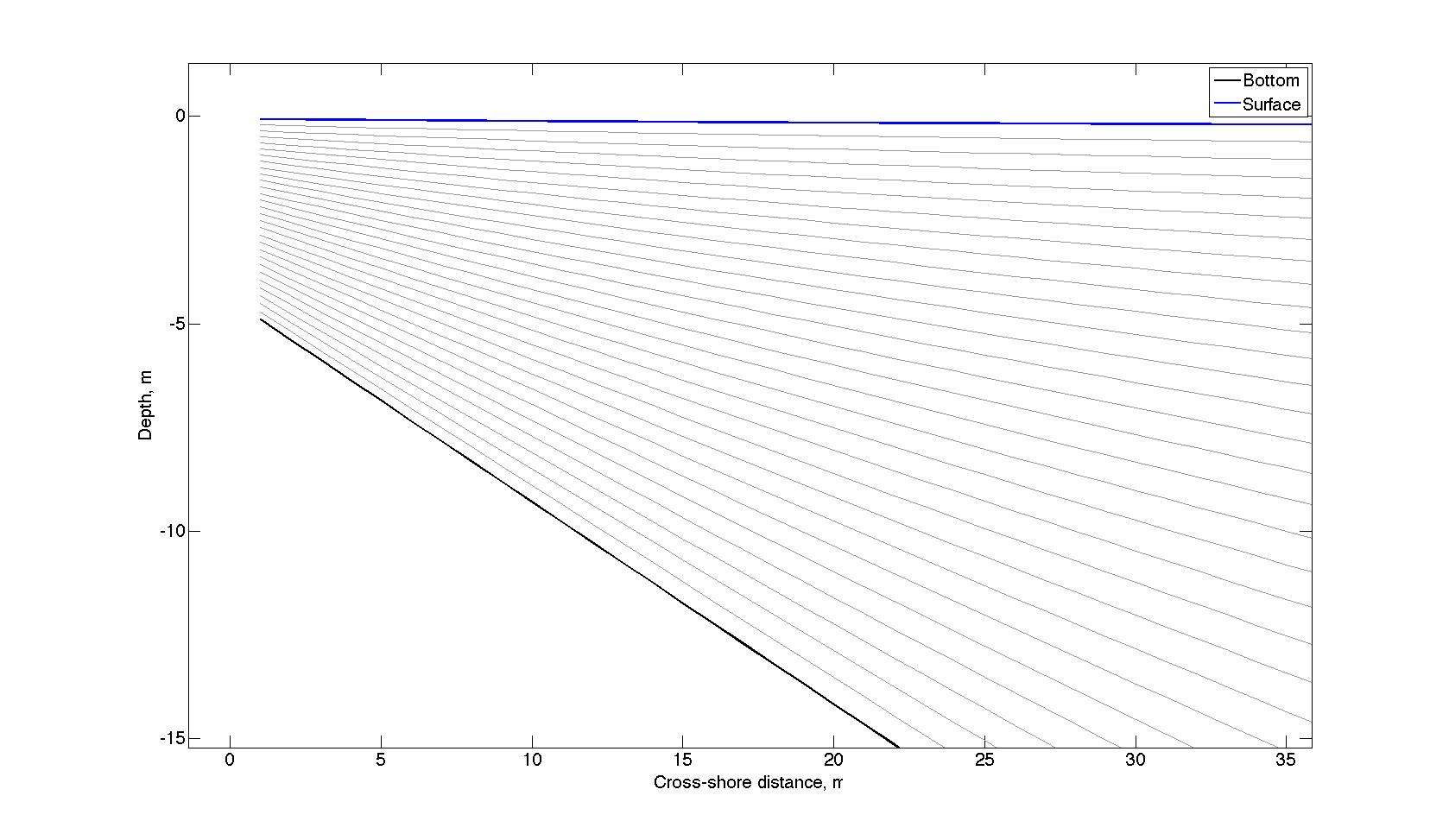

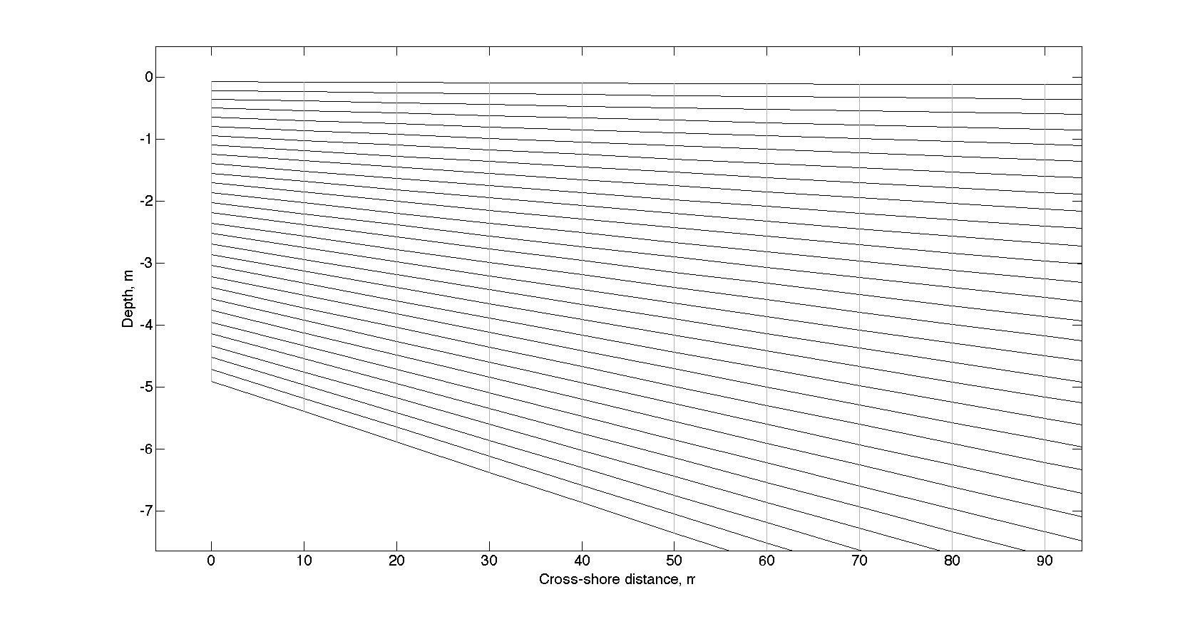

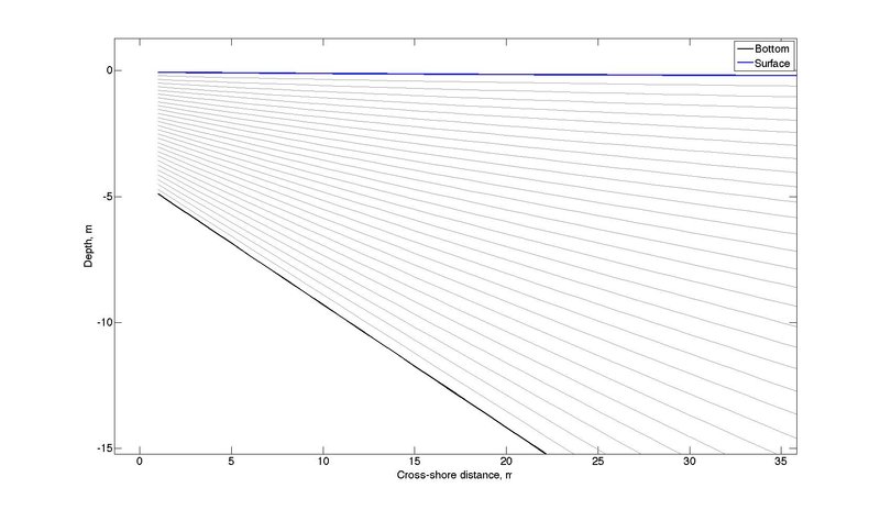

Can ROMS handle a grid resolution (rho points) where dx = dy = 10 m, but dz is as small as 0.14 m in the very nearshore-most cells (30 vertical levels)?
A transect image of the first ~100 m of my grid (an idealized 3D wedge shape, with a bottom slope of 0.05, and everything alongshore is uniform) is attached.
The reason why I ask is because my runs keep blowing up after ~21 days of simulation time. I can post more specific information if required, but essentially the only forcing is a sinusoidal analytical expression for shortwave radiation, and the fluid is initially at rest. There are no winds/tides/waves/rotation effects.
The u,v, and w Courant numbers I see upon blow up are 1.408341E+00, 8.389238E-03, 1.097111E+01, and the blow up always happens at the nearshore most cells.
I've been manipulating my time step and ndtfast values; thus far I've tried dt = 5 s with ndtfast = 80, which blew up after ~25 days, and also dt = 2 s with ndtfast = 20, which blew up after ~21 days. Initially, I tried dt = 5 s with ndtfast = 30, which blew up immediately.
My suspicion is that my vertical grid resolution in the nearshore is too fine; any opinions will be greatly appreciated it.

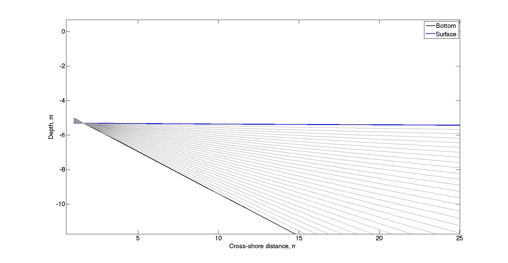

The only striking thing I can say for now is that somewhere down the line, the depth in the nearshore-most cells become inverted (pictures of the depths at the first and last time steps attached). Assuming this isn't a plotting error on my part, has something like this ever been seen?
I've also attached the run log just in case.

Yes, of course we've seen it. So, do you have some reason to expect the surface elevation to fall so much without winds or tides? I have both, so am not surprised at all in my domain. I had one run for years until a storm surge drained a bay and I had to turn on the WET_DRY flag, but you've got something else going on. I'm going to let you look at your total volume in the log file to see if it's declining in some bizarre fashion.

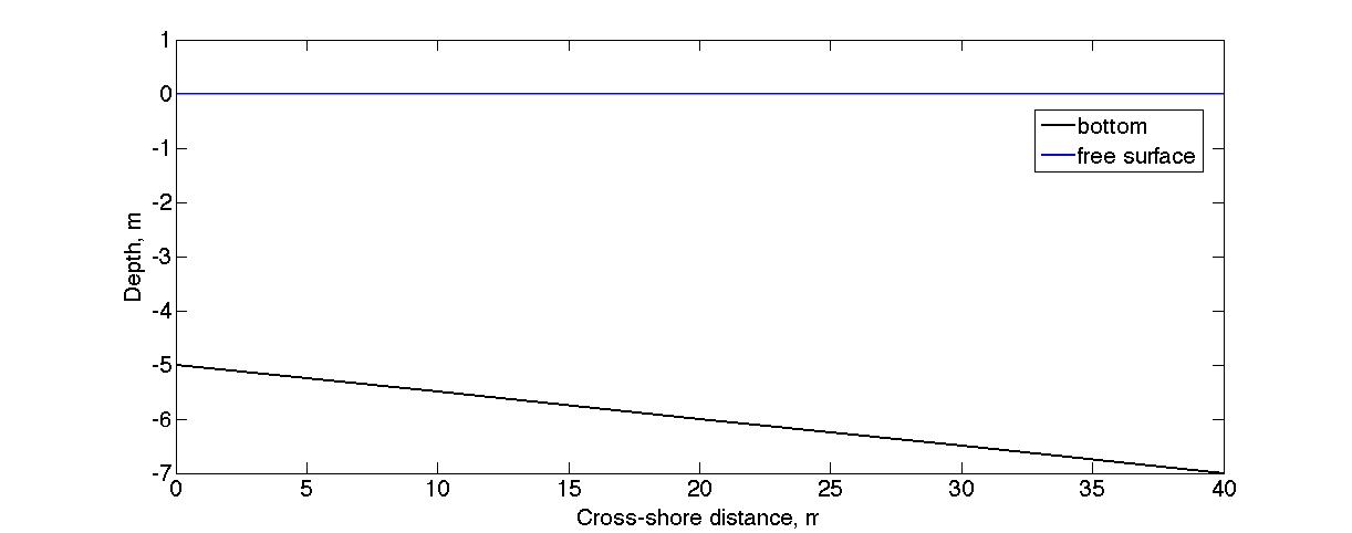

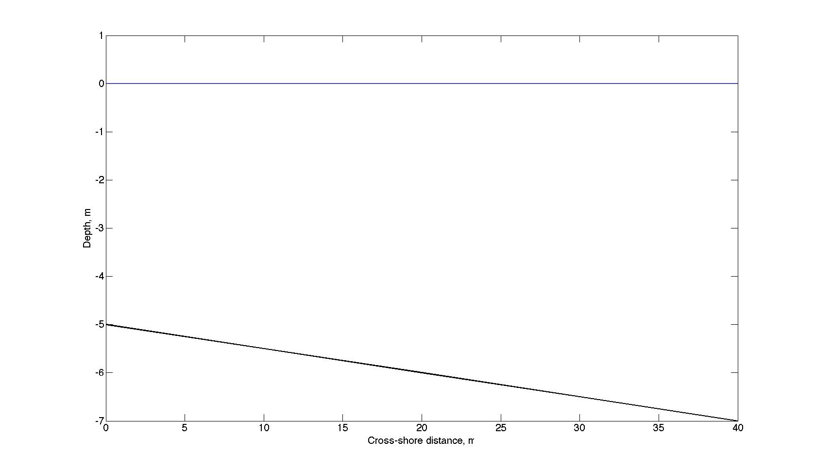

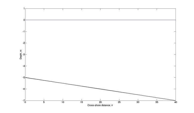

I just wanted to share that the free surface no longer appreciably drops (first and last time step transects attached), and my volume is approximately conserved (first time step volume = 6.422130E+08; last time step volume, 28 days later, = 6.422072E+08), after I changed my offshore boundary conditions to the following (previously they were all Rad):
Zeta: Cha
2D u,v: Shc
3D u,v: Rad
miking TKE & tracers: Gra;
I also had similar success with setting the 2D momentum BC's to Flather.
