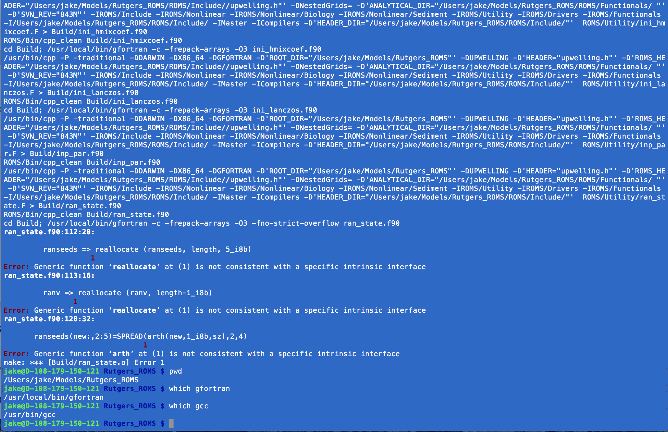

I am trying to compile ROMS (checked out today using svn) in a new Linux server with Intel Fortran Compiler and OPEN MPI and get this compilation error:
ran_state.f90(112): error #6284: There is no matching specific function for this generic function reference.   [REALLOCATE]
        ranseeds => reallocate (ranseeds, length, 5_i8b)
ran_state.f90(112): error #6678: When the target is an expression it must deliver a pointer result.   [REALLOCATE]
ran_state.f90(113): error #6284: There is no matching specific function for this generic function reference.   [REALLOCATE]
        ranv => reallocate (ranv, length-1_i8b)
ran_state.f90(113): error #6678: When the target is an expression it must deliver a pointer result.   [REALLOCATE]
ran_state.f90(128): error #6284: There is no matching specific function for this generic function reference.   [ARTH]
      ranseeds(new:,2:5)=SPREAD(arth(new,1_i8b,sz),2,4)
ran_state.f90(128): error #6283: The DIM specification is out-of-range.   [2]
ran_state.f90(128): error #6366: The shapes of the array expressions do not conform.   [RANSEEDS]
I am not sure what is the reason behind this error. When compared to an earlier version of the code the numbers in this new file have changed from "_i4b" to "i_8b". Coincidentally, a friend of mine tried to compile ROMS (checked out today using svn) in Mac with gfortran compiler and he got the same error as can be seen in the attached image. I might be doing something silly here, however, it would be great if someone else can take a quick look at this error as well.
ROMS compilation error in Mac OSX with gfortran

There was an update today, ticket 726, with changes like the following, only in ran_state:
-      integer(i4b), parameter :: hg = HUGE(1_i4b)
-      integer(i4b), parameter :: hgm = -hg
-      integer(i4b), parameter :: hgng = hgm - 1
+      integer(i8b), parameter :: hg = HUGE(1_i8b)
+      integer(i8b), parameter :: hgm = -hg
+      integer(i8b), parameter :: hgng = hgm - 1
Perhaps you can revert just that file.

Re: ran_state compilation error in ROMS
Well, mod_kinds changed what i4b means:
-        integer, parameter :: i1b= selected_int_kind(2)        !  1-byte
-        integer, parameter :: i2b= selected_int_kind(4)        !  2-byte
-        integer, parameter :: i4b= selected_int_kind(9)        !  4-byte
-        integer, parameter :: c8 = selected_real_kind(6,30)    ! 32-bit
-        integer, parameter :: r4 = selected_real_kind(6,30)    ! 32-bit
-        integer, parameter :: r8 = selected_real_kind(12,300)  ! 64-bit
+        integer, parameter :: i1b= SELECTED_INT_KIND(1)        !  8-bit
+        integer, parameter :: i2b= SELECTED_INT_KIND(2)        !  8-bit
+        integer, parameter :: i4b= SELECTED_INT_KIND(4)        ! 16-bit
+        integer, parameter :: i8b= SELECTED_INT_KIND(8)        ! 32-bit
+        integer, parameter :: c8 = SELECTED_REAL_KIND(6,30)    ! 32-bit
+        integer, parameter :: r4 = SELECTED_REAL_KIND(6,30)    ! 32-bit
+        integer, parameter :: r8 = SELECTED_REAL_KIND(12,300)  ! 64-bit
You still want a 32-bit int. Maybe try the new ran_state with i8b as selected_int_kind(9).

Weird, I compiled with ifort, gfortran, and pgi and didn't get those errors. It turns out that I missed to transfer the updated files gasdev.F, nrutil.F, and ran1.F when I committed the ticket in another computer. We need these files to have i8b instead i4b. This is the reason why you are having problems compiling because of the mismatch between integer type arguments between these routines and ran_state.F.
Please update again. Thank you reporting this problem.
